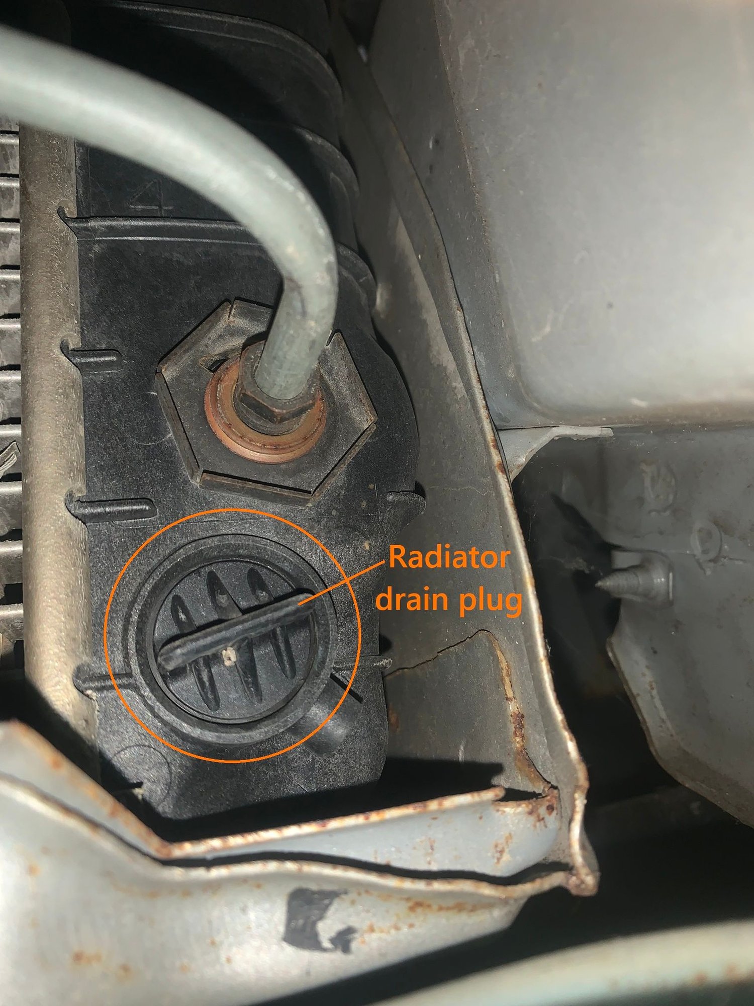

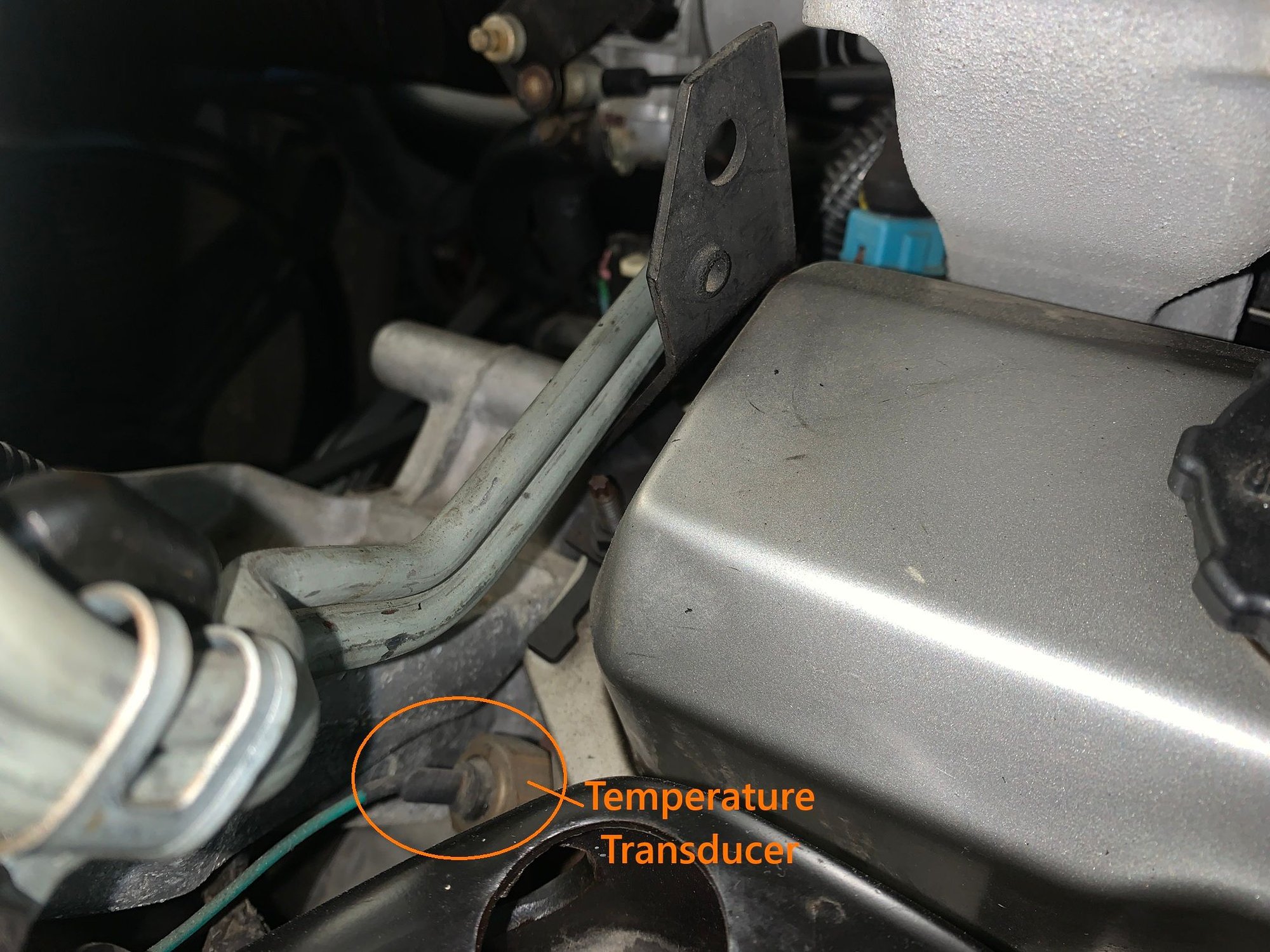

What you have installed in your engine for your tell tale light is a temperature switch, much like a light switch in your house. In your house you flip the switch and the light comes on. In you car there is a snap action thermo switch that snaps on when the engine get too hot and turns on the tell tale light on your dash.
You need to swap this temperature switch out for a temperature transducer that varies its resistance to ground depending on the motor temperature.
On my 1986 V6 this temperature transducer is located at the rear corner of the V6 motor on the passenger side. I'm guessing that is the same location that your current temperature switch is at.
These temperature transducers are available from several manufacturers under these part numbers I believe, but check for yourself to be sure. Look for the transducer for gages.
Wells
1T1041
Standard Motor Products
TS88
BWD/Niehoff
Part number WT366
Swap out the temperature switch in your engine for a temperature transducer and connect the wire from the transducer to the new gage.
You may have to drain the coolant from your engine so that you don't end up with a mess on the floor.
The radiator drain plug is at the bottom of the rad on the passenger side.
