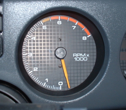

this is what my tach looks like now after i got it back from the shop who repared it after it was broken into. They totaly redid the steering column and installed an alarm, and im guessing by the wipe marks on the face of the TACH backing, they cleaned up the dash area. And while doing this they somehow broke my tack, the picture below is how it looks now, and when it starts goes to 0. and you can see wipe marks if u look closely enough at the photo where im guessing they cleaned up and messed with the needle with a rag or something..
NOw the reason the clear pastic piece that covers the guages is missing is because i had to take off the bezel infront of the guages a whlie back and broke the clear plastic piece, so i left it off and was goign to goto the junk yard and pick up another one, so all teh guage faces are exposed.
is there anyway to fix this? can i just get a new tach motor or do i need a whole new guage cluster? any clues?

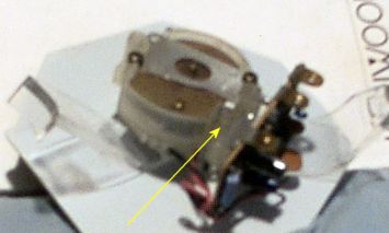

The plate that stops the tach at 0
(It's a crappy pic but what do you expect from a cheapie digi cam... better than nothing I guess

well, i can move the needle by hand to about 5500. then it stops, and i can move it about half an inch to the left of where it is now. and when idling, the highest it will goto is about 1000, when the engine is probably at about 5000.. and when regular driving the movement is really irratic, is there anyway i can test the tach? i think something eletrical is wrong.

You can remove just the tach. The 1st pic is of my tach out for the purpose of the pic & the 2nd pic I posted is the same one back in (the cluster was out because I painted all my needles white). Once the cluster is out, there are 5 phillips screws on the backside of the cluster, take them out & the tach will plop right out. Installation is reverse of removal. Note also, on the tach, it specifies what kind it is (8 cyl, 6 cyl) so if you hunt down a replacement and find one you won't have to guess what motor it's for. It's actually alot more work just getting the damm cluster out than it is replacing the gauge.
