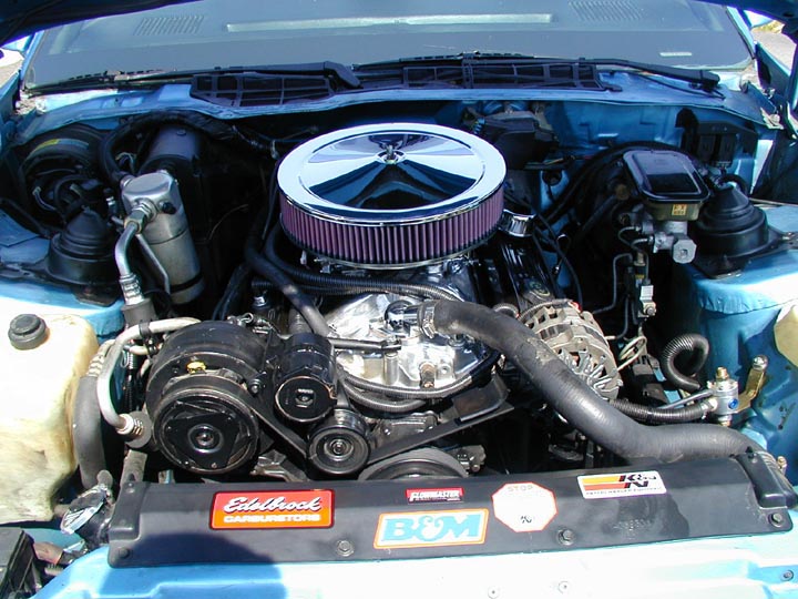

Got my car Dyno'd last night-287.8 at the rear wheels.
I don't guess that is too bad from a 350 .30 over
with 700R4 Tranny and 3.42 gear.

According to the rule of thumb- 20% drivetrain loss- that works out to 359.75 (or 360 HP).
Pretty gosh darn good if ya ask me.
What cam/heads/exhaust , etc., etc. are you running?

I am running Comp XE274-H Cam/springs/lifters
Vortec Heads From Chevy Truck-Ported/Gasket Matched With 2.02/1.60 Valves
I have Flowtech(yeah I know but money was running low) headers into 2 3/4 pipe all the way back to Flowmaster 80 series Muffler with single input/dual out.

What stall TC? I'm really curious because it looks to be VERY streetable, which is what I'm doing with my 350 build up.
I see you're running a Edelbrock carb. What model? 1407?
Thanks for the info, and good job.

I am running the TCI 2200 Stall. I also have the Edelbrock 1406
600CFM Carb. It works very good. I used the factory fuel pump and mallory regulator with 5 psi fuel to the carb. I went to the 50,000 volt distributor and could really tell the difference in idle. Mine idles around 900 rpm and the whole car shakes. It is really cool at night you can see the headlights bouncing side to side and all you hear is the cam hitting. Really a hit at Sonic drive in night.
