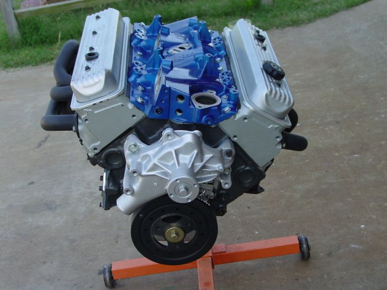

Finally got the Accel intake on...... waitin' on header bolts....

Nice job. That stealth ram and intake will make that thing rock. Too bad those heads will be holding you back. Post pics and driving inmpressions when you get it running.
