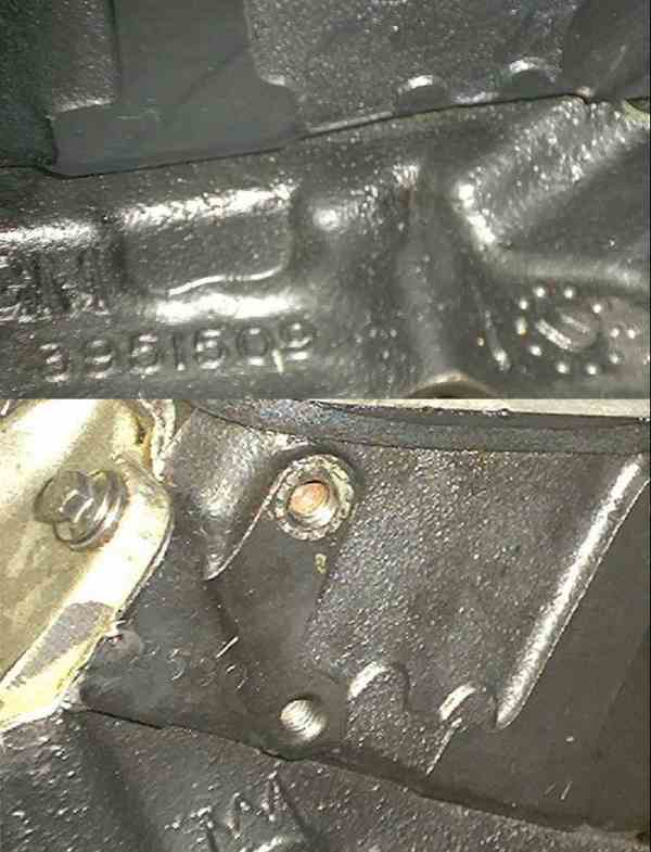

If you want good double-hump heads, the ones to get are the 186, 041, or 492 castings.
Here's a set of 186s:
Attached Thumbnails Got a set of double hump heads. Need opinions...-head-casting-both-ends.jpg
