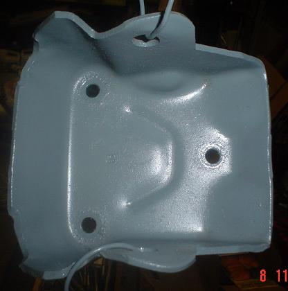

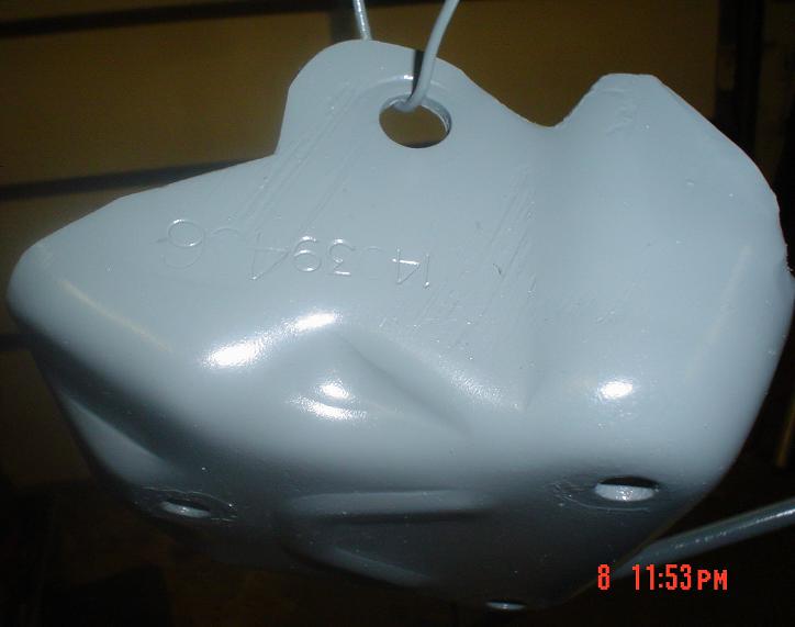

Alright, here's what I got:
14039486 and 334971
It looks almost like one of these may be aftermarket, or at the very least more recent GM parts. One of them had all kinds of scale and rust buildup, one was nearly perfect. Unless it had a nasty oil leak for most of it's life on just the one mount.
I won't know where each one goes until I pull the old motor out of the car, which won't be for a couple days.

From driver's seat, or from the front of the car? Any idea why those part numbers are so different?
Attached Thumbnails does it matter which side of the engine the motor mounts brackets go on-mount1.jpg

Dirk got the attachment thing all fixed
Attached Thumbnails does it matter which side of the engine the motor mounts brackets go on-mount2.jpg

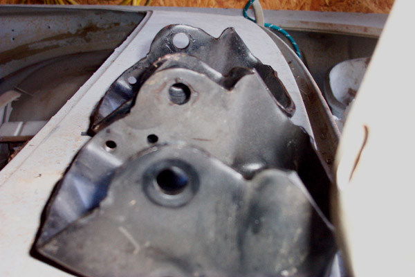

Actually, the through-bolt holes are in different locations on the two. The right-hand mount has the holes closer to the block and lower.

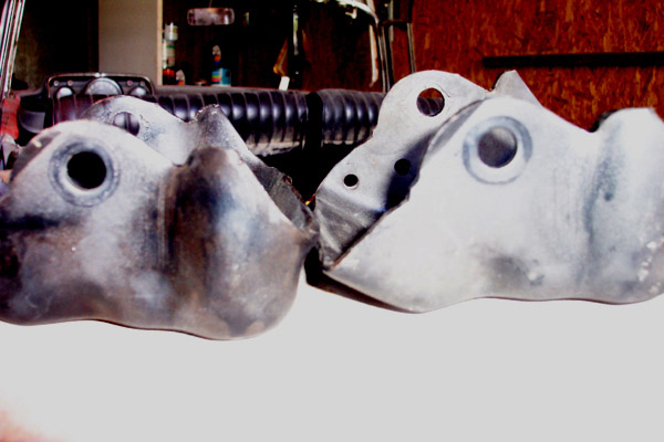

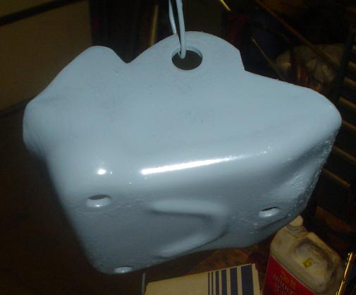

Here's some closeups of the ears:
Attached Thumbnails does it matter which side of the engine the motor mounts brackets go on-mnt1.jpg

Attached Thumbnails does it matter which side of the engine the motor mounts brackets go on-mnt2.jpg

You can see the difference in the hole locations pretty clearly in those pictures.

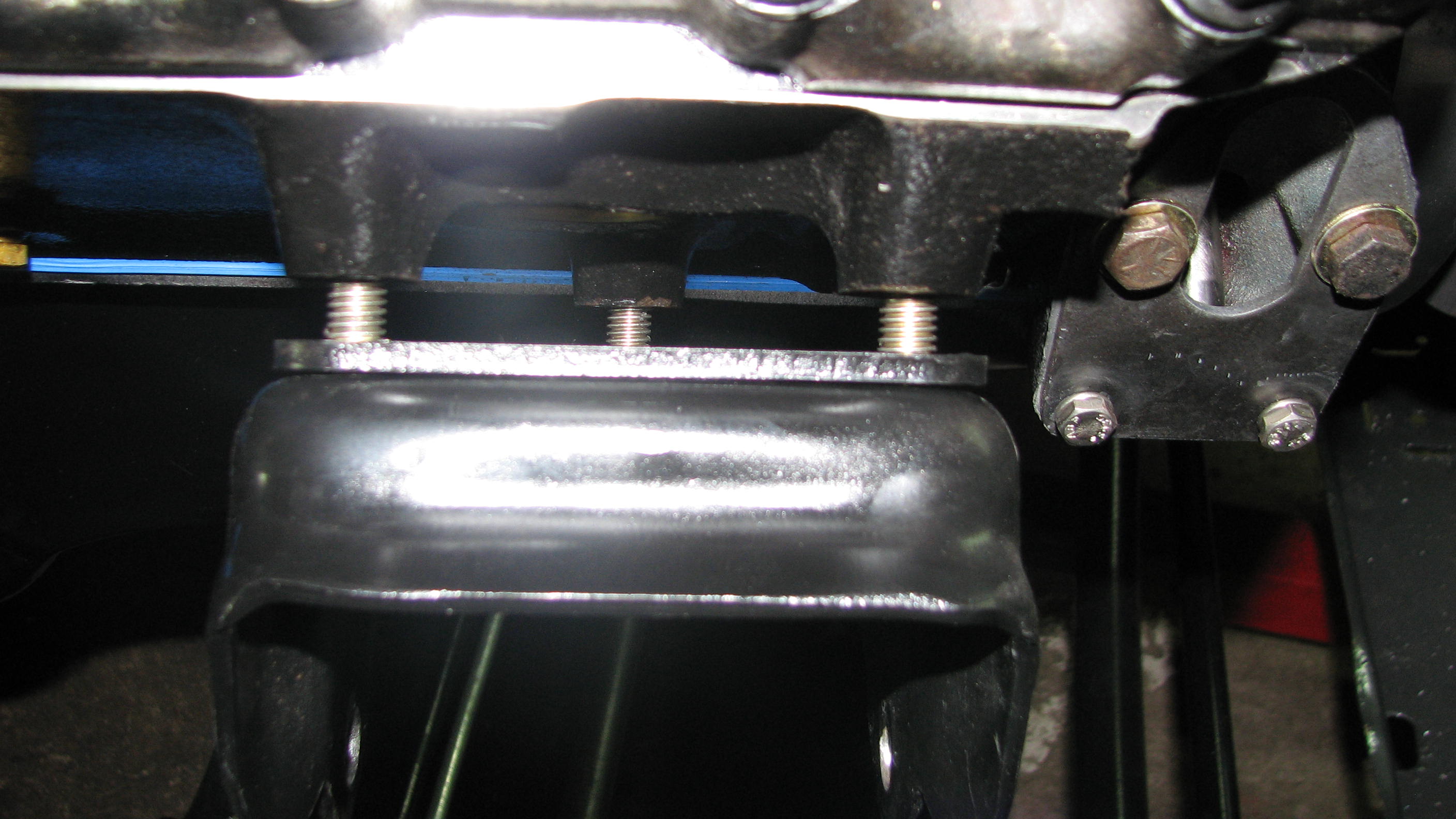

Finally found camera, mount brackets look the same to me Going to test fit it tommorow to make sure before I get any farther.
Attached Thumbnails does it matter which side of the engine the motor mounts brackets go on-sidebyside-copy.jpg

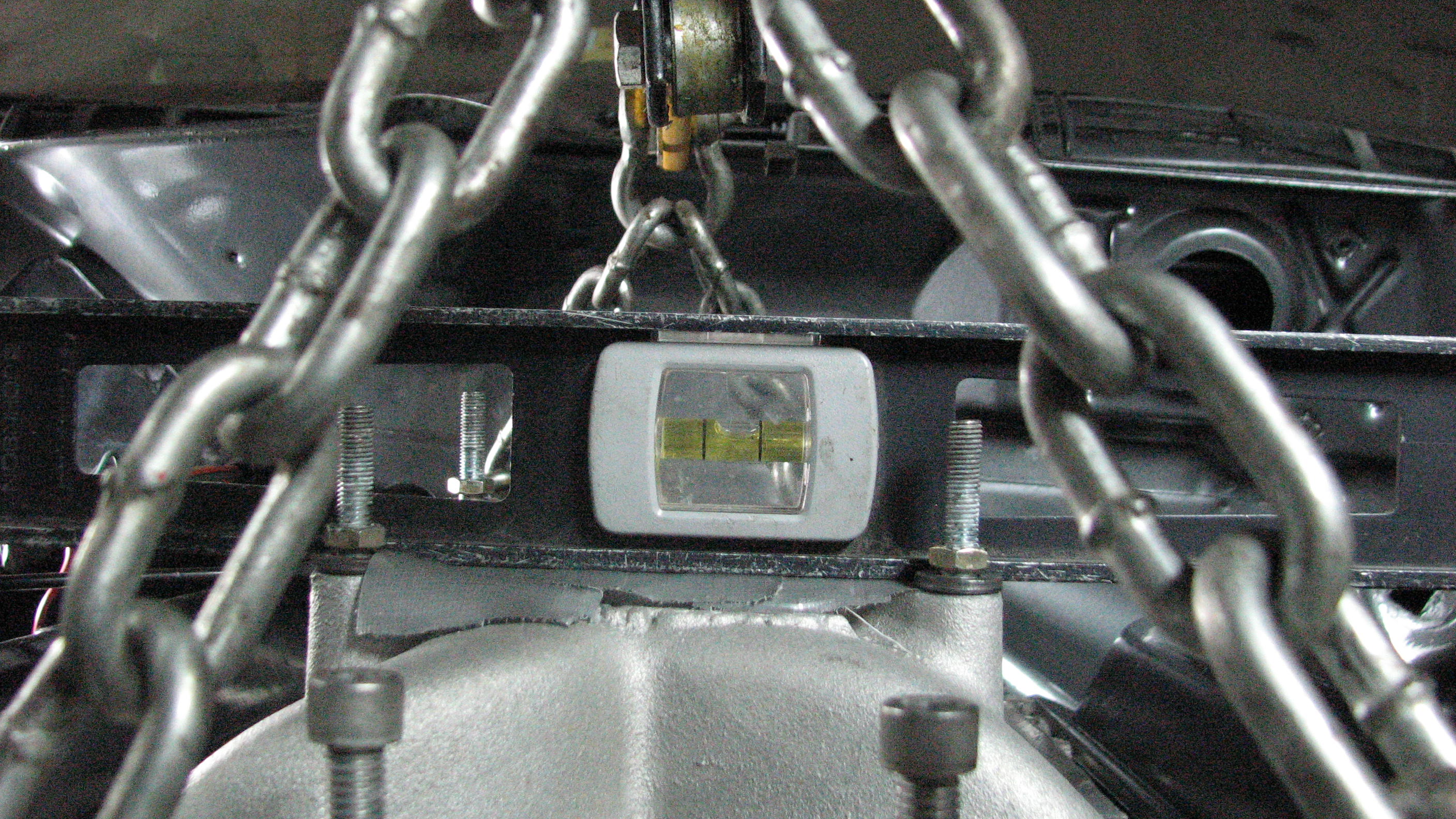

One more
Attached Thumbnails does it matter which side of the engine the motor mounts brackets go on-frontback-copy.jpg

only reason i ask , is the car is converted to right hand drive and having clearence issues with extractors to steering shaft

Something I see that no one has mentioned is the 3/16" spacer that's designed to go between the mount and the block.
After the first couple of go rounds installing different engines, I had always noticed the the drivers side valve cover was higher than the passenger side. A level across the carb pad on the intake shows the amount that's it's off.
I found this spacer in my pile of parts and with it's installation in the passenger side, the engine sits perfectly level.
All OEM parts.
The first pic is the with the engine sitting in the mounts without the spacer, the 2nd pic shows the spacer position between the mount and the block.
Result, level.
It also made a difference with the header installation. Before the spacer there was contact with the cross member and the frame. After the spacer was installed, lots of clearence.
Attached Thumbnails does it matter which side of the engine the motor mounts brackets go on-img_5171.jpg   does it matter which side of the engine the motor mounts brackets go on-img_5172.jpg
