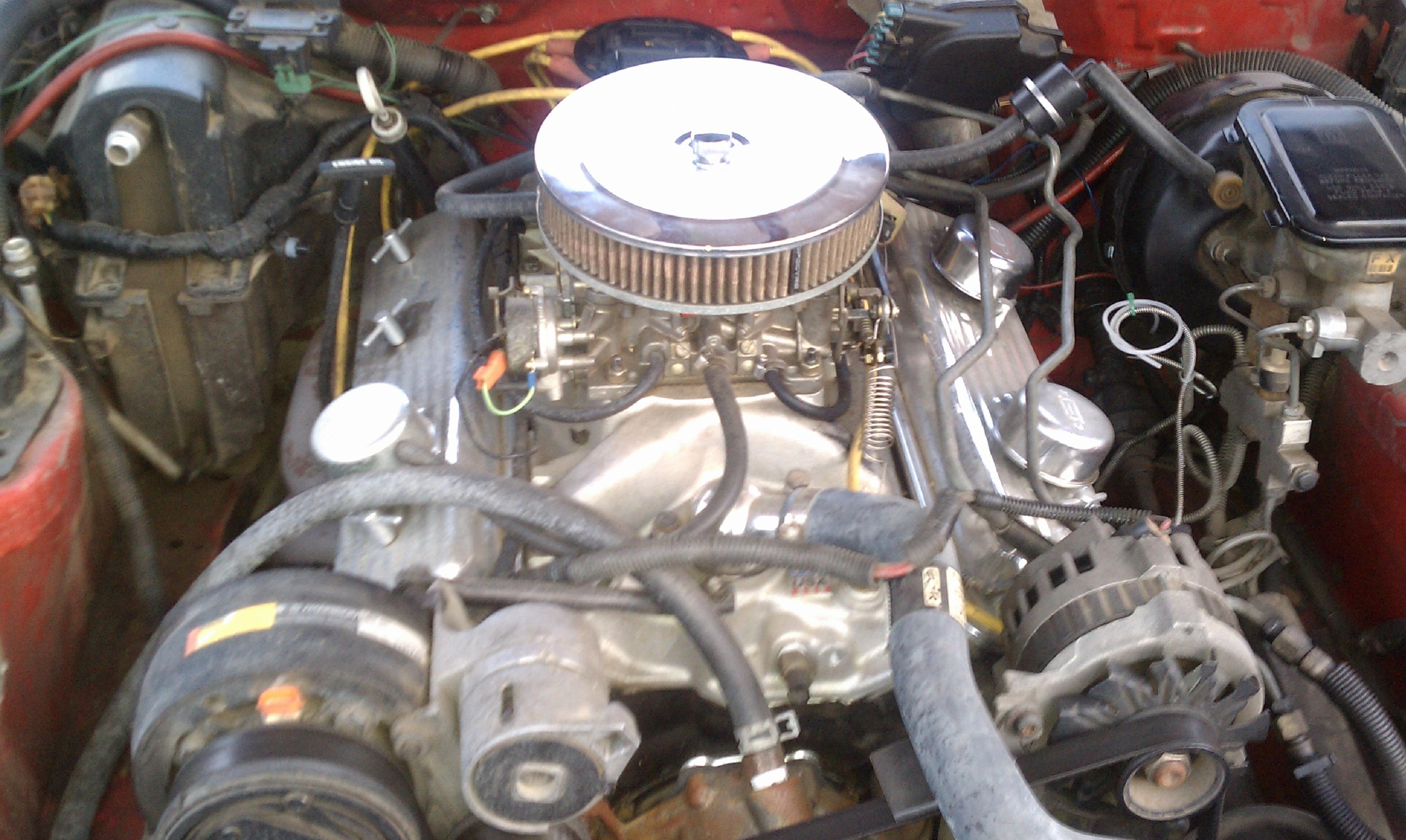

This is the missing connector.
Where the reservoir should be mounted.
And a engine shot, just for kicks.

that missing connector is just for a/c thats the compressor plug it in it will circulate the gas from the condenser (which is missing) through the coils for the a/c cooler which is behind your radiator and through your vent you could take that whole thing out to make it cleaner and put a metal plate over the hole and get and a/c delete pully for the a/c compressor so you wont have as much drag on the motor..p.s nice engine looks good(Y)

It is my understanding that the ECM controls the charcoal/purge canister. It sporadically opens the valve and lets the throttle body get rid of the excess vapors. Without the fuel injection system there, what is the ECM realistically going to be doing with it? Even the factory carb cars had ECM's controlling things.
I would have run a hose down to where the canister was to make sure it vents at the bottom of the fender, gutted the TPI harness and removed the ECM properly, and set up a TCC lockup switch.
I bet that fourth gen rear looks awful, are the tires sticking out like 2 inches on both sides? If so just get a 3rd gen rear. the 4th gen rears have better brakes and a lot of times they swap them because the gears are better and they ahve posi carriers. You can swap this over to a thirdgen rear if you like if its 89+.
I also removed my windshield washer fluid resevoir. I never use it, it's pointless. It was a great spot to install a fuel pressure regulator, so that's where it went. On the other hand, my windshield wipers still work. I actually need those.
If you removed the ECM and its harness, and the A/C junk that's left over you could clean up the engine bay a lot and it would look a whole lot better.
Also, from what he told you about the engine, it should be pretty stout. It's a very popular, good combo right there. If its healthy it has the potential to go low 13s if its set up right. that means good tuning, good gears, good suspension, good exhaust, etc.
Also, some of those A/C plugs wrap around themselves and go in circles in teh engine bay. When I was taking mine out of the car I was really surprised to see all the wires just endlessly looping around themselves down in there. There'd be 2 feet of loom to go 6 inches. I think it's to make sure they were able to tuck it out of the way and it look nice from the factory.

Yea the rear end does stick out a little, but thats on the bottom of my list of things to worry about, as long as that hold up it will be there for a couple of paychecks.
And what your saying about the A/C plugs is im just going to have to track it down. Do you have an idea where it starts at? Might help me find it a little easier.
Your engine bay looks clean, did you put a false pulley where the A/C compressor use to be?
The washer reservior being gone, ive noticed how bad the coolant tank looks & how much room they take up. So i found a cool thread that shows a way to hid them in small homemade plastic tubing that can be hidden infront of the radiator.
This is a new issue now:
When accelerating if i hit the trottle then let off... slow down a little then try to get back up to speed it hicups. I really doubt its good for fuel eco. and its pretty annoying. Any ideas?
And when looking for a a/c plug i noticed there was a hose that was cut off on the front of the engine block. pointing toward the radiator. Ill have pictures up tommorow.

I'm not sure what you are talking about that would lead from my carb to the transmission. Was looking around and saw nothing that your describing 3rdGenFamily, but I will take pictures tomorrow. (Didnt read this before i took these new ones)
Do you think I would be better off with a 650 then a 750?
And no it doesnt smoke.(Edit: Does smoke when idle jumps upon starting, doesnt happen all the time).well not bad enough for me to see it from the inside of the car. (My old 89 Firebird Formula would make a cloud of white smoke that carried which ever way the wind blew)
IMPORTANT! Upon starting my car though, my car was stuck idling close to 2000... Car practically was driving itself if i took my foot off the brake would cruise at 30-35mph... I sat there for about 10min to try and let it lower but it didnt. Has done this 3 times now, and it worries me when driving it around after this happens.
Also, i found the wires for my a/c and other things pushed back against the firewall..But question is idk which ones go where. In the picture there are 3 connectors, all about the same. They are Black (w blue), Green, and a Off-white. I know one goes to my A/C and the I do believe one goes into the front of my engine block (Also in Picture)
And looked over at my Charcoal canister and there was yet another plug that wasnt pluged into anything, and I looked around the area and saw nothing to stick in into...This picture wasnt that good, but its the blue & red wire that is just sitting ontop of the canister.
Attached Thumbnails Engine Swap Done..now what-imag0108.jpg   Engine Swap Done..now what-imag0109.jpg   Engine Swap Done..now what-imag0104.jpg
