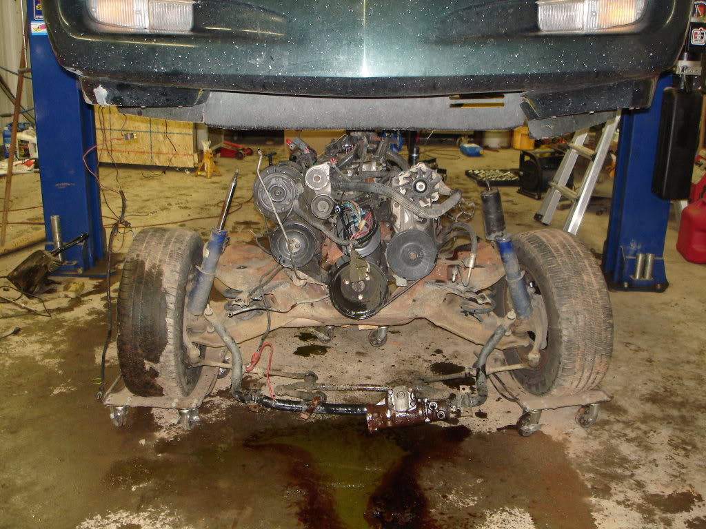

Done it both ways and will NEVER pull one from the top in a 3rd gen again
If you're familiar with removing an engine, out the bottom should be doable in less than 4 hours
No, you dont have to mess with springs, or even take the wheels off unless you just want to. Personally, I find it easier to leave them on to aid in rolling it out from under the car
Re: K Memeber, Engine, & Trans Removal
Thanks for all the replies guys, I am pretty dead set that this is going to come out the bottom, I think it will be a lil quicker seeing I need the trans out as well. I could do it either way, I have a nice trans jack for the lift and my cherry picker would get the job done but seems like it would be easier to just drop it all on the ground.....
Pocket, Thanks for the pics..... I intend on dropping it out this weekend, I will take some pics along the way.... The LSx looks great btw, maybe one of these days but for now I will have to make do with a carbed 383!!
