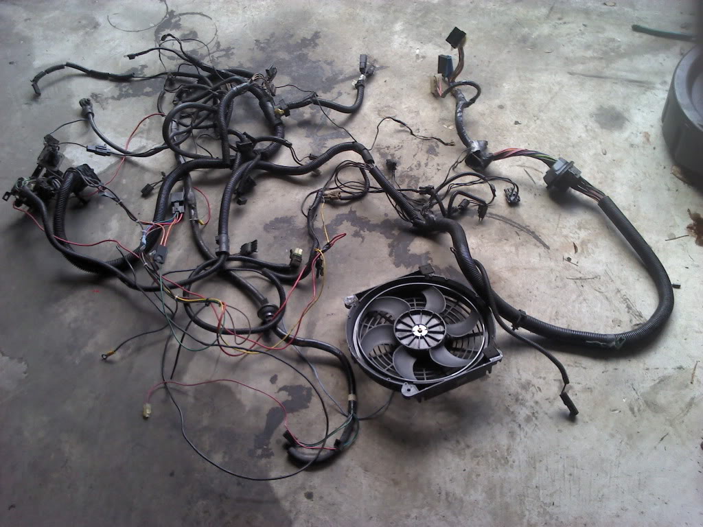

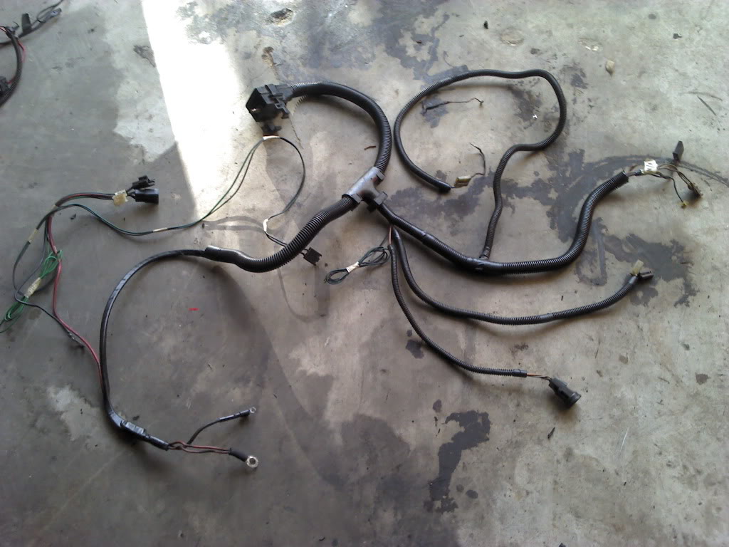

The wiring for the lights/horn, etc.. are a seperate plug from engine controls, and seperate from ECM wiring. The C100 (Plug by the brake booster) is actually in two pieces and will come off with a 1/4" socket down the center. I thinned out my wiring harness for my t/a, and just left all the lighting harness still ran/hooked up and didnt have to touch it.
I went from this:

To this:

On mine, I decided to keep all AC wiring in-tact because I plan on keeping it, and I am also not running a wire for TCC, so it isnt there either. Run it how you want it, and you'll be fine.
