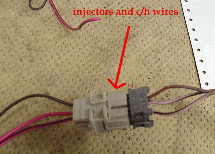

yea i got the harness from the 1990 camaro so all i have to do is repin the harness? the problem is that under the dash on the passenger side there are the injector wires running from the fuse box to a plug that is close to the ecm. i need to figure out where i can splice those wires into the harness so the power can get the injectors.
this is a picture of the plug that the wires from the fuse box run to.

if you use the 90s computer it will all just plug in without issue. to use the 90s harness with the 89s computer youll have to change pins around on the harness plugs. all those plugs are for is power for the injectors. the 2 pink wires are the switched 12v for the left and right banks and the black is the ground. you can run them to really any spot that has a fused switch 12v source.

the engine harness should be seperate from the dash harness. if youre using the 89 computer VATS wont be an issue, if you use the 90s computer youll have to either get a VATS bypass box or have it tuned out. the injector wires there just need a fused switched 12v source, since i dont think on the 89 they had a spot on the fuse panel for the injectors. someone with more experince on swapping harnesses between years will probably chime in.
