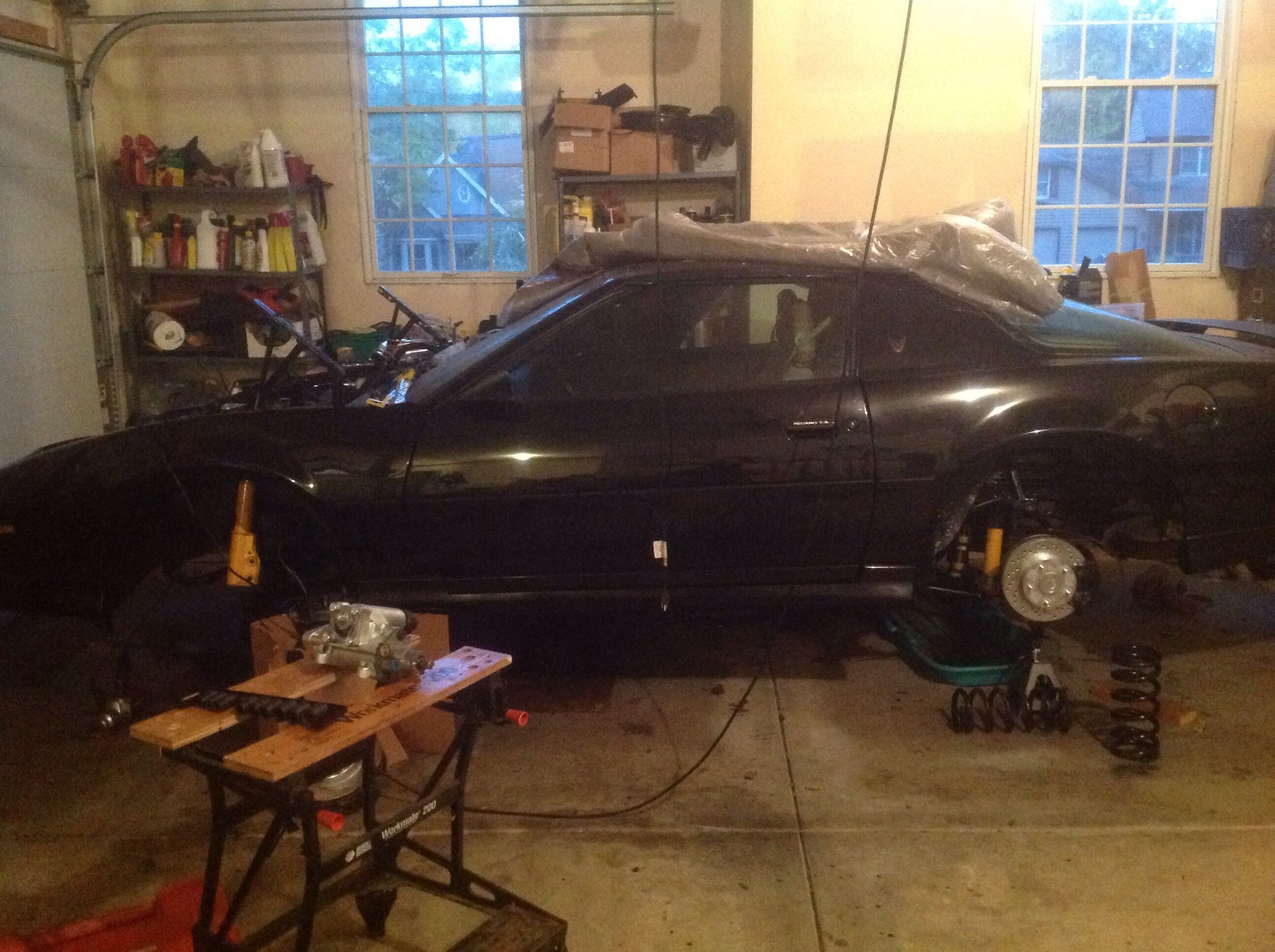

Well after some failed attempts to actually swap the motor, all I need to do is undo the bellhousing bolts then this L69 is outta here...
then.......
