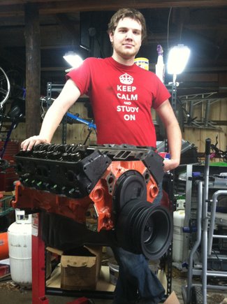

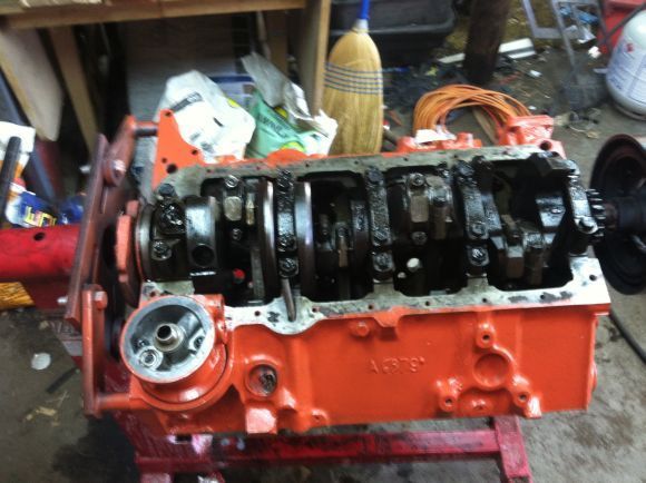

For Christmas my parents decided to help me get an old junked engine. After about a week I found a '79 350 that was listed on Craigslist for $100. It took me two hours to get up to it in the freezing winter, but I got it! The block number is 14016379.
It has just about everything attached to it, V belt assembly, Carb, it even had the exhaust on it! The only thing missing was the starter and the flexplate.
This small block is going into my 1992 Firebird. The car right now is my daily driver, I even drove it to work this morning after the foot of snow here in Iowa. It's a 3.1 Auto....drastically slow car, but it was cheap and good looking. I just cleaned up and painted the interior and it looks great for a twenty three year old car.
My goal is to do this swap by pulling parts from junkyards, craigslist, and cleaning and repurposing the parts I already have. This is my spare change project as I am returning to college this semester after suffering two strokes and being force to drop out last semester.
I've only rebuilt one motor before this one and that was an LT1 engine in my semester of recovery. It just had a blown head gasket and some previous owner caused problems. I'm excited to jump into my first real engine swap, so comments, questions or ideas are welcome!
I attached some pictures of what I'm working with so please take a look!
I'm going to tear it apart in the next weekend and see what condition the innards are in.
Attached Thumbnails Junkyard Power Swap - 350 into 92 V6-image-2.jpeg   Junkyard Power Swap - 350 into 92 V6-image-5-.jpeg   Junkyard Power Swap - 350 into 92 V6-image-1-.jpeg

Good news is, from the casting # you gave, it's a 350.
If you haven't read the V6 to V8 swap sticky in the top section of this forum, you should do that first.
What are your goals for the project? You mentioned it's your daily driver, do you have something to use while the car is down?
Bad new is, not much of what is attached to the V6 will work on a V8. You're in for a lot of JY diving, and some things have to be from an f-body. Again, read the sticky.
Personally, I'd consider the heads, intake, and exhaust on that engine to be door stops (or bass boat anchors, if you're into that). At the JY, look for '96-'00 light truck 350 heads (forget the rest, just get the heads). Those are known as "Vortec" heads, and you should look for casting number 062 or 906 (last 3 digits) - those are the "good" factory 350 heads (the best the factory ever made). They will require a different intake manifold, but Edelbrock makes one that will work with that carb.
About the only exhaust manifolds that will work are f-body, and most of them aren't very good. Have you considered headers?

That's a 79-86 block you have. You can not use the factory style roller cam/lifters in it. You would need a 1pc rear main seal 1987 up block for that.
Your block does not have the stand offs for the lifter retainers, nor has the lifter bosses been milled, nor does it have a place to bolt the thrust plate.
You are stuck with flat tappet or high dollar retro fit roller.
But that's ok, flat tappet is not a major down fall. You can still get really good power out of them.

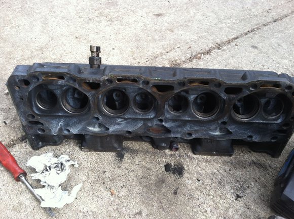

Well, that was a long weekend.
Everything on the engine looks pretty good...other than the inch of mud and
grime that's baked on to it. Pistons are fairly carbon stained, but I was able
to get allot of it off with some soft rags. I'll get the rest of it when I pull the
pistons
If I had a crank hub puller on me, I would have pulled that off today and start messing with the cam, but a broken bolt prevented me from getting it off.
Interestingly enough the bolt wasn't rusted to the head, it was rusted to the
exhaust. I could spin the bolt by rotating the exhaust, but I just couldn't get enough clearance to spin it in a 360. So out came the drill. Once I beat the
exhaust off of the head, I just grabbed the destroyed bolt and turned it free
by hand. No gaskets on either manifold
I find comfort in the fact that fresh oil and antifreeze came out of this engine
when I turned it upside down to take off the oil pan. It makes me feel like it
might work again. I might have to slow down on the build because I'm back
in school, but hopefully I still have some time to work on it.

It's been a wild two weeks for work on the engine.
First I thought I would introduce the Firebird to her new heart...she wasn't happy with it.
So we've all heard the rumor about using oven cleaner as an engine degreaser. And as I've said previously I'm all about the cheap and effective solution, So I got two cans and sprayed the hell out of it.
Man that stuff stinks, but It is incredible. I sprayed it and let it soak for 15 minutes and the grime just came right off. I then experimented and let it sit in the oven cleaner for a night to see if I could get all of the muck off.
It actually was less effective the longer it soaked. It may have something to do with how it moistens the goo.
But anyway here was the end result on the dirtiest side.
After getting plenty of chemical burns from the oven cleaner. I decided it was time to pull the cam out. It was surprisingly easy, but make sure to take off the fuel pump first or you're gonna have a bad time.
After removing all of the weight I could, it was time to start making this engine pu'rdy. So it went back in the truck. It's always fun trying to wrestle a block into a truck without a hoist...but I saved a lot of money
And off to the self car wash it went! Just had to make sure and spend half of my time drying it off so it didn't decide to change colors on its own. After it was dry I sprayed it down heavily with white grease. I only ended up with a couple of spots of flash rust on the block, and I quickly took that off with some sandpaper.

After the paint dried. It was time to pull the pistons, which is also really easy. I needed some more power to get some of them broken free so I got out my handy-dandy $5 "breaker bar".
That made things easier since the block was so clean I was able to push the pistons out by hand once I got the journals to let go. And now...
TIME TO RERING!

I love seeing these very low budget builds. It takes me back to a much happier and simple time when I was a teen just throwing something together that ran and made more power than stock. I kinda miss those days. Thank you for posting those pictures.
Good job man, you are making good progress on it. I must say though I think this is the 1st time I have seen one fully cleaned and painted before tearing it down.
We always used oven cleaner on the outside of full engine to get most of the real bad gunk off.. Then fully took it apart, removed all parts, then cleaned block and heads better, took the block, oil pan, heads, timing cover, etc to the car wash. Then once we got it back home bottle brush cleaned all holes, painted and lubed cylinder walls.
Quick question and tip maybe..
Did you mark the rods and main caps? If not re-sizing rod big ends, and aline honing mains then the rods and mains must go back in where they came out of.
I use a steel stamp set to mark rod beam and rod cap so they don't get mixed up, and to mark the main caps.

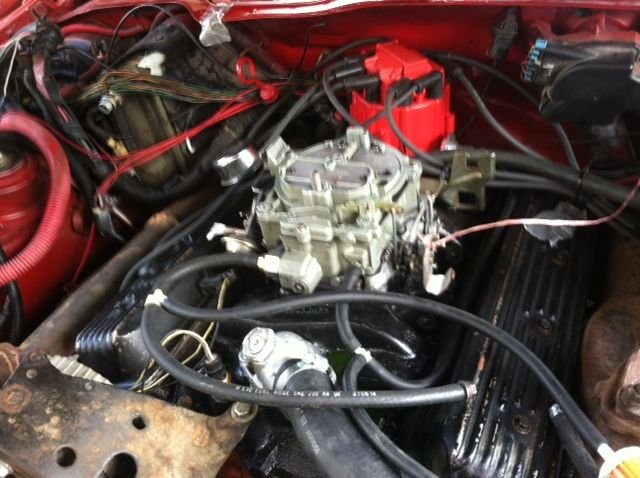

I got that carb bolted on and she fired right up! I squealed like a little girl when it kicked over.
After eight months of work, this new engine starts and runs when I turn the key!
I still have not driven it, because I've found a few little things that I need to fix. My transmission lines didn't line up at all,
so a bought some braided ones and bolted them on. The starter has been weird and I finally tracked it down to the starter enable wire with a cut in it.
I'll get to wiring the alternator and the power steering up.
It looks like I might have some hood clearance with the summit intake and carb...but I haven't tested with the air cleaner yet.

After that it became a cleaning game. Similar to the engine, I covered the K-member in oven cleaner and walked away. I came back two hours later with a hose and it was pretty much clean.
Then we lifted the 350 up off the stand and started bolting the flywheel and starter along with other difficult accessories.
After that it was time to bolt the transmission onto the engine.
