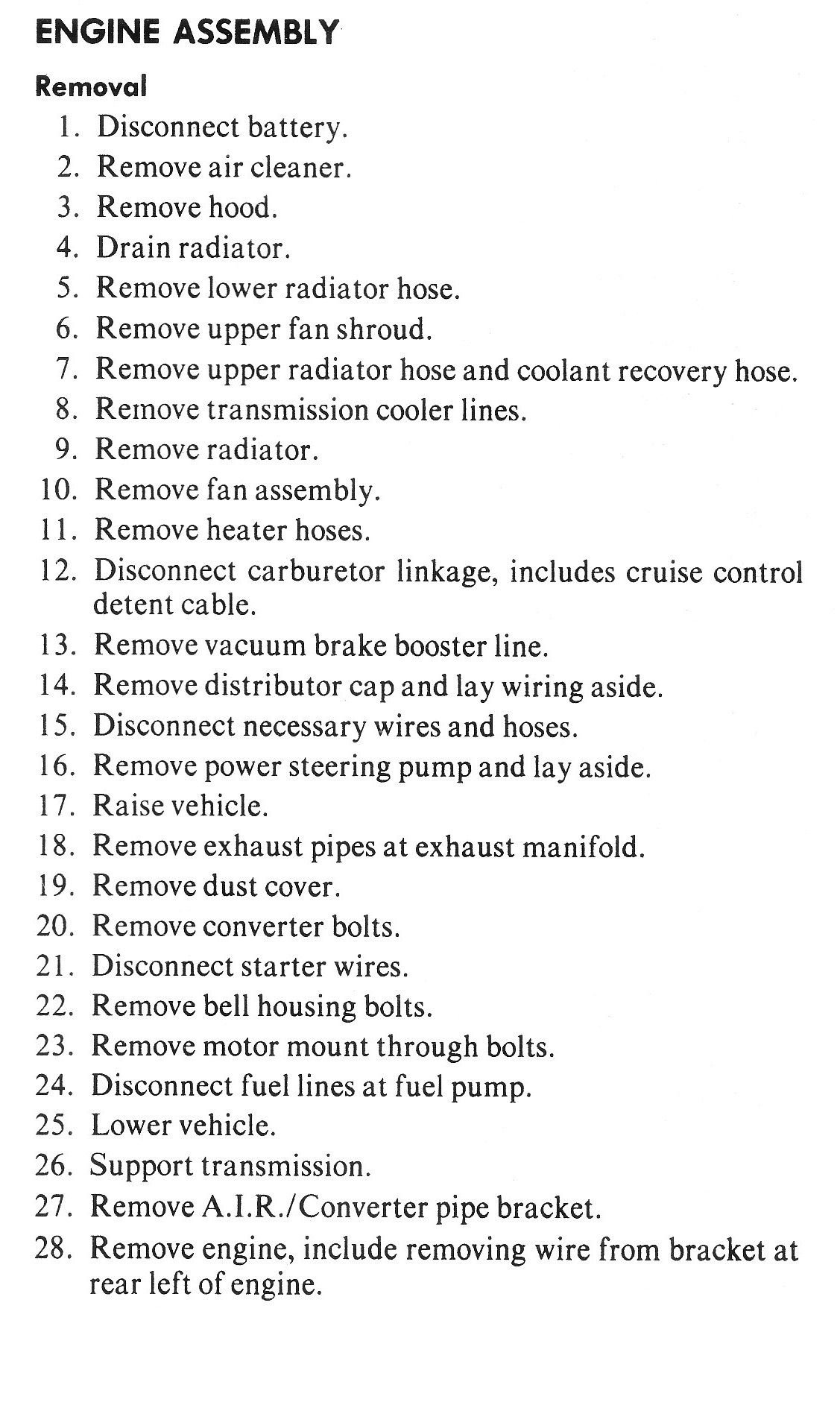

From My 1984 Shop Manual,Should Be Pretty Much The Same For Later Years.

I always start with the torque converter to flex plate bolts, since it is easier to bump the engine around with the starter to get access.

Just did this last weekend, just the removal part. Still working on the motor. This is out of a '91 Firebird service manual, but is for the 3.1 V6 VIN "T". Look at Engine Assembly - Removal on first page. Continues on second page, best I could get it with scanner I got. I did have to remove the front bumper cover and metal bumper to get the hoist in there proper. Going to put it back in this Sunday. Good luck.
