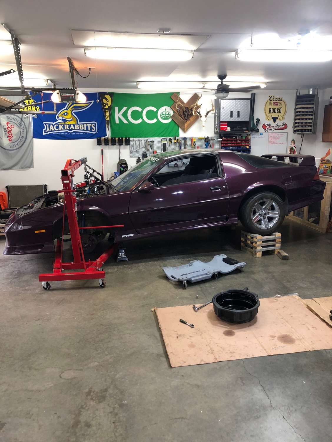

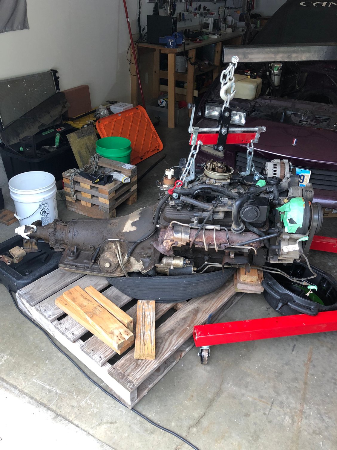

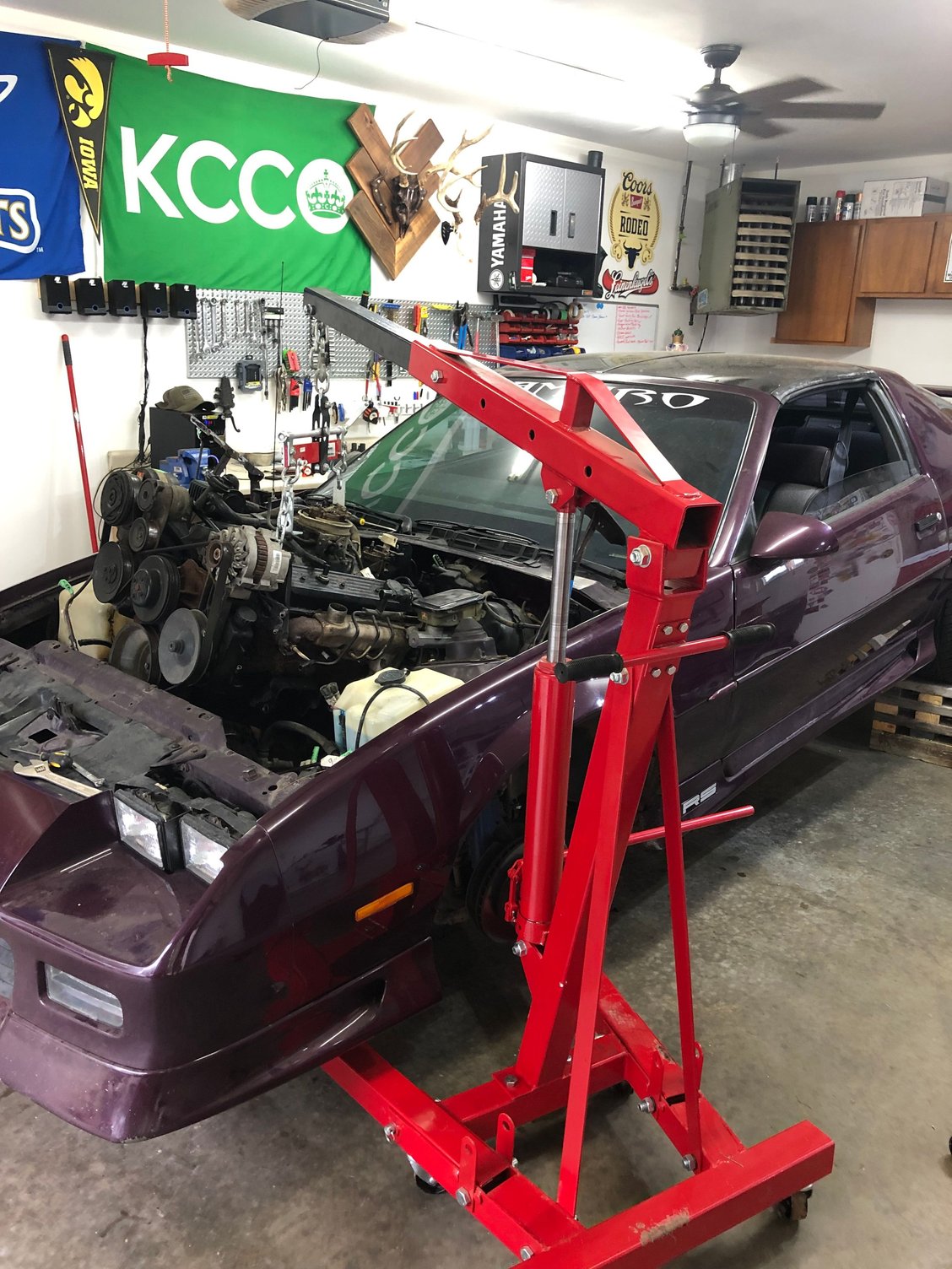

Update about 3 months later from start.....Taking things pretty slow and methodical just learning the ins and outs of everything! I pulled both wiring harnesses from the third gen and fourth gen and sent them off to Hawks for rework along with the computer for a flash/tune. A bit more expensive than I would have liked compare to a standalone harness, but got things back quickly and the whole thing seems to be pretty high quality. In hindsight, wiring harness removal would have been waaaaaaaay easier if I pulled both engines and trannys first. Some connections that are a PITA in tight areas! Exhaust was cut out and drive shaft removed. Removed original radiator and tried to clean it up. Was pretty packed with a lot of plant material and rocks......Not sure how to get those rocks clear, but will try some pressure washing carefully. If I'm not confident in it I will likely utilize the 4th gen radiator and fans if those look cleaner.
Engine and tranny is out of the thirdgen! Removed the hood, Jacked up the rearend about 18 inches on blocks, had to use a couple jack stands up a tad right behind the front wheels(Which kind of sketched me out as I was scared of it shifting forward) and take the front drivers wheel off to clear the cherry picker arm. Having the back end up allowed for a pretty smooth angle coming out. Worked a lot better than expected! Plan is to drop engine and tranny from the '99 out the bottom and pick the car up after I address fuel tank, rearend, and Ebrake cables first
