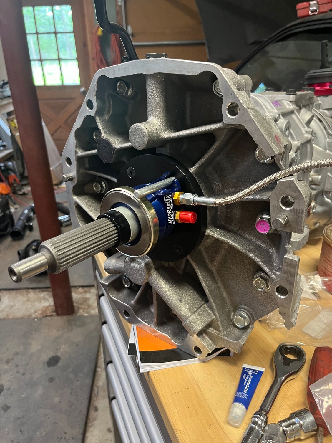

I have an 82 that had a t5 and a SBC. I swapped a magnum f close ratio. I used a spohn crossmember. You can use an American powertrain setup for the hydros. I used one and it's great. The clutch action was great w my dual disk. I used the hd yoke w 1350 u joints and a 3.5 in aluminum shaft going to my moser 9. It's all pretty bolt in. My shifter is pretty perfect.
this is a pic of the tkx setup. The t56 one is similar.

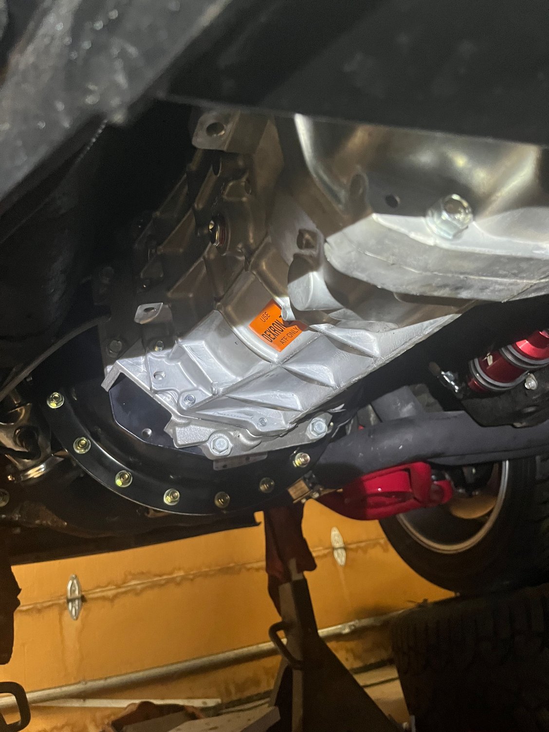

Here's where my shifter ended up

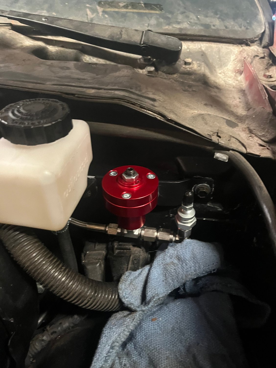

@Firechicken82 What is your Clutch Hydraulics setup in the above Image?

The left of the pic is the clutch fluid reservoir, the red thing is the pedal height adjuster from ram clutch. It's a fluid accumulator basically. When I installed the dual disk the clutch engaged at the very top of the pedal throw. This allows me to dial in the pedal throw. It also prevents over travel of the release bearing. The last item on the RT is the hydraulic speed bleeder. With this bleeding the clutch is easy to do fast and alone. It's as simple as sitting in the seat and pumping the pedal till clear fluid and no bubbles come out.
I agree, the magnum f is the move, I wish there were more bell housings available to mount it to a SBC though. My quick time bell is really solid but hangs a little low. I couldn't find anything smaller. There was a cast aluminum SBC/BOP dual drilled bells but it was pretty bulky around the engine/bell interface area. My car is kind of low and the low bell exaggerates it.
