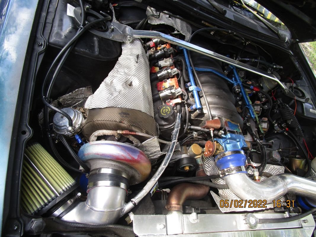

My LS swap is running 34psi baseline fuel pressure
22psi of boost 610rwhp dynojet that is 54psi of fuel pressure in boost and (34 - 7) = ~27psi of running fuel pressure in vacuum
Low fuel pressure enables large injectors with much longer idle pulses , which drastically improves tuneability for low speed and engine smoothness when using huge injectors
This is a tuning secret. Nothing to see here nevermind
