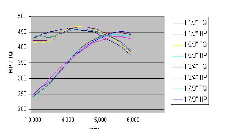

Originally posted by unknown_host
I don't remember, it was within the last year I would say. It was either Car Craft or CHP but I am pretty sure it was Car Craft. They also compared 1 5/8 to 1 3/4 to 1 7/8 if I remember correctly.
Originally posted by Trevor Jacek
Here is the article: http://www.chevyhiperformance.com/te...der/index.html
I also made up a graph, but it didn't show the differences as much as I wanted. The test engine was a 450hp Smeding 383.

This was in no way a thorough test, they just slapped the headers on and ran them, and cannot explain their results. If you read the story, their results totally disagree with what the writer of the story tells you about header design parameters. That should have sent up a red flag right away.
Every engine package will reach a harmonic (it's called tuning) in a certain RPM range. Tune everything to a certain RPM range for max power, tune everything to a strategic mismatch for a better power spread. Just throw parts at it and learn only what that particular setup responds to. By giving no detailed info on exactly what the engine combo is or what it is tuned for, this article is worthless for anything but THAT PARTICULAR COMBO. Even worse than that, now we have newbies running around telling more newbies that shorties make more power than long tubes. But they got the important info right, they do tell you how much power the engine makes, how much it is and where to BUY it. (go boy, go fetch!!)
This engine system has some odd tuning to it, but we don't know what or why, and they provide NO INFORMATION nor did they TRY ANY ADJUSTMENTS to the standard variables, such as fuel curve, carb size, manifold type, ignition timing, cam size, cam timing, or anything of any relevance for that matter. Even the most experienced engine builder needs to test different combinations to find packages that work best together, if everything on an engine was simple and easy to predict, we would not need dynos. Since we know nothing about the package, and did zero experimentation to figure out what was causing the strange results, the results are not valid for anything but that particular package, which we know nothing about.
