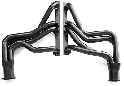

ok i am really confused on heddman LT headers nowadays
ok im trying to search to find my answers bt its not really working out and plus the newer info that i need doesnt seemto be in any of the more recent posts that are up
the ball and socket flange issue
whats the deal with them going from 3 bolt flanges over to ball and socket crap
what heddman headers meet this criteria currently at this time
LT
painted
no air tube or sensor holes
sbc engines
82-92 F body
3 bolt flange
will clear stock large delco starter
help ???
everytime i go on summit and find a set of headers that look great and sound good the damn things are ball and socket crap
its pissing me off
theres only one Lt header that fits all the criteria above now and its 68469
but theyre over 200 bucks
what happened to the 130 dollar ones ??
thanks for anything

they still have the 130 dollar ones with the ball socket style.just seals alot better i run them on my camaro here is the part number from summit hed-68460 they run about 146.00

Ball & socket is not crap. It is a better sealing design.

i have to have 3 bolt because i need to run the summit S-extensions in which are 3 bolt
in which i now cant find the damn part number of that m66nova posted because ****in search is broken
http://store.summitracing.com/egnsea...75&D=%2D105475
but since they are not ball and socket its not going to do any good anyways
so now what ?
unless these would be the exact same as the 3 bolt ones ???
http://store.summitracing.com/partde...5&autoview=sku

heddman also makes a extension for the ball socket type header here is the part number
http://www.jegs.com/webapp/wcs/store...-1&showValue=1
here is the part number for the 3 bolt flange also from jegs
http://www.jegs.com/webapp/wcs/store...-1&showValue=2

You can still use the old non ball and socket extensions on the ball and socket headers it just won't be proper FYI, don't use a gasket and it's the same 3 bolt flange. OR you can spend 30 bucks and just buy the ball and socket flanges you need from Jegs or Summit. I called Hedman because I was having trouble finding the extensions and they filled me in on why they changed the design and what I needed.

ball and socket is fine on the $130 cheapies. Just put a set on a car for a guy 2 weeks ago. Used the headmann S-bends which have a 3 bolt flange and no gasket. Seemed to seal fine for me, and saved him the $25 pair of aluminum no leak donuts

Now the hedman 68460 ball and socket headers, is it true from what I am reading that they can bolt onto 3 bolt flanges? you just need no gasket or something? Say if a muffler has a 3 bolt flange would it bolt right on to the ball and socket flange 3 inch flange? Thanks for the help.

can't bolt a muffler directly onto the headers you need the headmann S-bend pipes first at least

i have hedman 68460 and it clears the stock starter. just have to take it out to install the headers. the ball and socket, i cant keept nuts and bolts in it, even with locking washers i seem to lose them.

Yes the 3 bolt flange will bolt directly onto the ball and socket flanges I've PERSONALLY seen this done and it's holding. If you can't keep the bolts in use red loctite, I use it on those bolts and my header bolts; it's nice not having to tighten those things weekly.
