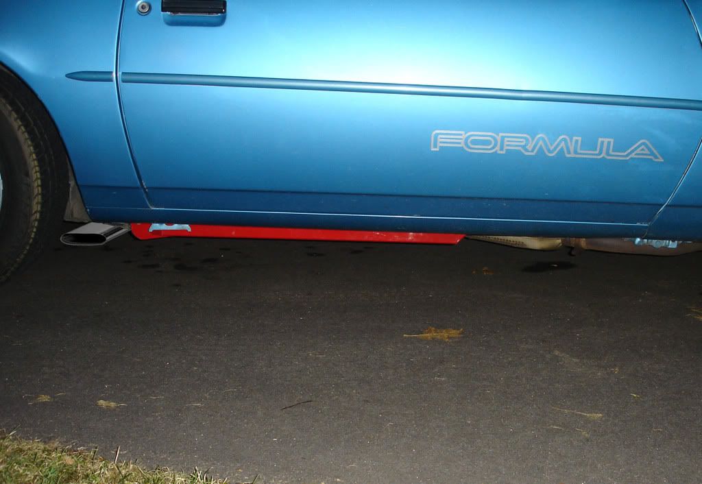

Well, I was thinking about this the other day, and wasnt sure if it could work...
I might want to take off the stock catback. Then, I would have the exhaust shop make a new pipe that could hook up to the stock catalytic convertor. It would be either 2.5" or 3" with crush bends for price. It would neck down at the front just like a flowmaster I-pipe, to hook up to the stock cat flange.
This pipe would follow the stock exhaust routing from the cat, over towards the driveshaft tunnel. It would utelize the stock hanger after the cat.
Then, it would have a bend back towards the passenger side of the car. It would run at an angle under the floorboards, and maybe have another disconnectable hanger off either my passenger SFC rail, or inner rear framerail. Finally it would use an exhaust tip similar to the one in the picture below:
Here is where it would exit...
Now, the only problem I can see with this idea, would be that it would exit under the rear LCA. What I was wondering, since it was too cold to jack up the car today, was how much of an anle does the Rear LCA achieve when the car is on a lift or jackstands? Also, I want LCARBS in the future, that probably wouldnt help... so do you guys think this could be feasible? Or would the LCARB crush the exhaust tip?

Well, it would be real expensive to have exits on both sides, because you have to get over or under the torque arm / driveshaft. And those articulate with the bumps too lol.
I just did a real quick photoshop of how it would look. I cant go any farther forward, because of my SFC's. But also, with a narrow tip like this, it looks stealthy (so the cops dont notice). And if you ever needed to remove the exhaust, it would be a piece of cake, no over the axle section.
Here is the better idea:

wait, its gonna be alot more than $50 to get it to exit on both sides...
I was just talking about the piece you need to make the "tip" out of. The rest I was gonna make out of round tubing. I dont even think Dr. gas's oval tubing could get you over the driveshaft, bad idea.
What I would do, is if you really want side exit on both sides, you should just cut the factory ypipe. That way you can run a pipe down either side of the tranny and driveshaft, and out both sides of the car. With no cats or mufflers, an exhaust shop could do this for about $300 or less probably.

Wow thats sick! Any sound clips? No mufflers, right?
The only problem with yours is, it exits where my Subframe Connectors sit. Thats why I asked if it would be possibel to exit it under the LCA.
Also, looks like yours sits pretty low. I would drag that on any speed bump. However, I was thinking, if I ran a single 3" pipe into dual 2" pipes, I woudl get the extra inch of clearence, with good flow too.

Well, I have seen those other cars. Those are pretty neat. It wouldnt really work on mine, because I dont want to put anything below the SFC's for ground clearence reasons.
Anybody have input on weather it would work if it exited below the LCA?

Well, I jacked up the back of the car today, and let the tires back down while the body was on stands. I found out that the control arms do not get that much angle, that it would really interfere with an exhaust pipe. Also, where the passenger rear floorpan curves up, would be a perfect spot to run the pipes out!
Of course, before I would ever get this done, I would have to get the I-pipe off the cat to hear what my LO3 sounds like with no muffler. If it still sounded wimpy, then I wouldnt even bother. If it gave me that NASCAR noise, I would definately do it.
