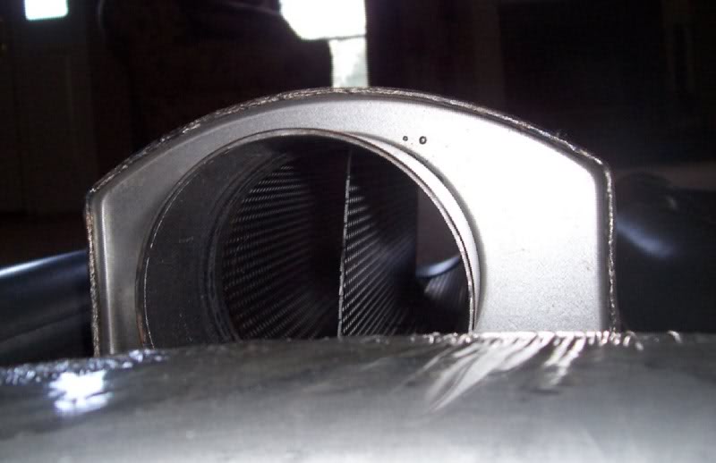

Doesnt really muffle all that much, but it flows great. Sounds good too. Ive had experience with flowmasters, Spiralflows, and these. And really to me it's more about the motor than it is the muffler. A hot engine is gonna sond good regardless. But went from a Flowmaster 80 to a dual 3 inch spiralflow system to a single 3.5 splitflow system and they all sound really different. But the systems they were bolted to were so different I have a hard time really doing an apples to apples comparison. If performance wasnt the main goal, I'd have a flowmaster all day long though. A cammed hot rod with flowmasters just sounds so good to me.

What kinda of muffler is that, that is a weird looking set up, perforated tube and a sound cancelation plate in teh middle? Is splitflow the brand?
