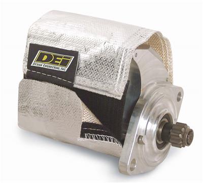

I ended up with a Powermaster starter with a cloth like heat wrap around the starter. I used a foil type of shield for the starter and some plug wires. I'm using Scott plug wires as well.

Yeah, I don't intend on wrapping the headers anymore. I still want to cover the starter with something though. Not too worried about the plug wires. I think I'll probably get a Mr. Gasket aluminum heat shield when I get paid next.

Lol, I just re-read what I wrote and it didn't make sense. I had to use a cloth type wrap for the starter because the metal one wouldn't fit with the headers. I used something like this. >Link

another thing that may be worthwhile and inexpensive to do is a remote starter solenoid. you can piece together yourself for about $25 and it'll guarantee you won't be changing starters because of heat
