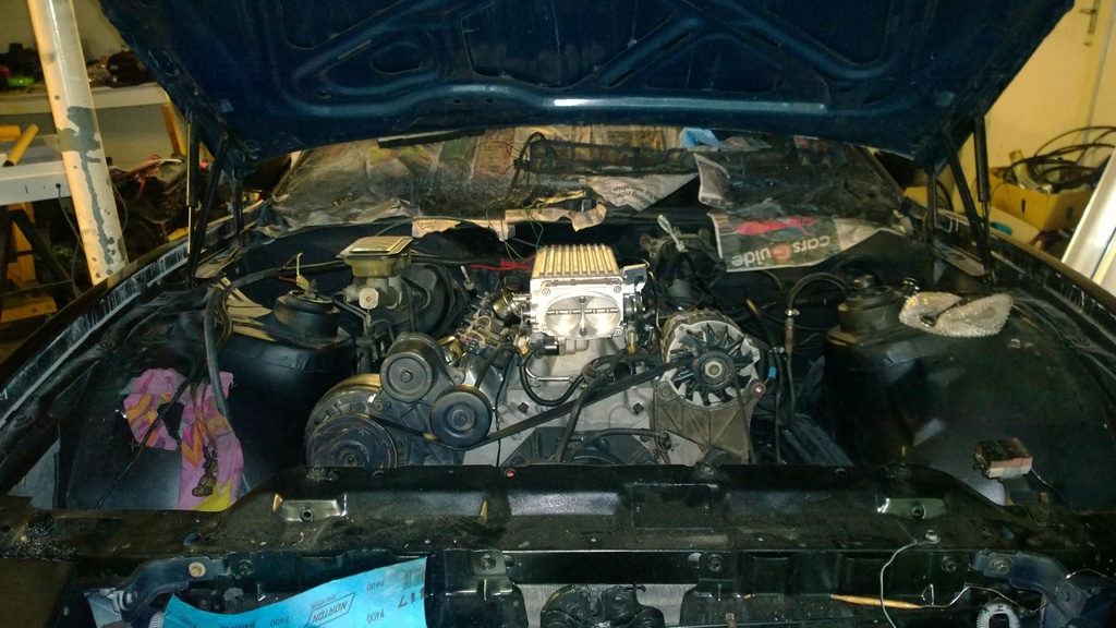

Re: Headers for RHD conversions
Originally Posted by LX_SS
How did you end up going Stuie, did you get yours sorted in the end ?
Oh the journey I've been through....
But yess all finally sorted.
My last hurdle is getting the 3 bolts on the header flange tightened at the same time as bolting the extractors to the heads at the same time as slipping the steering shaft on, at the same time as putting the spark plugs in, but it all fits without hitting anything.
I even managed to get the truck serpentine brackets modified enough to work and clear
Now onto starter wiring, fuel pump wiring, PCM power wiring, gauge wiring, PCM flashing, then maybe car starting
