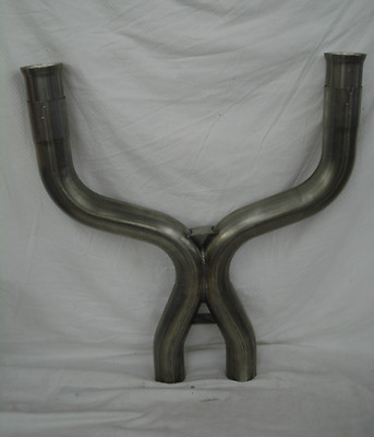

Has anybody ever compared X-pipes according to the shape because, if it alters the flow, won't it alter performance?Here are a couple diff shape I have seen, I would like to know which one is best before I buy one.

basically, air doesnt like corners. you want the turns as gentle as possible. this goes for x-pipes as well.

this is a sample of what the NASCAR boys run... they put a lot of thought into this stuff and use what works..

the nascar pipes are made so that the 2 sides are open to each other but the indicidual diameters are hardly reduced, unlike most of what you see for sale.
Here's what I built for a corvette, same principle.
