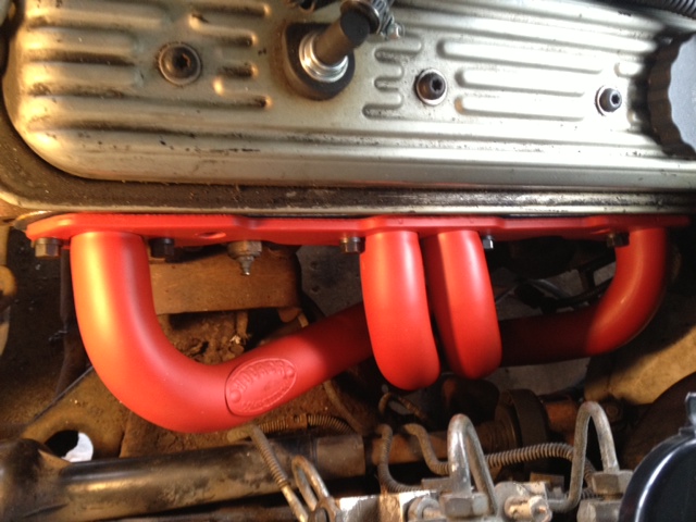

Thanks, that's a great idea. I got my headers painted this weekend and baked in the oven. I did take pics, I will try to upload them tonight when I get home from work. I have fabbed up a temporary Y Pipe so I can move forward with the work needed, just my SBFI Injectors, AFPR, and fuel rail installed along with the horns and plenum. I need to hook up the wiring and continue checking for bad spots. I took off the AIR crossover tube and cat tube so it is much cleaner looking. When I get the headers mounted I will post those pics also, they are still downstairs in the basement sitting on the shelf until I can get outside again and install them.
RJMcEachern
EDIT:
here's the pics...
These are after the blasting cabinet using fine grained glass beads..
RJMcEachern
EDIT:
here's the pics...
Last edited by RJMcEachern; Dec 17, 2012 at 06:16 PM. Reason: pics and fix my spelling mistake...

here's some more... i ended up using the VHT exhaust primer with 3 coats, one light two semi heavy, the VHT exhaust paint (red), same one light and two heavy coats and then after three hours it was time for baking them in the manner stated on the can. I hope to have them in this coming weekend and if all goes well the car back on the road. I will most likely not be able to get it to fire up yet though as I still have to finish some wiring in the engine compartment and also new fuel pump.
RJMcEachern
RJMcEachern

I hate to tell you but I promise that it's going to burn off regardless. EVERY time I've used either VHT, Rustoleum or any "header" paint it's burnt off. That even being surgically clean and prepping the best I could. I'm AMAZED that what little paint is left on my 2460's is still there.

you might be right, I finally got it all done and fired back up (after having the timing set 180 off). With the new injectors, new AFPR, new headers, new Y Pipe I half-assed fabbed up, repaired some of the grounds, it runs strong. Fuel pressure is a little low but I still haven't replaced the filter or the fuel pump. Need to hook the exhaust to the cat, tighten a brake line, bleed the brakes, among other things before I take it for the first datalogging. I also installed the moates.net G1 adapter, ZIF socket and burned a ABWT bin file...
The headers smoked like crazy when it fired up and started to warm up the first time, they are already starting to turn black so they probably will peel off the VHT coating I so painstakingly applied...thats a major bummer

" VHT coating I so painstakingly applied"
Same here. Yours look great. I stripped, sanded, acetone wipedown, vht prime, vht 2k, 3 heat cycles in the grill per instructions. Within a half hour on the car they are peeling all over. Either I missed something or the stuff just sucks.
