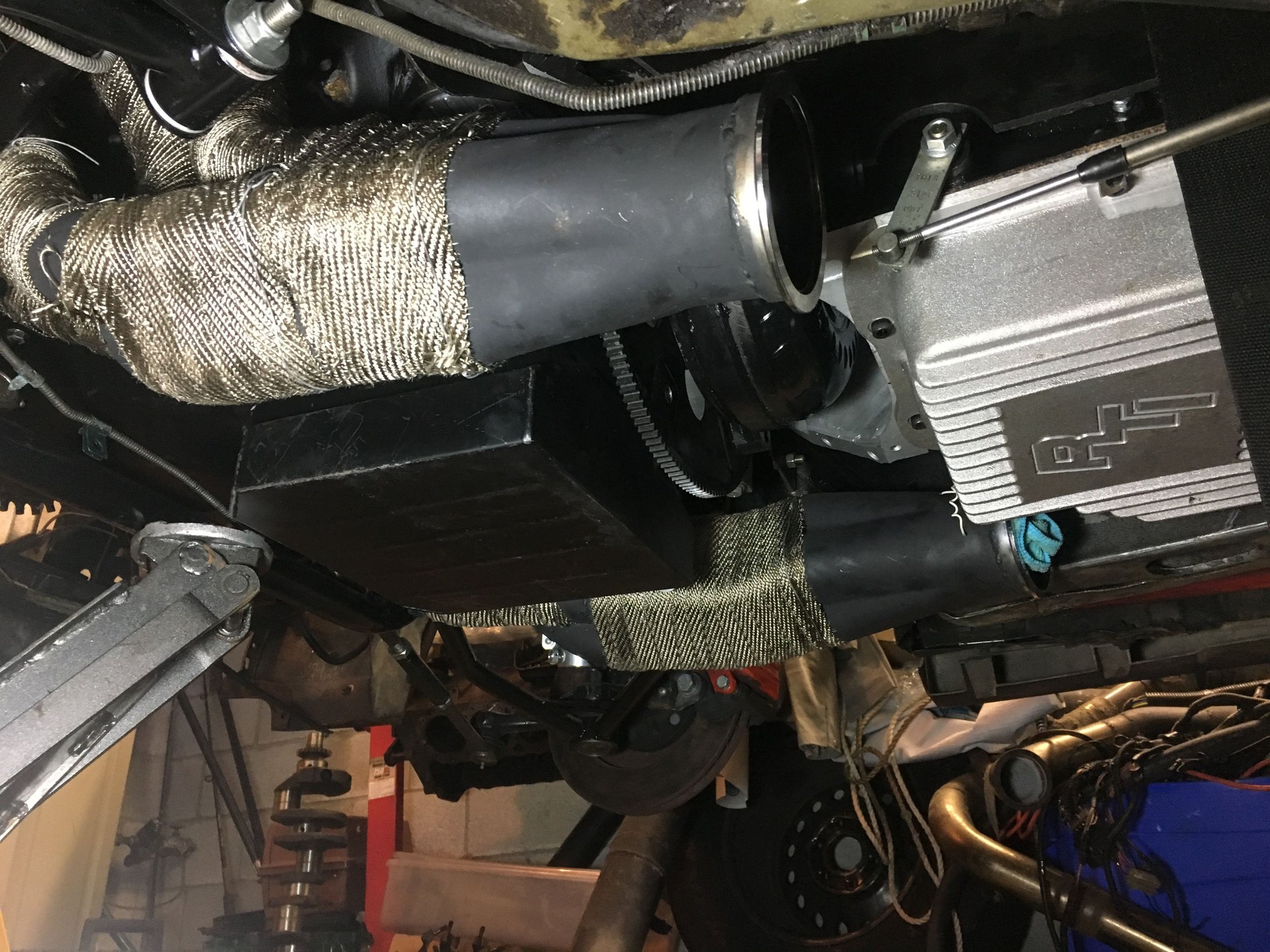

You would have to cut the trans subframe and notch it to fit 3.5” if you want any ground clearances. I went 3” under and around the subframe for my 555 and i know its killing the na performance but its only temporary as its going turbo soon

The problem is getting a longtube collector of 3.5-4” with right length and transition to oval by the crossmember. Theres not enough room if you have a big auto trans. Maybe with a t56 or something. I’m not sure.
But on mine with custom fabbed headers i can fit a 3.5” collector with good clearance but have to transition quickly to 3”

based on my math im going to need the 3.5 stuff. shooting for 750hp at the crank. suspension is stock style but all tubular also the torque arm will be a little more out of the way its a Midwest 9" with his third gen arm. headers will be custom as well so that should help with collector location. main purpose for the build is drag week and I want to be competitive in street machine eliminator. hence bbc/th400 bracket car lol. it doesn't see much street time but it is nice to not worry about dragging exhaust when loading and unloading from the trailer.
seeing orr's pictures makes me think down and forward out the fenders really might be my best bet.

Despite the way it looks the 3” clears well. Cutouts there at collectors would help a ton i think. I want to test it but i likely wont. Starting turbo fab

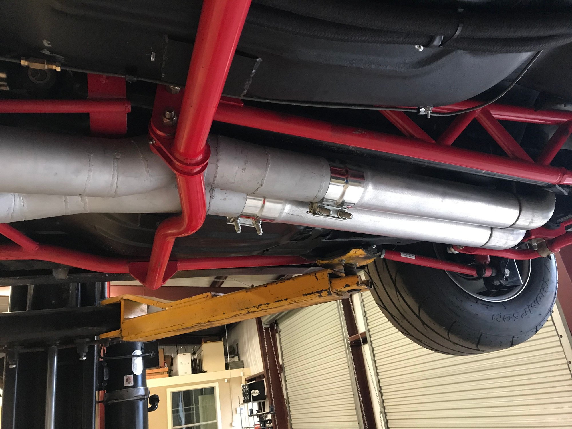

Old Aug 28, 2019 | 09:24 PM
landsmotorsport's Avatar
Joined: Dec 2012
Posts: 11
Re: 3.5" dual exhaust
3.5" exhaust on my 1988 camaro.
