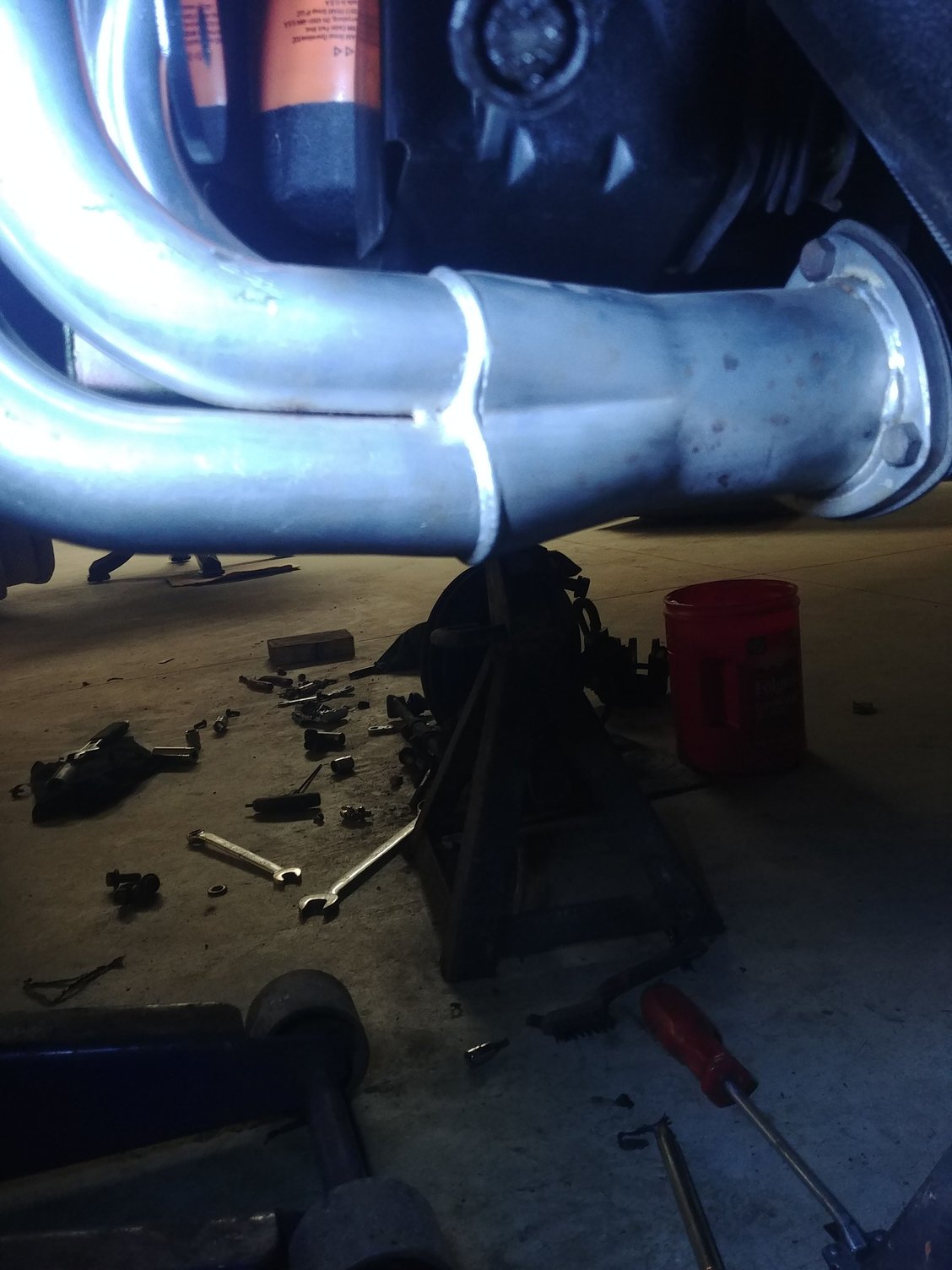

I dont know if it helps or not. Im runnin Doug's long tubes, same as 2210 hookers. No issues with a t5, ive since swapped to a t56, but an aftermarket version that uses the t5 bell and clutch. Im in the process of redoing the y-pipe now. Ground clearance could be better if the slave wasnt in the way. I guess a mid length could work around it better. Only time I've ever hit was before I had an apron on my garage door opening. Was like bumpin up over a small curb. Never hit otherwise. And thats on sweet NY roads

I’ve considered those but they look like they’re pretty low in your pictures. I’m lowered but not drastically.

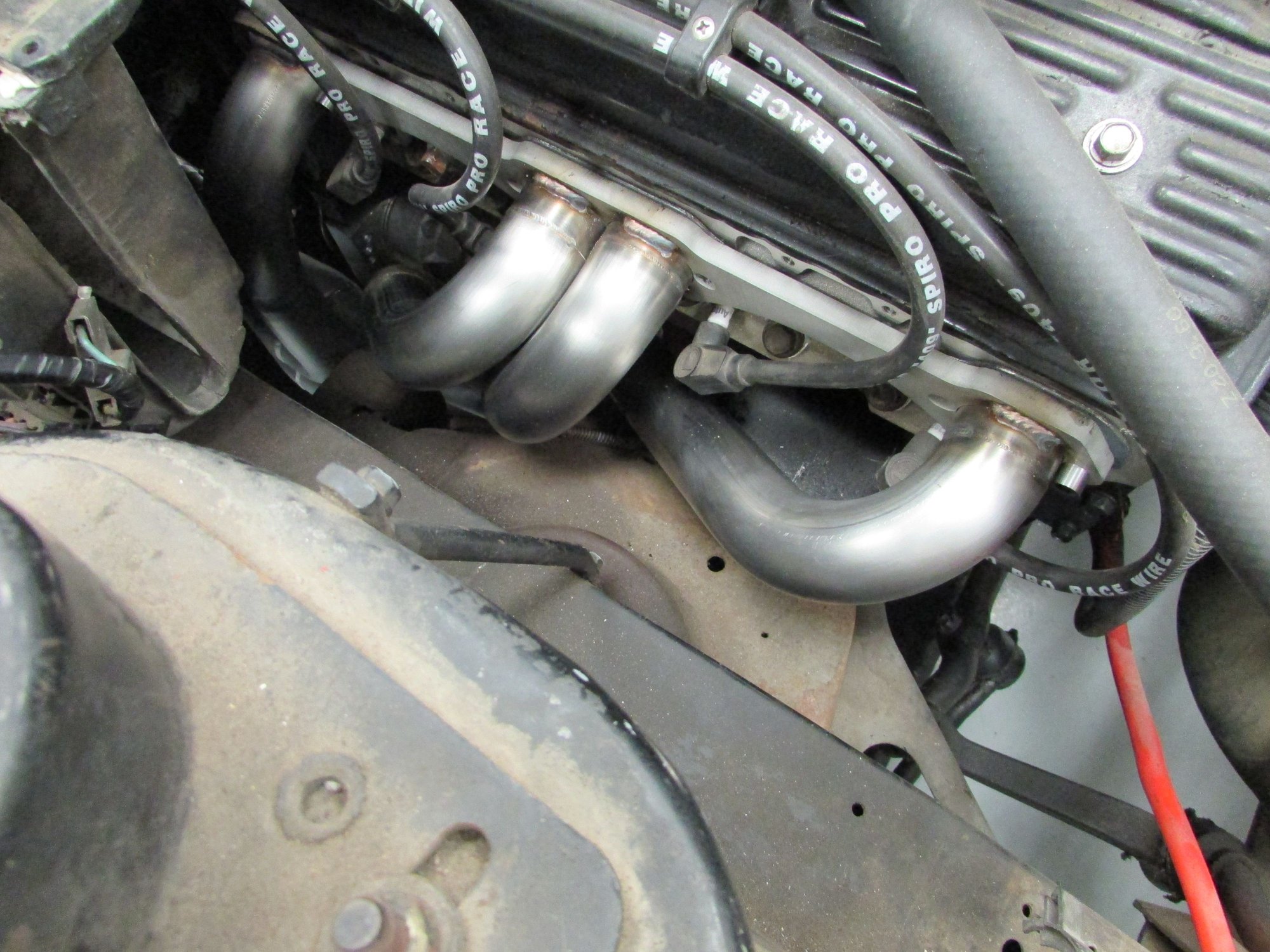

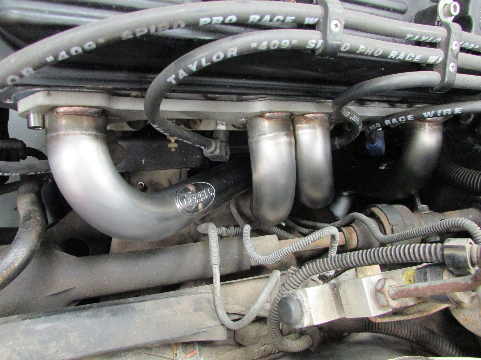

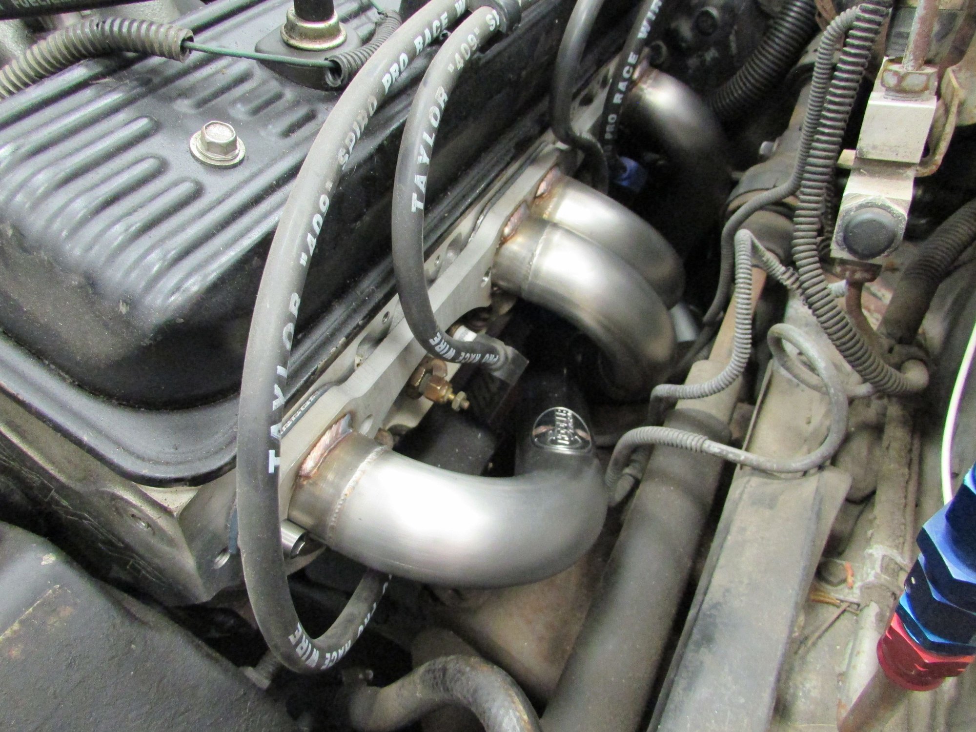

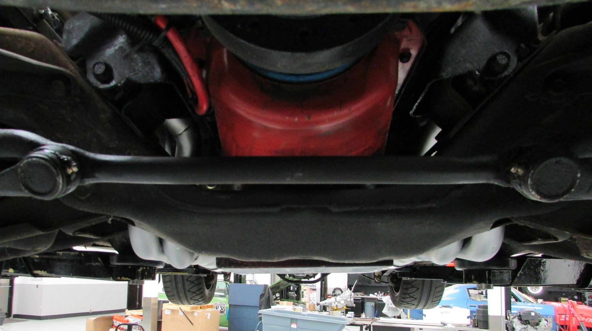

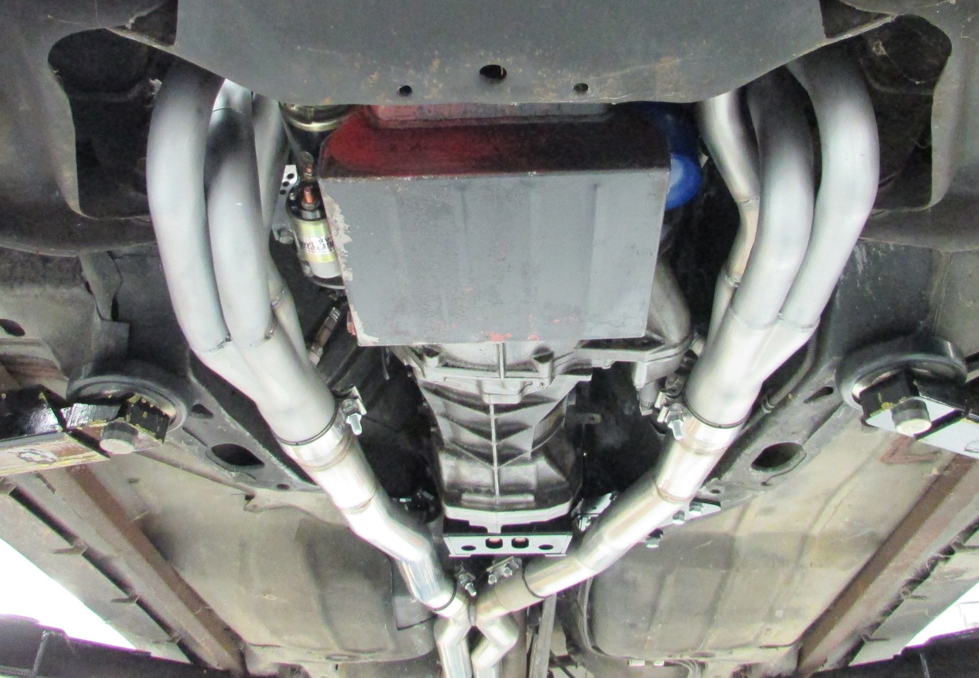

I saw this thread yesterday and thought I could give some input. I can say that the headers will indeed be getting released. The timeline for that happening was pushed backed due to the Coronavirus situation, but I think it won't be much longer. Due to them not being released yet, I am not permitted to reference any part numbers for them, or show images of their total specific geometry, but I can post these two that give a general idea as to their fitment. The provide the same ground clearance as the Hooker Blackheart 3rd-gen F-body LS swap headers.

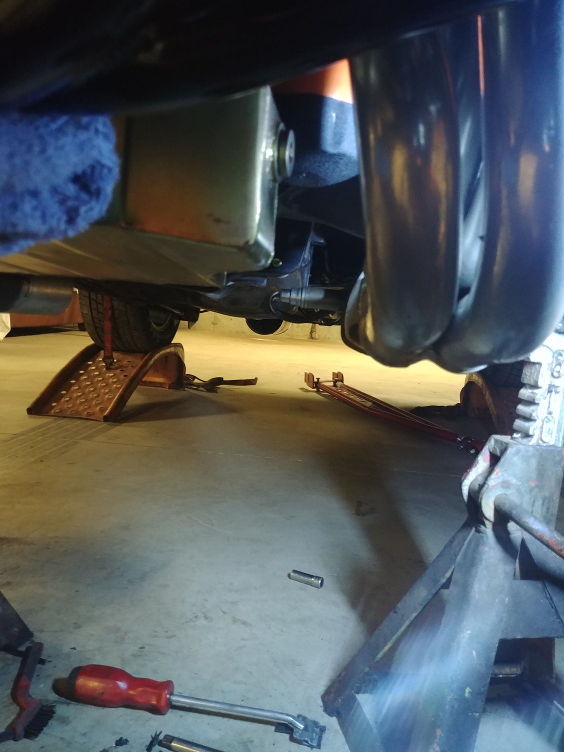

What kind of clearance around the slave?

My guess from looking at the undercar photo I attached would be more than an inch away where the inlet leg of the exhaust system passes under it.

Some additional information regarding the headers that is not evident in the images I posted...the engine in the development vehicle was equipped with AFR angle plug heads and the headers with be available in 1-5/8" and 1-3/4" versions with stock port flanges and also an 1-3/4" version with D-port flanges to fit the AFR heads and those with similar port dimensions.

They look pretty nice in those pictures. What do we know of or can be released about their construction materials? Ceramic coated mild steel and/or stainless? I can see where it passes by the slave cylinder, the collector being the only reason there is any clearance there at all lol. They may eventually have to join my list of future parts if I can indeed prove to myself that there is a benefit to them over my dyno dons.
It it may sound like a strange thing to say and not everyone may agree, but btw my ‘96 SS with long tubes and my ‘86 Firebird running DD shorties and y-pipe the SS has a much cleaner sound to it. I have a cutout on the ’Bird to overcome the 3” catback restriction when needed but I’ve only uncapped it once. Had that “farm truck” sound, not a sexy performance sound even remotely. I figure it’s largely due to the extreme difference in runner and y-pipe lengths before they merge under the passenger’s feet. Happy to see the aftermarket rising up to meet the newest generations of classic performance cars even if slowly so.

The initial releases of the headers will be 304SS only, which is usually the way all of our headers are released. Mild steel versions usually follow them about a year later, if at all. As you noted, collector placement is critical for providing clearance for the T56 slave cylinder and is even more so for clearing a 4L80E transmission case.

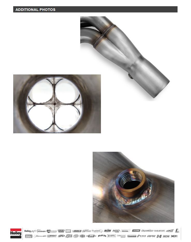

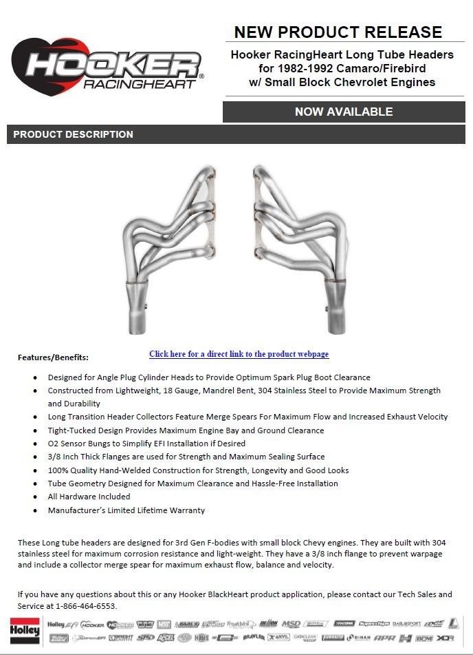

The new product release for these headers came through my email this morning, which means all versions of them are on the shelf and available on the Holley website. It usually takes a few weeks to find them on one or more of our resellers' websites as they need to load them into their systems. There are three different part numbers available, which are as follows:
BH13201 1-3/4" primaries with stock port shape flanges
BH13202 1-5/8" primaries with stock port shape flanges
BH13203 1-3/4" primaries with D-port shaped flanges

Here's a few more images of the D-port set on an engine with AFR heads.

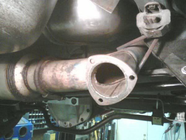

A little experimenting I did a few years back regarding my restrictive exhaust.
First I added this cutout at the turn just before the muffler.
Then opened it at the track (sadly only an 1/8th mile that day) and recorded results.
8.124 @ 83.82 1.81 60’ (3.73 gear)
8.070 @ 85.14 1.81 60’ (muffler uncapped)
This was back to back. Both passes within an hour.
I think the most telling part is the improvement in trap speed. With just an 1/8 track to work with, it was worth ~ a second and a half.
The great online calculator says:
Corked:
Your HP computed from your vehicle ET is 340.83 flywheel HP and 306.75 rear wheel HP.
Your HP computed from your vehicle MPH is 338.61 flywheel HP and 304.75 rear wheel HP.
Uncorked:
Your HP computed from your vehicle ET is 347.72 flywheel HP and 312.94 rear wheel HP.
Your HP computed from your vehicle MPH is 354.87 flywheel HP and 319.38 rear wheel HP.
For the first time out with that particular engine combination, no real tune and certainly nothing to compensate for the better exhaust, gaining 14 RWHP has some real relevance.
For the record that package eventually went 12.489 @ 109.264 MPH (corrected) through the muffler. I'll wager that with the headers opened into properly sized collector extensions it would have put it in the bottom 12's. And that's with no drag slick goodness left in the ET Streets. 60' times never recovered to better than 1.85 when the previous best was 1.71. Although that last bit has little to do with a better exhaust.
But I think my point has been made.

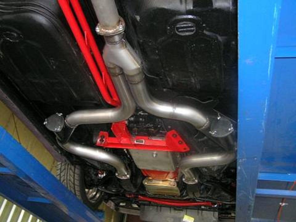

I think the next step is to go this route.
Or something similar.

Is the rest of the system pictured here the black heart system for LS swap headers? When I ordered my BH13203 headers the reply from Holley was unsure if that system fit seemlessly.
Yes, the headers will connect to the Hooker Blackheart exhaust system as long as you are running a T56 transmission and are supporting it with the Hooker Blackheart transmission crossmember. If you are using a different transmission and/or crossmember, some amount of adaptation of the exhaust system inlet tubes should be expecked.
