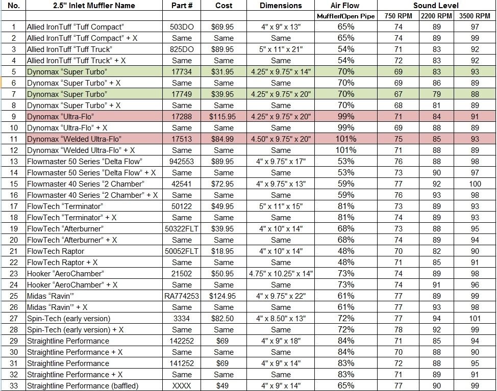

I came across this chart when researching muffler CFM. While sound is a consideration, I was was looking for something that moved over 1000 CFM. Make of it what you will. I can't say I can recall where this came from as it's been in my files for better than a decade.
FWIW, I also have these. Again this is about CFM but it may twig an idea for you.

Good info guys. Greatly appreciate it. I need at least 1k cfm of flow. That chart narrows it right down for me. I've got a good foundation now to go off of.

Leaning towards dyno max ultra flow 17220. They make one that's 24" and 28" I believe? Have to look again. Maybe it was 32". Guess at 64 bucks if it's too loud it's not that big of a deal. Have more time in rewelding it up if I dont like it.

Well, if you can believe their marketing hype: "Dyno proven to flow up to 2,000 SCFM and support up to 2,000 horsepower" then lack of flow certainly won't be a problem.
Scientifically there's a difference between Standard Cubic Feet per Minute (SCFM) and what we've come to know a CFM, but with a number like 2000, I can't see the difference affecting your performance. Looks like more than enough to me.
