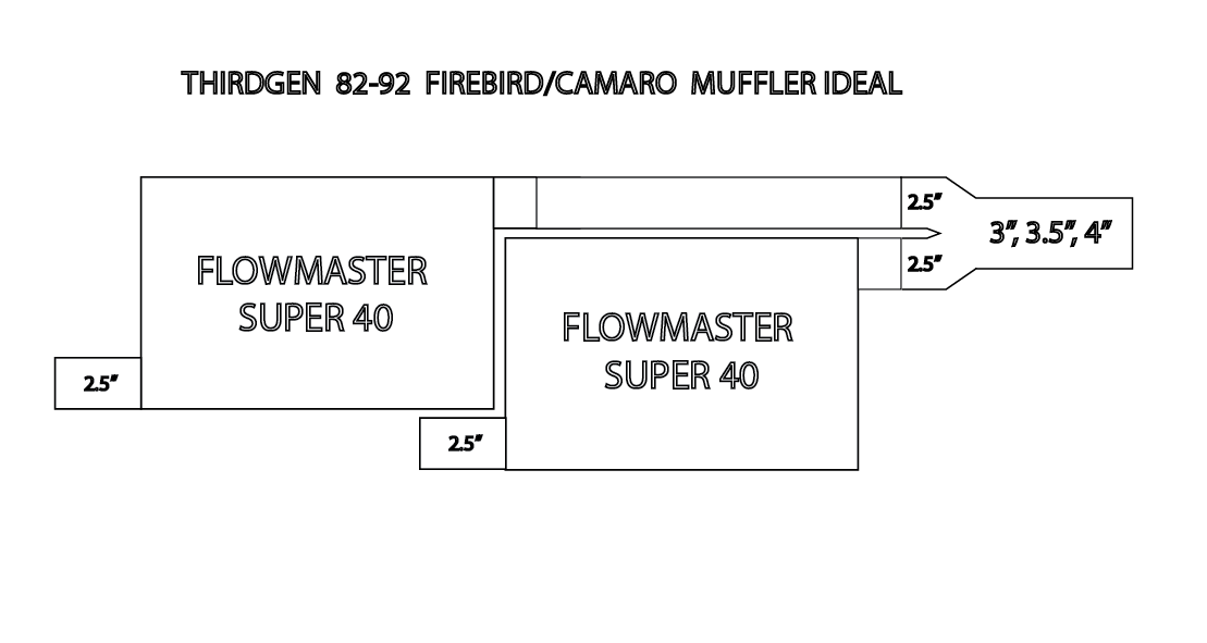

MUFFLER IDEA SETUP? WOULD IT WORK?
Rekon it would work?
Would allow 2 flowmasters to be mounted, a little ingenuity to put them in that area, but i rather have (2) than the crap cross flow garbage! Not to mention that "DUMPED FLOWMASTER GROWL/SOUND"!!
Thoughts?

Re: MUFFLER IDEA SETUP? WOULD IT WORK?
Where are you putting the mufflers?
Under the car or in the back?

Flowmaster is one of the worst mufflers you can buy for performance. There are straight thru mufflers with a single 3.5" or 4" inlet and outlet, and packaging would be straight forward easy. Hidden tailpipe and you're in business.

The "crap cross flow garbage" often is completely straight thru from the inlet to the opposite outlet with a second outlet split off the middle. Compared to a Flowmaster chambered muffler with dead ends and delta walls, I'm not seeing the advantage over the muffler that actually fits the design of the car.

Looks like you will have to use the #952548 with the offset inlet/outlet with 2.5.
Check out the specs for size. Sketch it out on poster board with the dimensions and try it out under the car for reference.
Flowmaster Super 40 Series Delta Flow Mufflers 952548
Case Exterior Length (in.):13.500 in.
Overall Length (in):19.500 in.
Thickness (in):5.000 in.
Width (in):10.000 in.
Or you could just do a single 3 inch inlet with dual 2.5 outlet on one side like the

One muffler with 2 outlets isn't enough, would choke it too bad.

You really have no idea what you're talking about, one muffler with two outlets can support well over 500 horse

@Annihilate
Thank You for being an "ADULT" with an "ADULT RESPONSE" and educated response.
Seems there is much hate on Flowmaster, the question was never about "FLOWMASTER" in particular, the "flowmaster butthurt" came out of some. Why i dunno.
You could literally replace the flowmaster with muffler "X" in that schematic, it was just my personal choice, question had (0) to do with brands, just actual mechanic and ideal of mounting.
Again, THANK YOU for being an "ADULT"...

@badgta, read your initial post again, and then without knowing what the hell you're talking about try to tell us what that says, like WHERE do you intend to stick that mess? And you really wonder why people are treating you like a retard? Maybe you really have some clever idea that none of us has ever thought about... I doubt it, but none of us would ever know from what you wrote.
That said, that is exactly the packaging that was used on some mid 90's chevy trucks under the bed behind the cab, and they did sound OK (not good by most people's standards but better than stock...) with some flowmaster muffler models spliced into the stock pipes, specifically the deltflow ones, but besides the fact that I have no idea where you're going to do that with a pair of 19" or so muffler cases on an f-body, the bigger problem is that GM only did that on long bed trucks which had long tailpipes, and longer tailpipes quiet down some of the noise that is associated with Flowmaster mufflers, and second, the longer the pipe the lower it's harmonic frequency, tuning it for a deeper tone than you'll get on a f-body because of the lack of length. Now the reason that I specified the deltaflow mufflers is that Flowmaster designs have always had a problem with horrible cabin drone in the mid 2xxxrpm range, and the deltaflow mufflers fixed that somewhat. Back in the 2000's I worked at a speed shop and we avoided selling Flowmaster setups because too many people were unhappy with them and even tried to return them.
Second, you mention a ford 302 (I'm assuming a fox mustang and such). Well I hate to tell you this, but 5L fords have a different firing order and distinct geometry which makes them sound very different, and the whole combination is what sounded that way. Since then ford has worked HARD to maintain that distinct "mustang sound" even with the mod motors. If you look closely at their exhausts since then you'll notice all sorts of little tricks towards that end, things like running 2 different size mufflers, odd, unnecessary bends and size changes that do not match side to side... this is nowhere near as simple as sticking 2 40 series mufflers on a cambird. Heck, you could take the exhaust off of a fox mustang, stick it on a SBC and it would sound totally different. Lets take this a step further, a 305 and a 350 SBC sound completely different. Put a different cam in the engine and it sounds different. One of my favorite sounding exhausts on these cars is 3/4 length headers (headman are preferred but the hooker ones work also), dual high flow cats into flowmaster Y and a single 3" pipe over the axle and out the back with no muffler. It sounds INCREDIBLE on a stockish 305, especially the early crossfire cars and also the later TPI cars. The funny thing is that it doesn't sound right at all on a 350 powered car, even a 350 TPI car with the same stock cam, or a 305 with a decent cam.
If you like the flowmaster sound, well great. Most don't. But don't even try to argue that they work better than most good setups. They are basically 70's tech that they started selling in the early 80's and for the most part hasn't been improved significantly in 30 or more years. By the time the the 80's was over the stock mufflers and exhausts that came on these cars flowed better than a comparable flowmaster setup. The stock 4th gen setup looked identical and I've tested it back to back with the stock muffler and straight pipes and I wasn't able to show a difference at the dragstrip or the dyno (I had an '97 WS6 TA that I had cut the intermediate pipe right before the muffler and installed a flange so I could remove it at the track in the staging lanes in about 3minutes so I could test same track, same day, same conditions...). The last new muffler design that flowmaster has come out with was the hushpower series which I believe are from the 90's and are both quieter and flow better than any of the traditional flowmaster designs. Stock, quiet OEM sedan mufflers from the 2000's and up flow better than anything similar layout from flowmaster.
If you want to stick 2 flowmasters on your f-body, well great, knock yourself out. Will it work? Well, you'll have an exhaust on an f-body, does that count as working? Don't expect most others to like it, and by the time you wedge 2 full size flowmsters under an f-body you'll have no ground clearance and I doubt it will flow better than the stock exhaust, much less a well thought out modern design.
While I'm at it, flomasters aren't even what they were 10years ago- go find a current one on a shelf and look at it, the company was sold 10 years ago and production has been outsourced since then, made in china, they are actually Chinese copies of the original designs.

There you go again, crying about "FLOWMASTERS" when (YET AGAIN) it had (Z E R O) to do with "FLOWMASTER"..
I used that as "MY CHOICE" in that schematic, has nothing to do with them exactly, you can insert "MUFFLER X" in the place for whatever it means personally, muffler choice has again, NOTHING to do with it. ...
Now you went through that whole big spiel to whine about flowmaster's also. Really? WHY? Did i not say it enough it was my "PERSONAL CHOICE" and it did (NOT) have anything to do with said question?!?! Was it really worth it for you to do so? Do you feel better now about yourself???
Do you not see my point as well as others who read this when i said (SOME OF YOU) who have replied here need some (SERIOUS MENTAL HELP) with this hate toward a certain brands or mods, especially considering how you have went well out of your ways to completely avoid the question at hand and to use the post as an opportunity to show your **** retentiveness and butturt toward certain brands again that has (Z E R O) to do with it..
