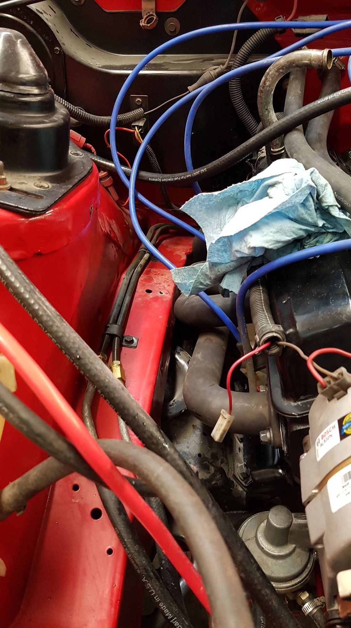

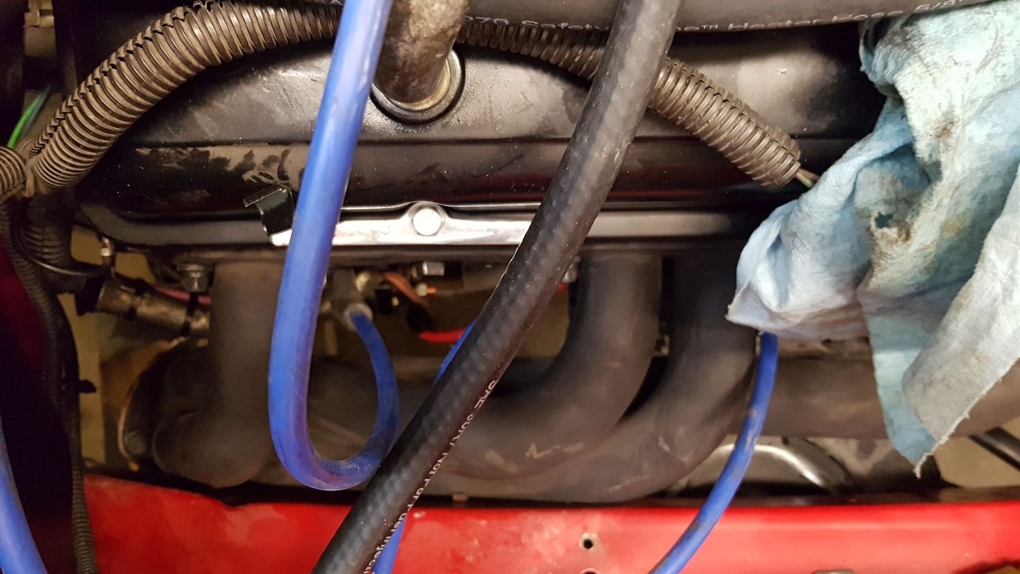

Can anyone that has these headers installed please snap some pics of the passenger side clearance between the tubes and the frame rail? Mines touching 🤔

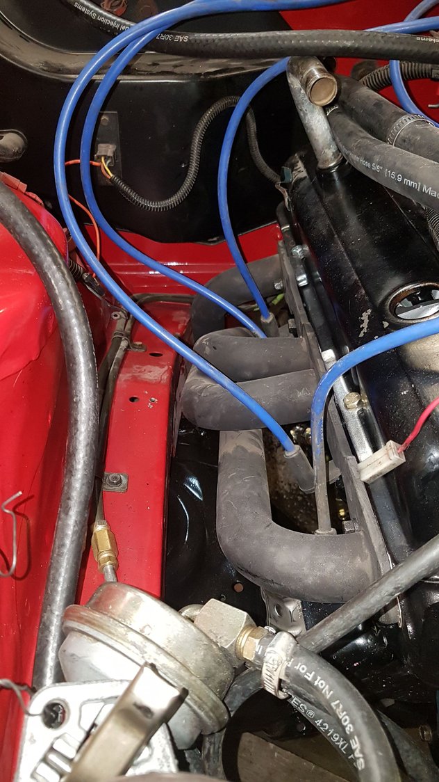

Here is mine I would guess you have a motor mount that needs replacing

Mine has about enough space to put my hand and not touch header or frame rail

Ok ill check that too thnx, any suggestions on replacement motor mounts? poly versus stock rubber
Old May 28, 2021 | 05:32 PM
rumpity_z28's Avatar
Joined: Sep 2004
Posts: 16
Re: 2460 headers

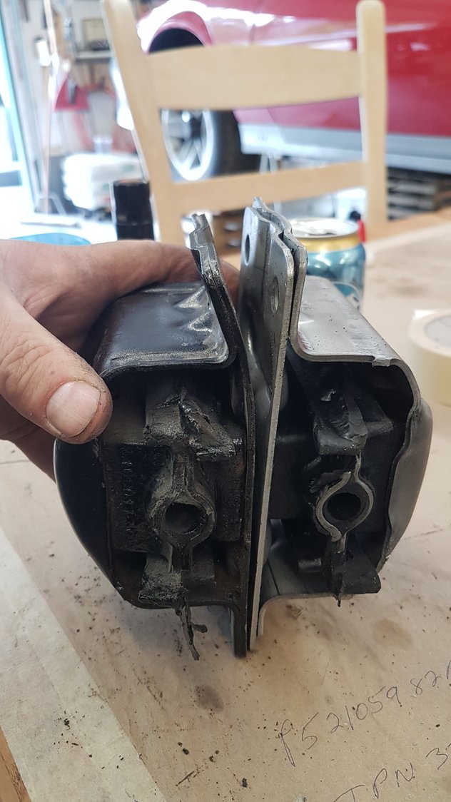

Well this is what I found, and the k member is caved in where this sat.

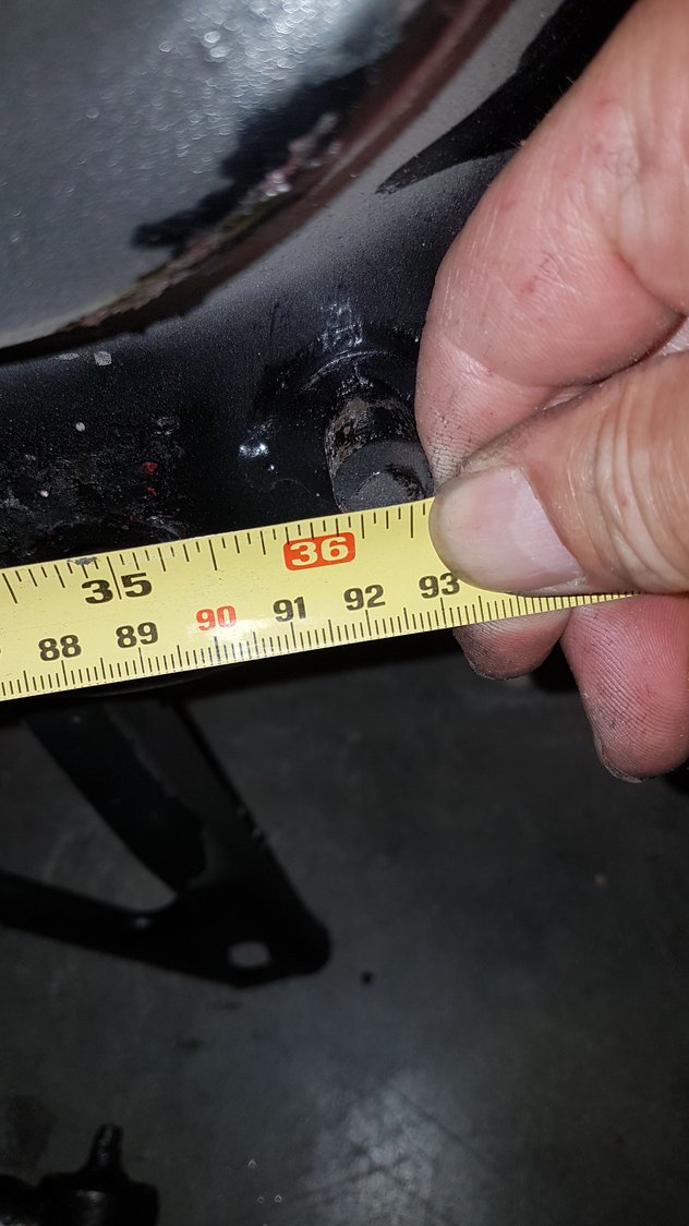

This is the old k member
This is the new one with the angle from the old crossmember put up to it for comparison
These are the locator pins on the old k member center to center measurement
And this is the new k member measurement

So this is why the headers were way off 🤔 and I built my own y pipe using mandrel bends which may need some tweaking after I get this fixed

And done
Looks much better
I had to use a hydraulic ram in between the rails and push it out a little over 1/2" for the new k member to line up
