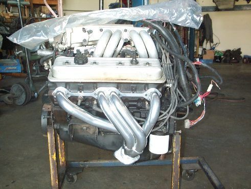

You could use my headers and have someone modify the ends of your y-pipe to fit.

Or, use Don's stainless headers & Y-pipe, and retain the cat & cat-back. Personally that's what I'd do.

Again, I'm not Don, but AFAIK, his product is stainless, and is either ceramic-coated by default (the ones in his photo are), or he makes it available. Or if not, you can have it done yourself. Ceramic over stainless is BY FAR the best recipe for headers.
