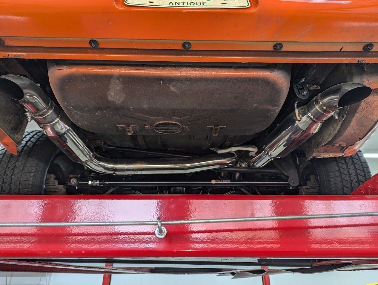

I couldn't find any photos of this. Running dual exhaust with bullets in the back. Thinking of cutting out the trunk so I can fit some larger case mufflers. Anyone done that?

The mufflers are really small, so I imagine it is just as loud. These types of setups are great on stock cars, but on 500-1000hp cars they are just obnoxious.
Unfortunately, as you know there needs to be a balance between flow and sound to support the power. What I've found through reading is basically the largest case straight through muffler you can find will flow the most and have the most sound reduction.
Right now I'm thinking an 18x10 muffler where the cats normally would be (I have a turbo car, so 3.5" downpipe), split into the dual 3" and then two 14x10 mufflers in the back.
My current setup is a 4x12 race bullet and the two 3x10 bullets in the back, and it is kinda annoying.

I would think you'd be able to cut the trunk right out and weld a piece of back in flat across from frame rail to frame rail and have all that extra room

Yeah, you can do whatever you want with that deep trunk section pretty easily.
I modified mine to extensively (thread in my signature) to make room for a 15 gallon fuel cell to be mounted under the car.
Still fabricating.

I have the speed engineering kit as a base but have replaced the bullet mufflers with small spintechs, and have spliced in a borla resonator in the pipe section where the stock muffler would be. The resonator is only on one side of the duals as I am trying to figure out where to put one on the other. The chambered tubes are also an idea since their overall diameter is closer to your pipe size. Even after all of this, the car is still too loud. The drone is brutal. I am going to give it another shot but may eventually switch to a mufflex 4".

If only it were that easy. With a true dual set-up there is barely enough room for the pipes themselves. You can get a normal style muffler on one side of the dual in the stock location but the other side is severely space limited.

Rock Solid Motorsports has a panel for 4th gens with an install video on YT. That would leave a lot of room for a rear mount War Whistle!!

You can make the “trunk” any size you want, or not at all without compromising the structure of the car. It is mainly there to protect the fuel tank in a rear end collision.
I shortened mine 1.5 inches to make the rear of the car flush for the diffuser. With that being said, have you considered removing the rear seat buckets on a rear seat delete car and free up space for full size mufflers under the car? Just a thought.

I'm trying to figure out how to fit a decent size case where the cat normally is and I'm thinking the two 14x10 ultra flows in the back. Gonna be a lot of cutting and welding though.

I think if you angled the corners of the trunk well a decent amount, you could probably fit a decent sized oval muffler on each side mimicking the trunks new angle. would save you as much trunk space as possible while still getting a larger muffler in there.

The weld in panel from rock solid looks like a good idea, it would work great for this application. There would be plenty of room for mufflers under it. You could still have room in the hatch area for sand bags/ballasts for winter driving!

I don't think reshaping the cargo well would cause any structural harm to the car.

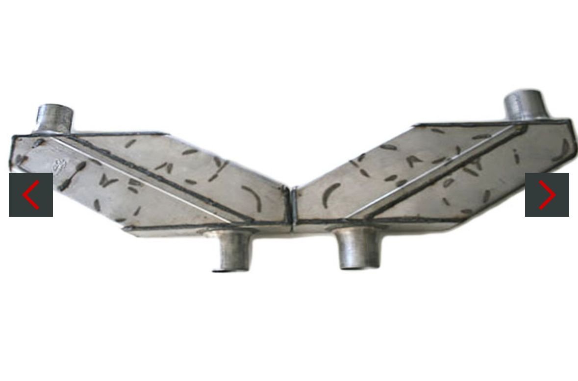

I wonder if I could get this muffler setup to fit. .

I was actually thinking a muffler design just like that would be ideal. Either just like that or a split design. If you put a flat panel in where the valley was I wonder if there would be any resonance issues.
It looks cool. Would that support your 1k hp? The piping looks small in the pic....

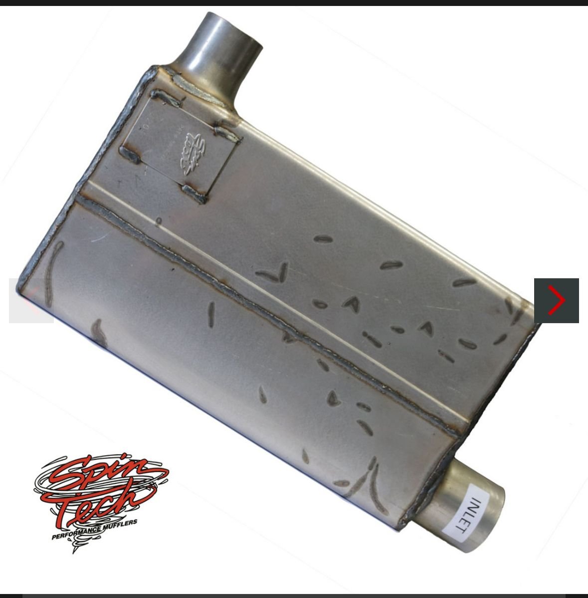

Spintech makes stuff that will work. I've used their mufflers on a bunch of cars.
one of these
Or 2 of these.

I like spintech, they sound cool. Unfortunately they don't flow very well.
I've got really two options here, use a quiet poor flowing set of mufflers and an electronic cutout for the track, or moderate flowing mufflers (like ultra flow) and deal with the noise .
The ctsv mufflers I posted above are good for about 600hp before you see a rise in back pressure.

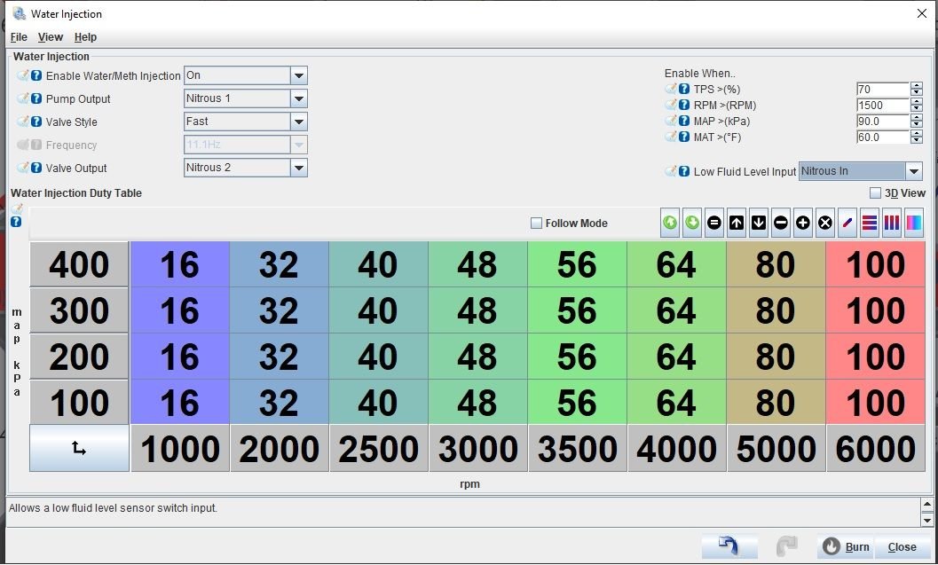

I kinda hate the idea of meth injection just like I hate DEF on newer trucks, but at the same time the fact that you can run 20 psi on 91 octane is kinda amazing to me.
On my MS2 the injection is just on/off at a given RPM/MAP/air temp but MS3 offers control over pump and solenoid:
However, the only safeguard is timing retard based on air temp. My boost control does not offer a boost cut for air temp.
I'm still running batch fire MS2. I considered going to MS3 and running full sequential, but I'm not sure if it's worth the effort.
I would like to have my ECU control the water/meth system eventually. I've been playing with that part of the software to wrap my head around it. I like the AEM controller where I have the start point at 6 psi and all in by 15 psi and it's a nice and linear

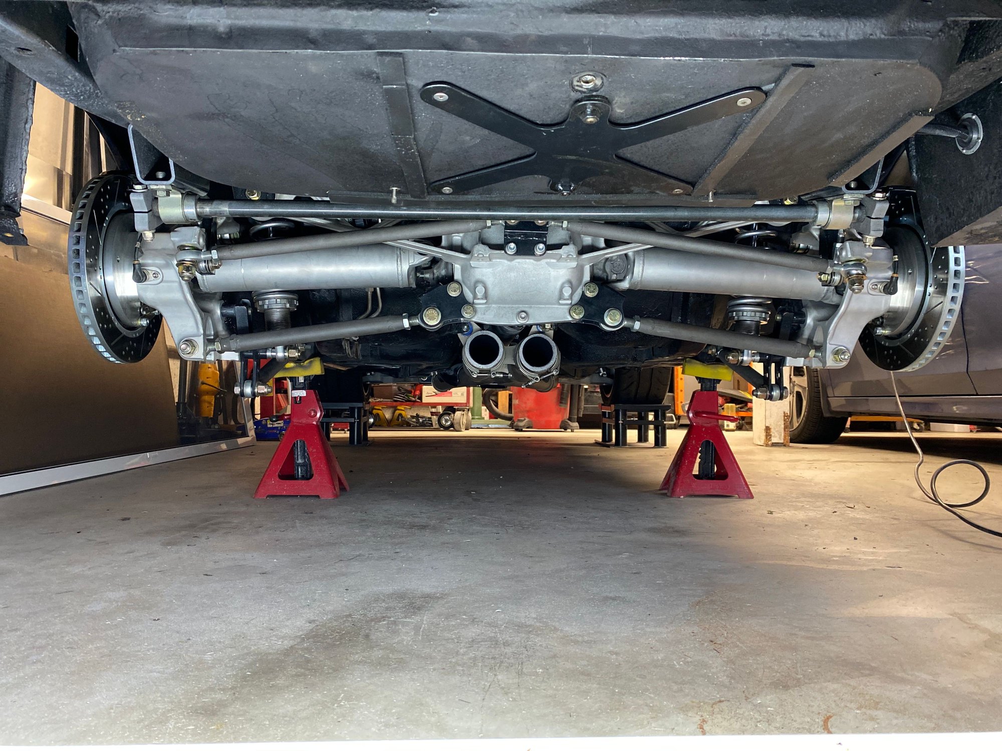

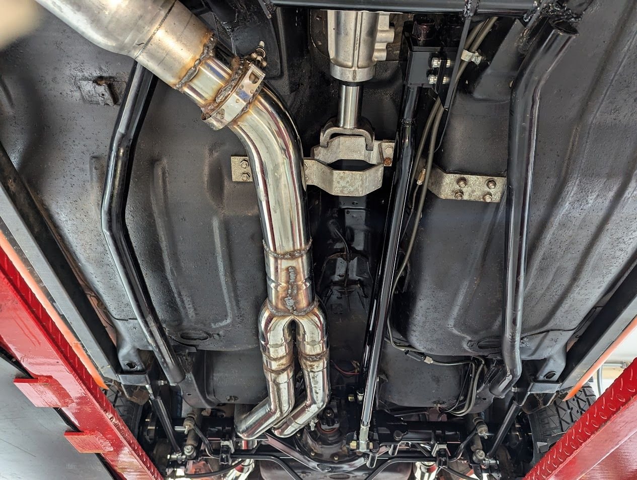

I think those are really small flowmaster 10 series mufflers. There is no way I could fit a 14" case muffler by cutting the seat base out, and given how much bigger my 9" housing is I don't think I could run the pipe up and over like that either.
This is on the four post lift at ride height.
Plus I'm a single 3.5" downpipe turbo, so crossing over to the driver side would likely cause issues with the torque arm.
