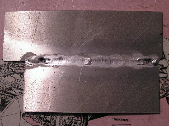

finaly got a little time to try it out today, set the hf to constant, remote amperage on, remote contactor on, argon at 15 psi, ac power on middle setting (40-155). first weld didn't even get 1/2 penetration, second weld (upped the power by 10%) got a little more then 1/2 way through (was trying on 1/16" aluminum sheet)

Old Sep 22, 2004 | 03:21 PM
cam-'s Avatar
Joined: Mar 2004
Posts: 2,519
From: In the Garage
Car: Camaro
Engine: 6.2L
Looks like you need to practice your sign off

just need to practice period, thats my second and third time ever trying to weld aluminum. i'm just happy to get it to stick at this point

Looks waaayy better than my first couple of attempts man you should have seen it

Let me say that you definatly have some experience. Those look really good for the first time. My firsts didn't even butt joint. I was just working on pooling and "seeing" the pool. Then I worked on adding filler. Then speed. Then I did some "art". The hardest thing to do is thin sheet onto thick tubes with acute angles. I've given up and just added enough filler to make a web .
Your sign offs do need a bit of work. I find it useful to almost lift half way about 2 inchs before an end and then try and walk it in to the point where the arc is almost gone. This way the filler goes all the way and I don't get round coners . I'm sure more experienced welders could give you some of there tricks, I'm still new to this.
