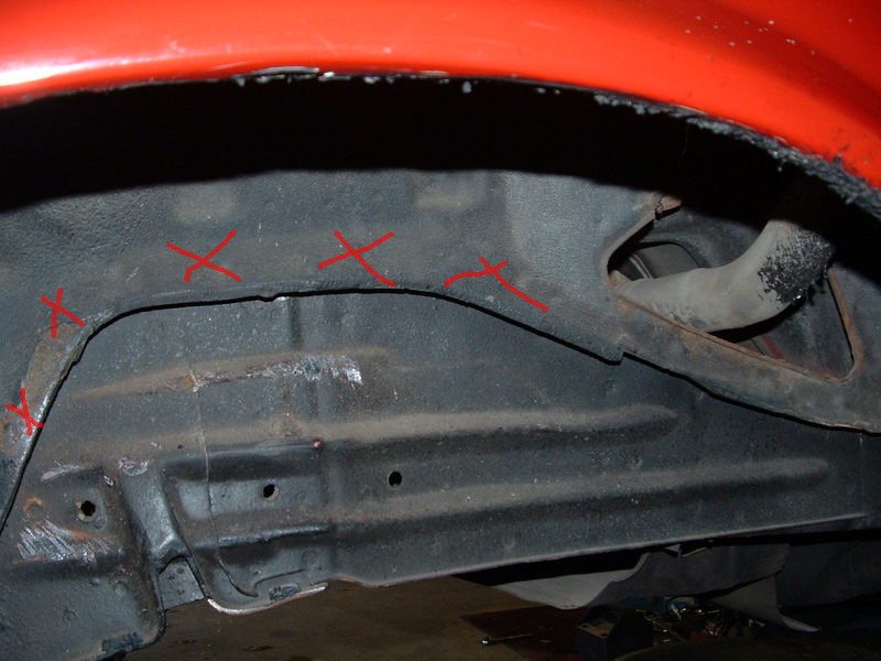

For those of you that cut all these parts out already, is it possible to remove the “X-ed” out section in this picture without removing the whole inner wheel well? Where would you have to cut to do it? Maybe a few pics of the assemblies that you have sitting against the wall from the bottom/different angles?

on both sides you haven't moved the tubs inward yet....you need to remove the entire bumpstop piece of steel and then some, make it look like the pic I posted. Right now you've just enlarged the hole opening, but not made the width opening any bigger yet. So far progress looks good, I haven't seen these bottom seat brackets in years, so I had to look at them twice to figure out what they were for.
Woops, I forgot the attachement

looks like he only cut out the top portion, but everything in that picture needs to be removed. All that sheetmetal is in the way.

I cut out the entire well, I still need to remove the caps that hold the springs, I will do that shortly. As far as that lip you have highlighted, yes you could remove it but it won`t open up any room, it is a flange where the floor and wheel well are welded together.

Greezemonkey great outline on what to cut out and it gave me some ideas because I am right around the same steps that you have posted on your page. Are you going to make your fenders from scratch or customize a pair of universal ones if possible? Also how do you plan on sealing up all the seems? close spot welds or some type of sealant to help after some welding? Keep the pics coming I cant wait to see what your end product looks like.
P.S. Bad A** looking Car

yes great pics, I just ordered the spring perch kit from wolfe and the 2.5" springs. I should be starting on mine as soon as the perches come in the mail. I will be postings pictures of my mini tun project as well.
Hey thanks!
I was going to buy universals, it looks like I`ll need to add to the length and possibly the width. The wells will have to fit tight to begin with, even at that the unusual curves and contours on the stock body will require some creative fill pieces. I`ll take pictures as I go, I`m waiting on the axle right now, I was expecting it this week. Once I have that I think I`ll drop it in there and bolt up the tires to see what else if anything will need to be done.
I do not have the tires I`ll be using next year but the ones I ran this year will give me a good idea of the room I have or will need. I think there will be some seam sealer being used!

just wondering, has anyone ever tried a 15x10 wheel with 6.5" of backspacing on a third gen?? Thats with out mini tubs.

I think xpndbl3 has them on his car right now with no tub job

while I don't have minitubs per say, I did 14 hours of cutting and reshaping to make them fit. Much more tucked than the 5.5bs and no rubbing, won't have pics of the metalwork until the car is up for the cam swap, but all sheetmetal is cut all the way back until it's against the spring and the entire front of the tub is shaped like a square now at the lower bottom and the outside frame rail section was cutout and boxed off as well.
hope that helps

how are you dealing with the lower control arms? I am running 315's in the back that are tucked in pretty well, and i'd say i have no more than an inch of clearence between the tire and the lca - and all i did was push things in a little with a BFH and some heat.... thats gotta be an issue with having everything pushed in so far...
I`m using double adjustable rod end arms, they are about a 3/4 inch diameter and I`m going to be using offset bushings that will move the arms over to the inboard sides of the mounts. I have found several 4th gen minitubbed cars running 29.5x10.5`s using that combo...tucked and level

Finally had a little time this afternoon to trim off the remaining parts that needed to go....still no axle to install yet anyhow, took some more pictures for the thread....

few more here....
I guess once this axle gets back here I`ll fit the coil overs in and start fitting the wheel tubs.
