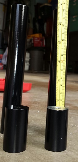

3RD Gen Diffuser
I created a new post, I didn't want to clutter up the other post about Diffuser's so I will put a link in the other threads, if peeps are interested.
I used a .050" aluminum piece powder coated black for the diffuser panel 45" wide x 30" deep (front to back).
I made some stand offs out of 3/4" aluminum, part of the mounting is from existing exhaust hole, I have no exhaust in the rear of the car to deal with so it was easier.
I used .050" aluminum angle powder coated to mount carbon fiber diffuser fins, I made the fins out of 4mm sheet, I used a carbide grit blade in a jig saw, then used a Porter Cable belt sanding unit to get it close, then smoothed the fins out with a 24” Permagrit sanding block, I did have 6 fins but it really looked cluttered so I changed it to 4, they were originally aluminum .050" but looked seriously wimpy thin.
The side winglets will be next, still thinking how they should be...
Enjoy.

Attached Thumbnails 3RD Gen Diffuser-stand-off-dims-10   3RD Gen Diffuser-front-panel-mount-dirvers   3RD Gen Diffuser-rear-panel-mount-same

Re: 3RD Gen Diffuser
Being the first one, there was some trial and error.
I had a sheet metal one made for patterns for $250, installed it drove it around, saw where it rubbed, modded it, then made a winglet template.
My biggest cost was 4mm carbon fiber sheet @$350.
I bought the tools to do this, and afetr i figured how to cut and trim the material, I saw a universal splitter on Craigslist someone was trying to unload for $150 OBO.
If there is a next time, I will buy even a used splitter and cut it up...LOL
I paid $60 to powder coat the pan and the angle pieces.
So lets add it up....
Template $250
Fiber sheet $350
Tools, blades, sanding block $75, the belt disc sander was a huge here.
Powder coat $60
Aluminum round stock $25
machine stand offs $30
$800 total, I have some stand off material left and a whole sheet of carbon fiber which i will work on the winglets and the side plates for a wing.
Could it be done cheaper, yes, after the learning curve.
the 30 x 45 piece fit so nice it was the nicest fitment i've ever had.
