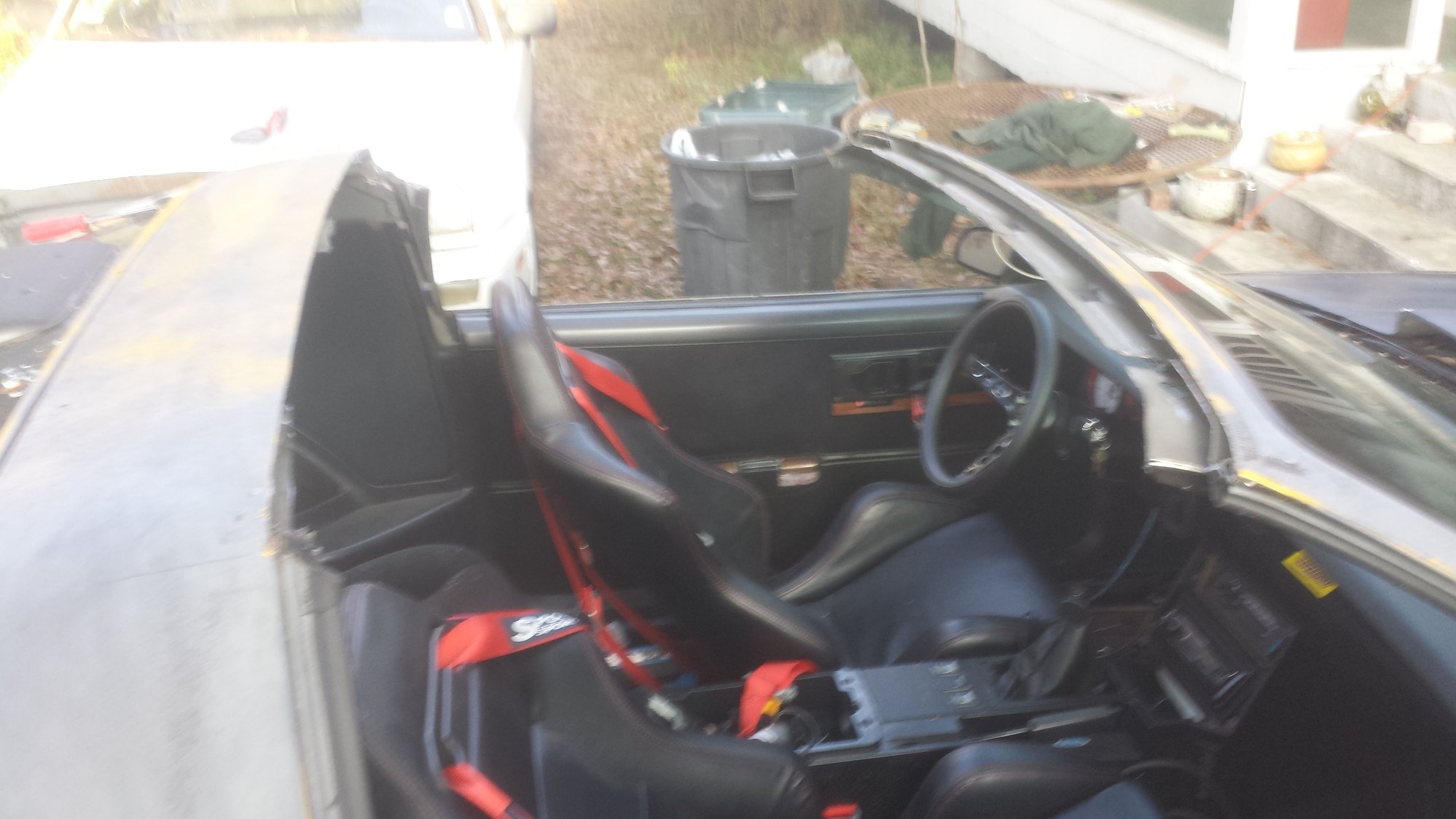

This is my targa top build. Making a soft top that will slide open and closed. This is the start.

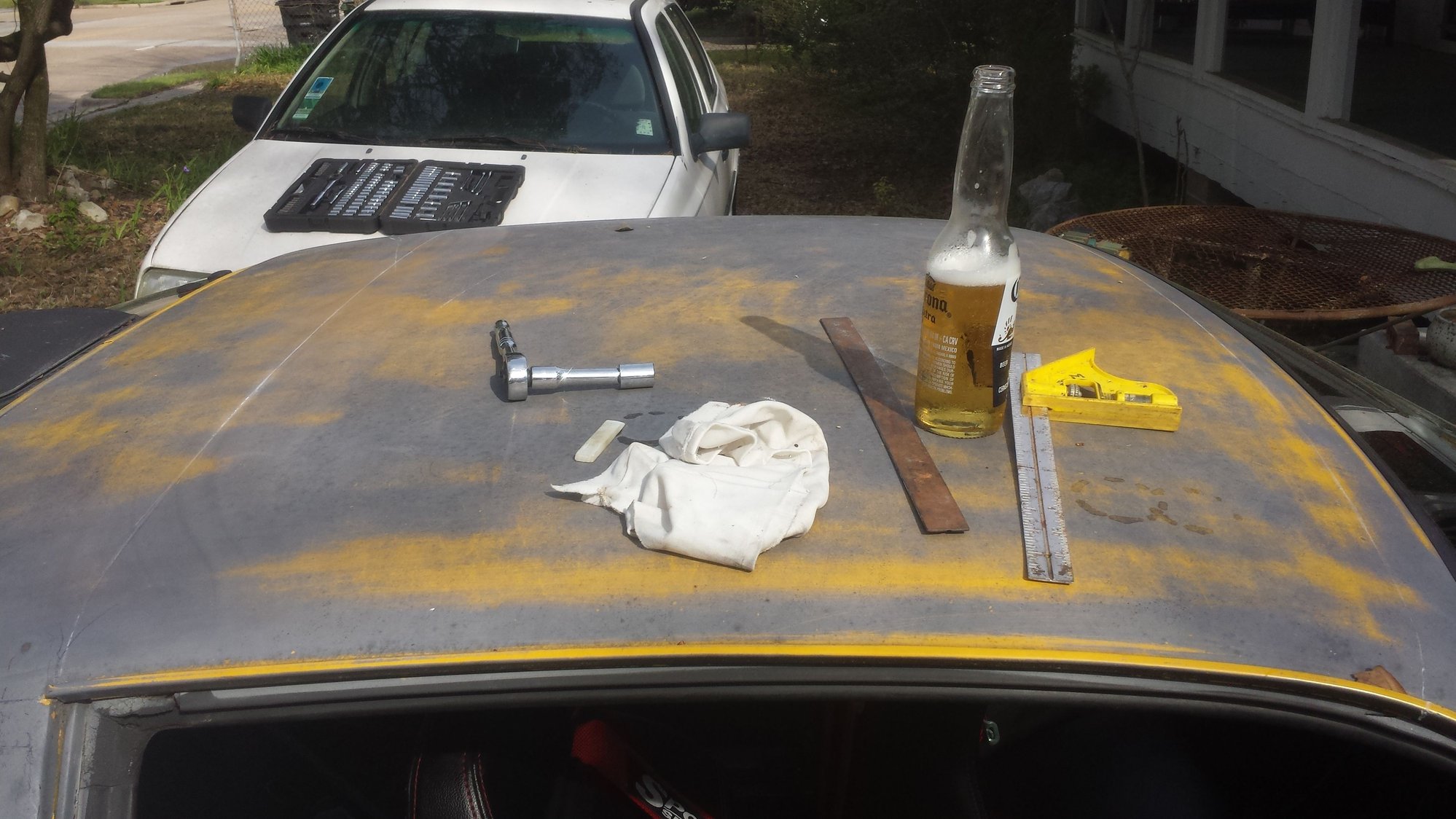

The layout

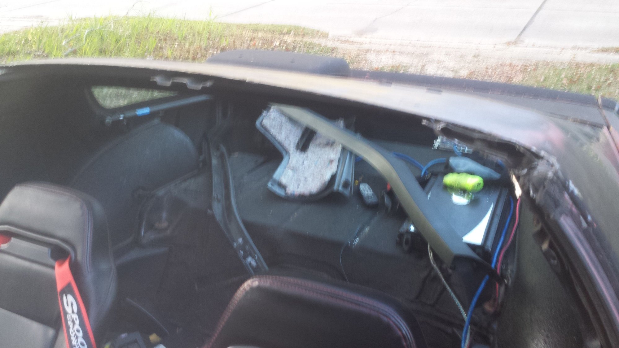

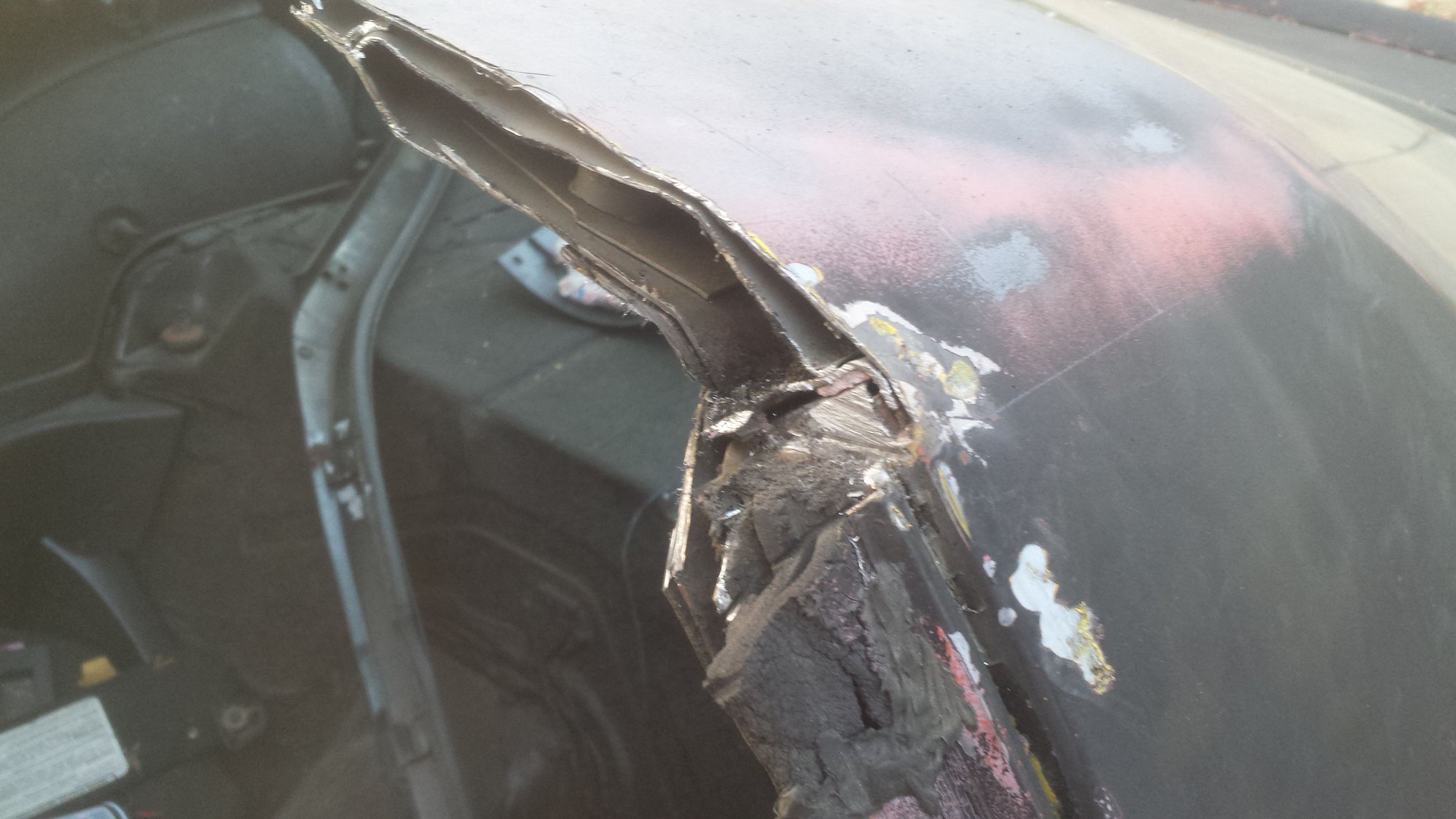

After cut. Used a 4" grinder with a cut off wheel.

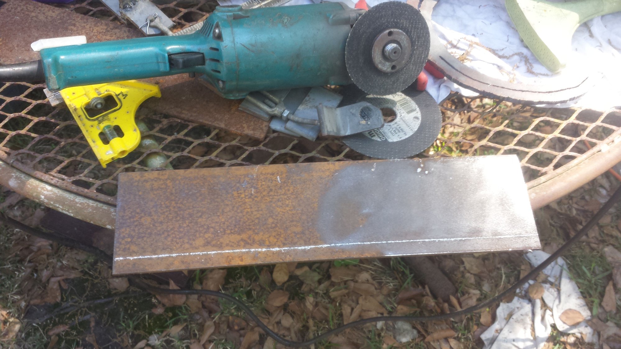

cut half inch strips of one eighth flat bar.

with the roof cut off there is no strength. Needs bracing

took my strips and locked it in with the old Bracing.

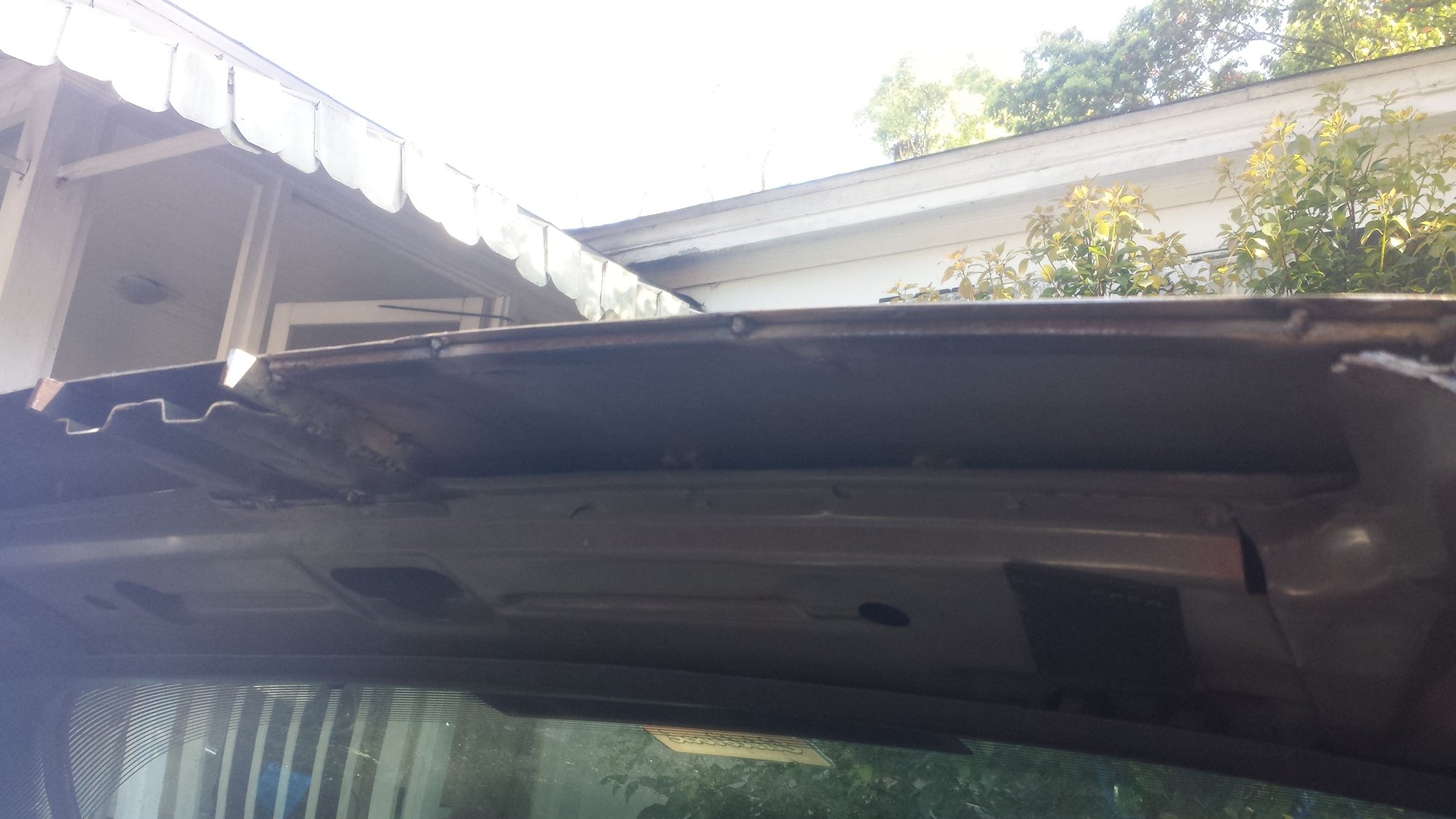

I cut it so the top could be set back in place

What did you do for securing the frame ? Did you add SFC's ?
Old Jun 6, 2015 | 02:10 PM
PurelyPMD's Avatar
Joined: Jan 2013
Posts: 3,038
Likes: 52
From: Newtown, CT
Car: 1987 IROC Original Owner
Engine: LB9
Transmission: M39 MM5
Axle/Gears: G80 G92 J65
Re: targa top.
Are you making a soft top to go in or using the panel you cut out to make a removable targa.
If you go with option 2 you could probably scavenge some t-top mechanisms to make it lock in.
A buddy of mine did this to his 69 Impala one summer about 30 years ago, there was a lot of beer involved in that one.
