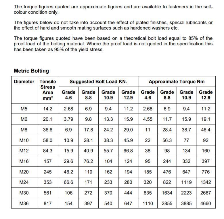

Proper torque to be applied in structural joints depends on many things. You are ultimately actually aiming for the proper bolt stretch so that the bolted joint in the end is secure. Some of the items that influence the actual torque to be applied are the bolt material grade, mating thread properties, applied lubricant, etc. An example of how torque value would change for a given joint would be if the nut factor was designed with a "dry" bolt application in mind (ie only the bolt as received finish and you apply anti seize to it. It is easy to imagine how the coefficient of friction has now dramatically changed and the torque required to get the proper bolt stretch in the same joint will be much less in the anti-seize applied example versus the dry application. This is one reason why many critical engine fasteners now utilize a torque angle method or in the case of ARP they dictate their nut factor by supplying the lubricant to be utilized in fastening the joint with their bolt or stud/nuts
In smaller fasteners and low grade applications, typically the torques are low enough that everyone gets away with some amount of over torquing. An M12 isn't exactly a large bolt, but you can see by even material properties below for a dry joint has a wide range of typical torques depending on joint design based on fastener material properties. You can see if the bolt is an 8.8 the recommendation is around 100 Nm vs a grade 12.9 at 160 Nm.... again depends on the bolt, lubricant, mating fastener properties, etc what is the proper design. Did GM change bolt grades during the years???? Also on these bolts would be very careful on lubricant application to avoid breakage
