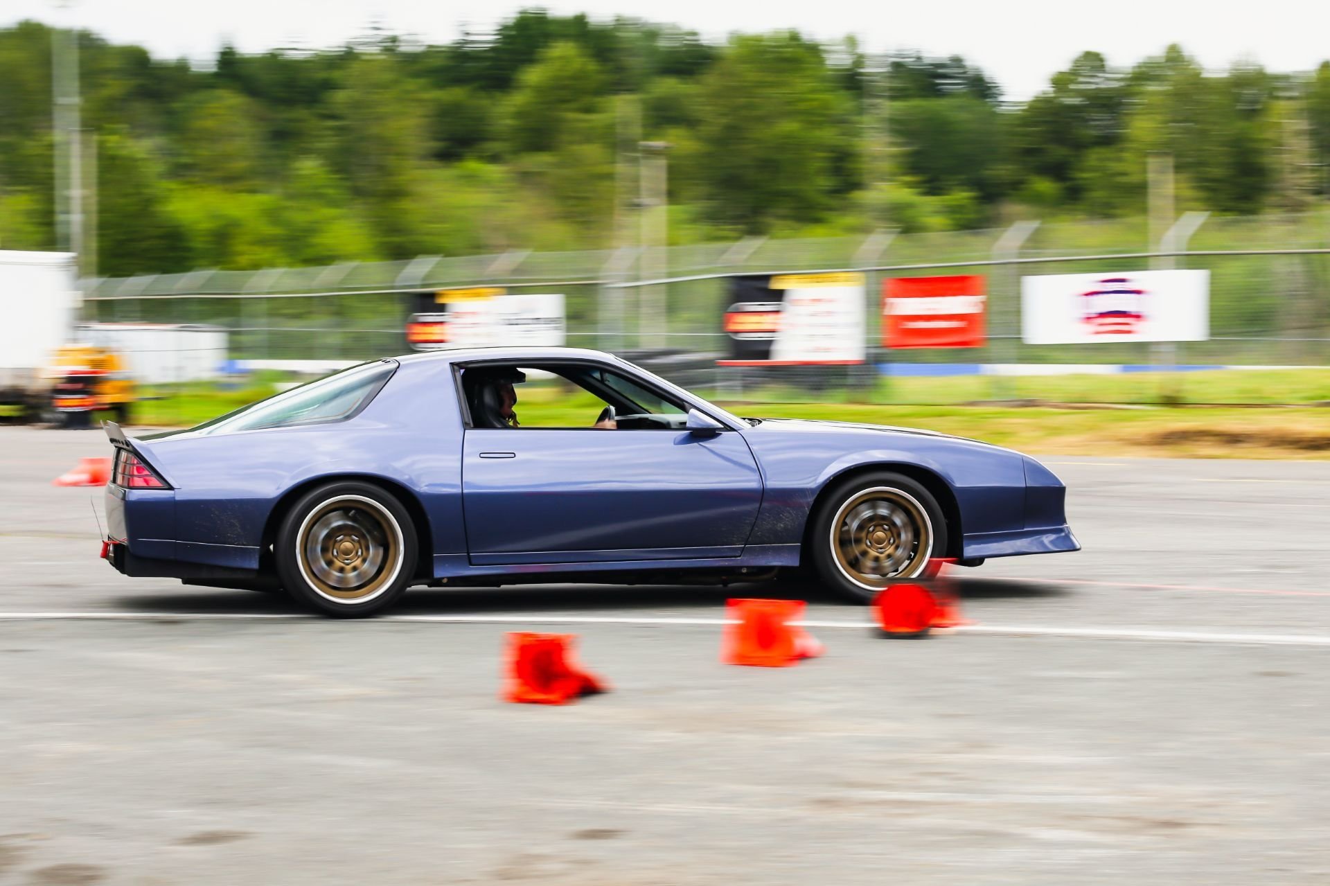

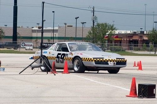

Our ~85 Firebird built for SCCA C Prepared class autocross had to have weight added, about 300#, to make minimum weight of 2750 with the cast iron 305 and TH350, 9-bolt diff. Gutted interior, 8-point roll cage, Kirkey seats, gutted steel door panels, Lexan windshield and back glass, and fiberglass asphalt car pin-on hood. This is it when it was at that weight:
We've since built a 5.0 L LS1 and added a 9" diff with aluminum pumpkin. We've also swapped the rear deck panel to fiberglass, as are the front fenders and hinged fiberglass hood now. Sadly, I haven't weighed it since. Really need to.

That's a nice looking Firebird. Where did you get your lexan backglass and does it attach like the original one does? What kind and size are those wheels and tires?
The Lexan in that picture was from the original build, and we weren't part of that. We did replace the front and back glass with Optic Armor pieces, and they're held up very well. They're not cheap, but are really quality pieces, and the price per year has been good. :-). We got the drop-in units, since they required the least amount of modification to install. The fronts are set in factory-style butyl and secured with screws.
The rear window is hinged, using the factory hinges at the top, and at the bottom it's sort of pinned between the rear deck piece and a piece of 1/4" square bar material that's welded to the rear fenders. The 'wing' portion of the rear window is held in place with Dzus fasteners on each side.
The car was originally a 'CP-lite' car, in that if you ran a 5L engine and 10" wide wheels, you had a 2700# minimum weight, vs. taking a weight penalty for 10+" wide wheels and any engine over 5L. So it's running Real Custom Wheels 10"x16" wheels with 10"x16" Hoosier slicks. When the SCCA eliminated the weight penalty for bigger wheels, we went with 12" front and 13" rear wheels and similar sized slicks. There was a wheel diameter penalty then, but that's now been eliminated so we're now running 12" Forgestar 18" wheels and 335-18 Hoosier A7's on all 4 corners. While it's a heavier wheel/tire combination, it does put more tire on the ground, especially in front, and allows us to tuck the wheel/tire package further under the wheel wells, making the car 'narrower'.
Real Wheels is no longer in business, sadly, or we'd have gone to them to see if they could build us 18" replicas of what we have in the 10X16 size. Those are really nice-looking wheels.
