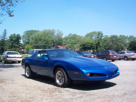

OK heres a pictoral of the major differences hope this helps
82-84 bird and S/e
https://www.thirdgen.org/rides/rideimages/home01.jpg
82-84 t/a
https://www.thirdgen.org/rides/rideimages/modnosat.jpg

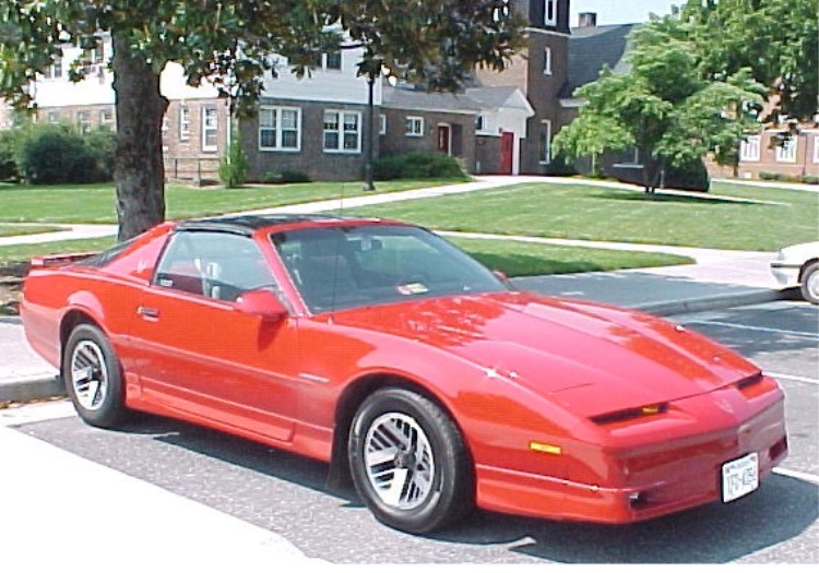

85-89 firebird base
https://www.thirdgen.org/rides/rideimages/baby2.jpg

91-92 base birds trans ams (gfx)
https://www.thirdgen.org/rides/rideimages/Mail.JPG

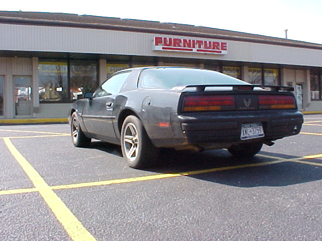

(bird) pedstal
https://www.thirdgen.org/rides/rideimages/02.jpg
(bird) aero
http://mywebpages.comcast.net/tstrel...pgta/back1.jpg

85-89 firebird base

85-89 firebird base

(bird) pedstal
(bird) aero
