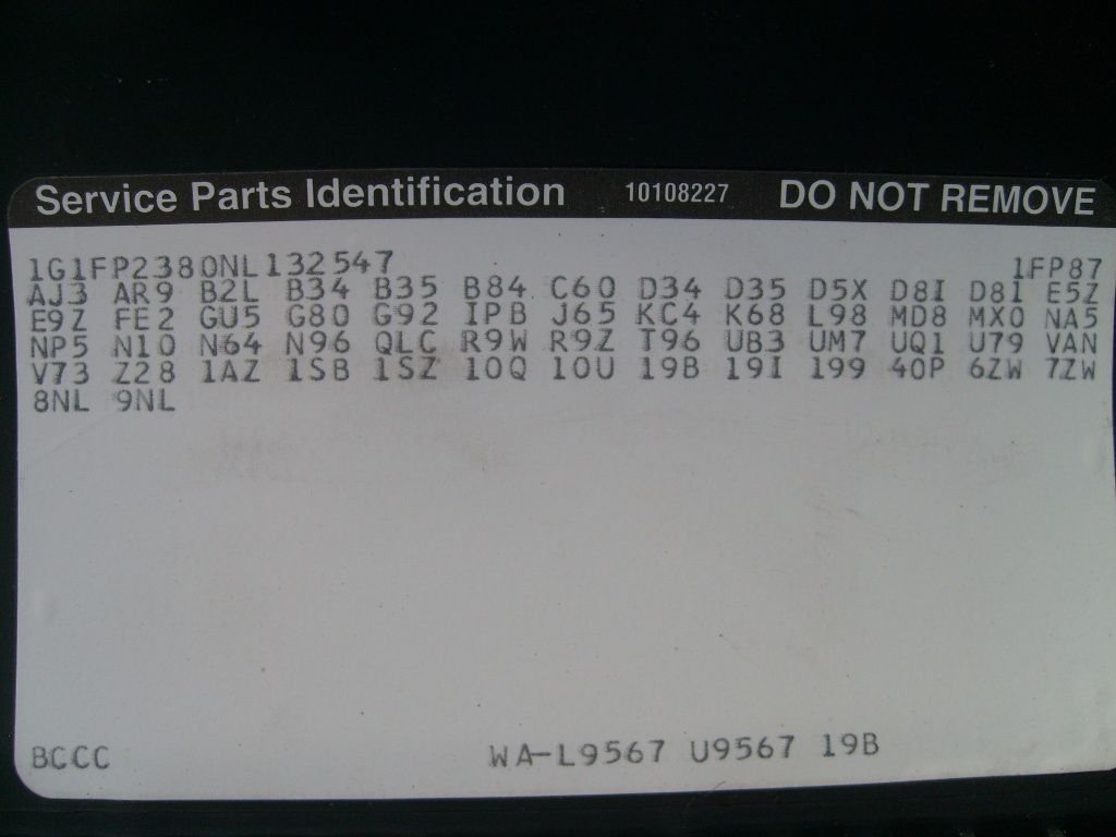

i'll get codes tomorrow....
is it in glove box?...is that all i need?

will these codes read as if is a b4c?....owner of car says it is a b4c...
i need to know b4 i purchase?...

Not a B4C. Just a regular Z28. All B4C cars should have the B4C RPO code. Also, pretty sure B4C was only available on base RS cars.

Ok. You're getting a little confused here. The 1LE was a brake package that came on cars that were ordered with the 350 engine, G92 performance rear axle and AC delete, or on a 305, 5 speed with G92 and AC delete. If the car has AC, it's not a 1LE (unless it's a B4C, see below)
G92 was a performance rear axle option. On this car, the standard gear was 2.73. With G92, it was a package of other options that also gave 3.23 rear gears. This is was what you might hear as the performance model.
B4C was a police package or government use. The B4C option was used on the RS cars, not the Z28s. Can you say sleeper? This was the only way to get a 350 in the RS. If I remember correctly, all '92 B4C equipped RSs also had the performance brakes (1LE).
Yes, that is correct. in 1992 all of the B4C's got the 1LE brakes, in 1991, only 13 of them did.
The car above is NOT a 1LE or a B4C but it is a nicely equipped L98 Z28.
