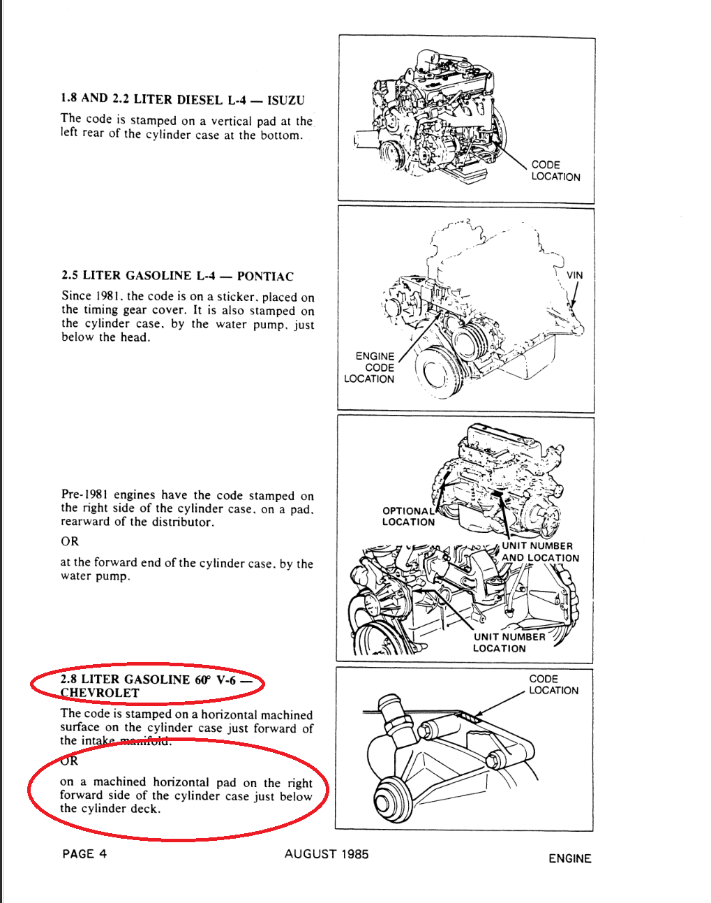

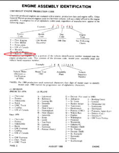

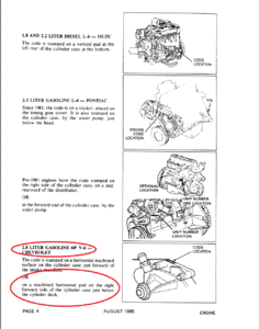

Thank you for your assistance. I think I have finally solved my puzzle. I stumbled across something in the GMheritage documents which I think is a treasure chest of information. If it isn't posted elswhere on this website as a sticky, it certainly should be as it lists just about every specification, code, option, and configuration available from dealers on camaros. It can be found here: https://www.gmheritagecenter.com/doc...let-Camaro.pdf
To get your particular year model, you can simply edit the text in your web browser to the correct year. Interesting, some pages are out of order and some are used more than one year but just keep scrolling down for the information desired.
So here is what I come up with:

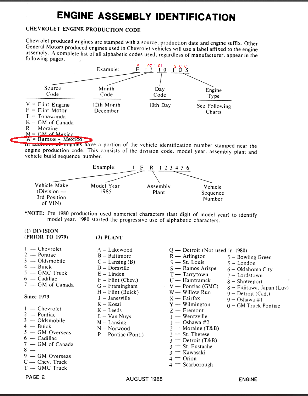

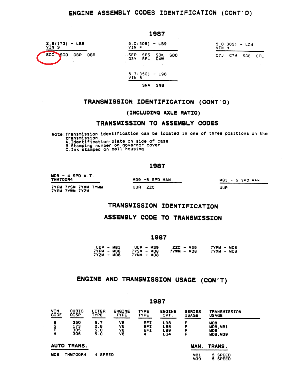

A070127SCC is a 2.8L V6 produced in Ramos Mexico on July1, for a 1987 Camaro. I am not sure what the "27" indicates. It is the engine that I have as a spare. I will look deeeper tonight for casting numbers, and a partial vin but at least I know it is out of a camaro and is the right year.
I think I may have transposed some numbers and letters on the block that is in it from CFA ("88 2.8L) to CAF (?) Will verify tonight.
Here is where to find Engine ID info on V6 2.8L engines per GM documentation and how I came up with it.
Attached Thumbnails Anything special about this? Help me decode S/N-engine-code3.png   Anything special about this? Help me decode S/N-engine-code2.png   Anything special about this? Help me decode S/N-engine-code1.png
