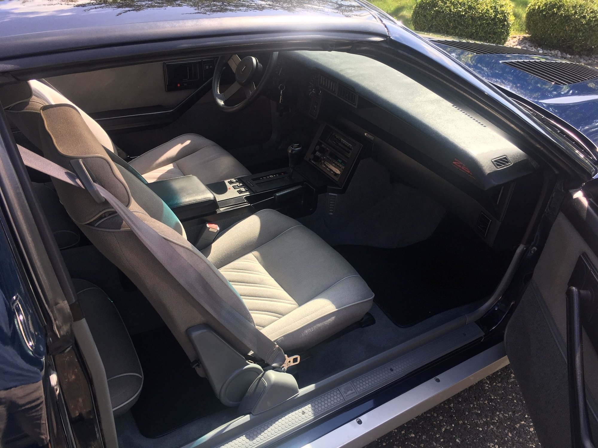

Old Sep 15, 2021 | 08:04 AM
stron3's Avatar
Joined: Apr 2004
Posts: 122
Likes: 34
From: New Jersey
Car: 87 Camaro Z28
Re: 87 Auto Shifter **** Question
What color Paint is your Car?
It looks like the Color that my 87 was originally (Black Sapphire Metallic).
Yes, Black Sapphire Metallic. Here's a link to my post about the car with some pictures if you're interested!
Thanks!
The Car looks great!
