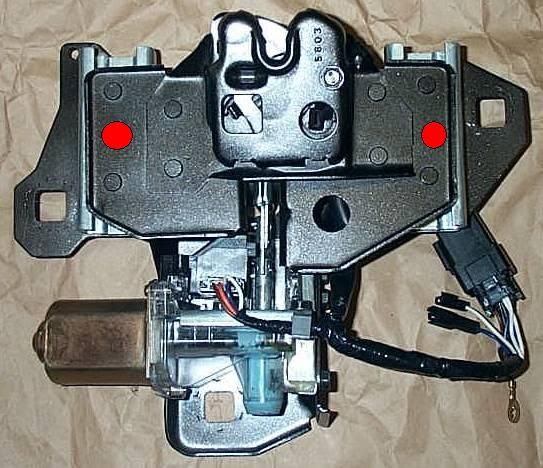

In haste, I've made a pull down model stationary (hey, I was young and broke). Its perminent, so kinda no going back. Get yourself a couple of decent size bolts and a drill. With someone holding the decklid in place, drill through where I put the red dots (borrowed photo from TDS):
if you make the holes slightly larger than the bolts, you can make a little adjustments if the hatch is not completely flush.

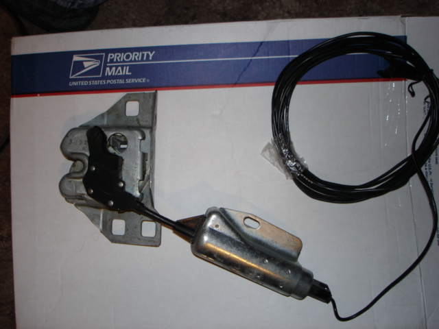

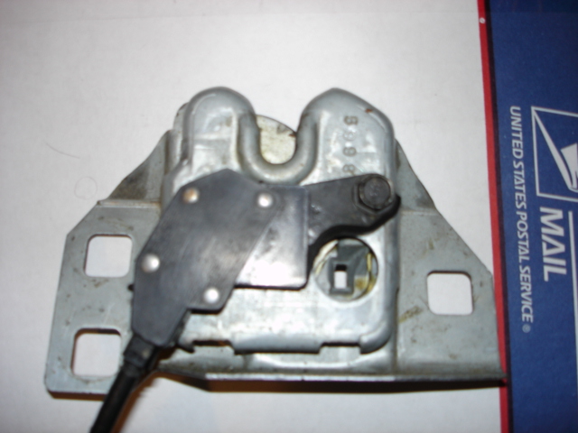

1ADan can you still use the release button on the console when you do this?
Also here is what a non pull down latch looks like. This was on 82-85 camaros and firebirds.
Attached Thumbnails hatch pull down converision-dsc00205.jpg   hatch pull down converision-dsc00204.jpg

i've never had a car equipped with the remote pop, so not entirely sure, but i dont see why not. the bolts are only going through the slider section of the bracket, it shouldn't have any affect on the latching/unlatching aspect of the assembly.
