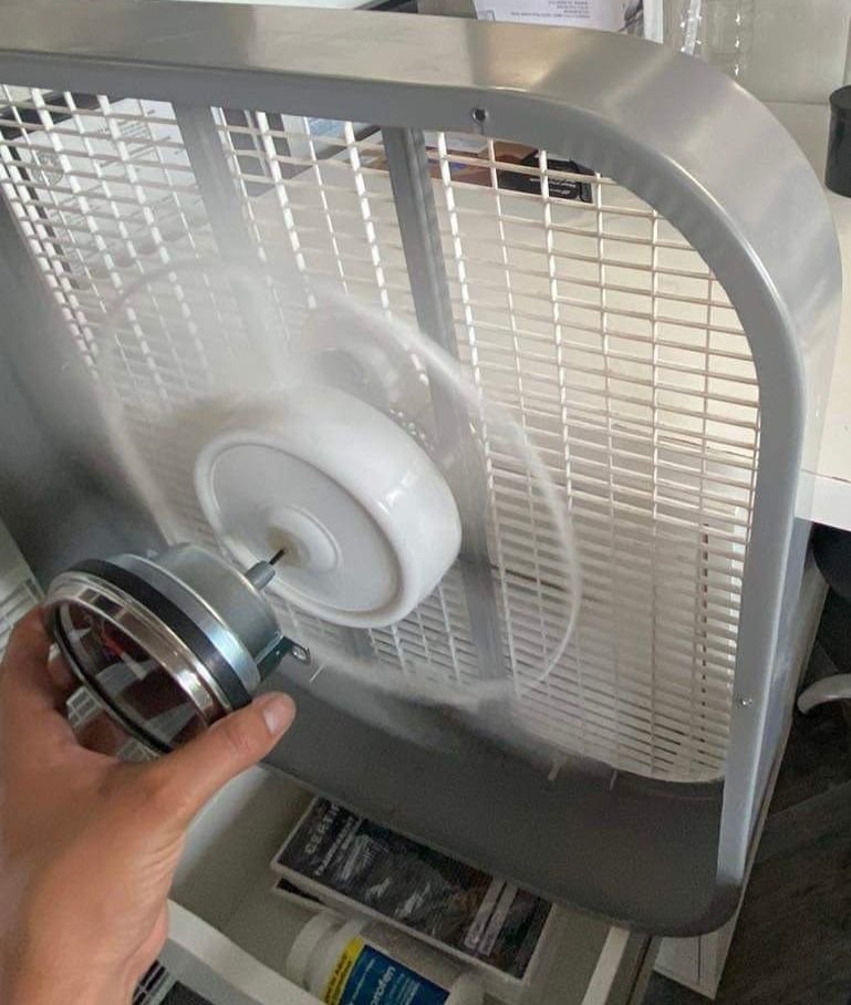

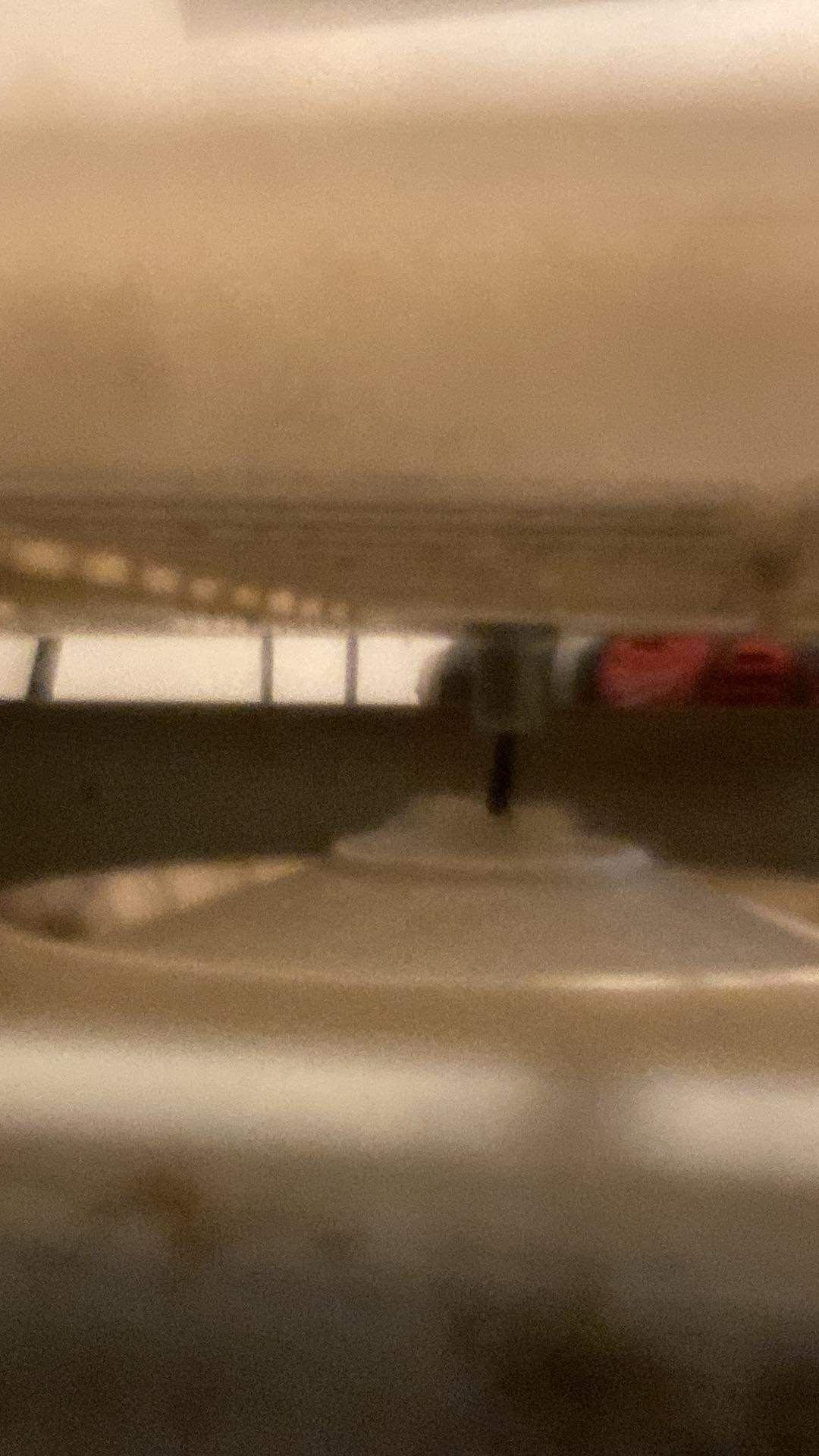

With a drill it will be a headache get a square house fan take the protective plastic mesh off put something that will fit in you speedometer to make it turn I used the cap leg of a sharpie marker I super glued it standing up right in the middle of the fan then I placed the speedometer in top of the plastic mesh and inserted the sharpie cap leg into the speedometer I ducked taped it on the sides to secure shaking then I laid the fan facing up with a breathable pedestal (some pieces or house brick) and turned the fan on it makes my speedometer go about 30 mph in one whole day of letting it run at home it has put about 450 miles I need 21k miles so I got a ways to go
