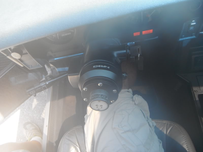

Re: NRG Quick Release Steering Kit...usable on third gens somehow?
i have the NRG kit installed on my car ,, it is an wicked kit.. extremely well made, retains the horn..
so how did the install go ,, you happy with it??

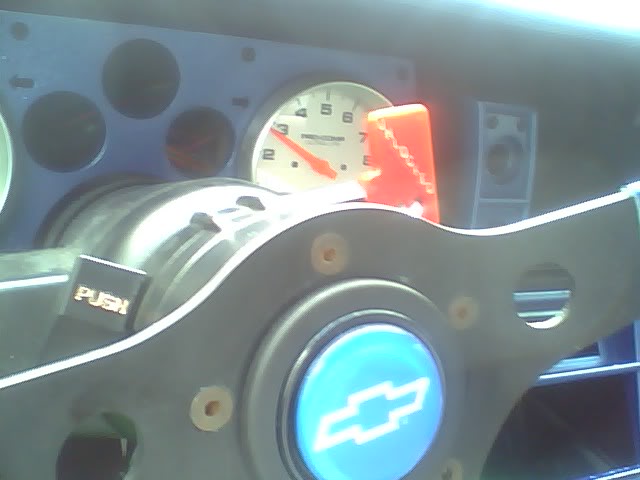

Im running the samething as project-rs
What year was that installed on? Any modification of the column or the kit necessary?
its on a stock 82 to 89 tilt column and there was no modding at all that I did. actually i had to make the horn button work is all took 2 min and 10min to get the quick release on
finally..installed pics
Holy Moly! Sure glad I saw that side view pic before purchasing one. It really appears to move the steering wheel forward. Can you still use the turn signal lever with your hand on the wheel still? The Grant setup doesn't appear to move the wheel out nearly as much.
nope..gotta take my hand off..it does move the wheel closer..the hub pushes it closer to the driver but for me it didnt really change much..only like 2 maybe 3 inches
2-3" is huge. That totally changes the way the car fits you.
NRG offers a slim disconnect and you can combine that with a flat steering wheel instead of the high offset wheel that itsMikey has chosen and the difference would be minimal.
mine is the slim but yeah i got a deeper wheel..the wheel alone has a 2" outward push..so it probably only moves it maybe an inch or so with a flat..
its probably less than im estimating but it didnt really change the way the car feels in the way youre implying but it did give me the feel that i have more control over the car as this wheel is a tad smaller..
