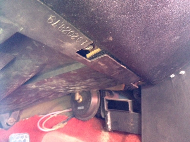

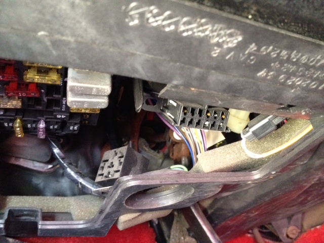

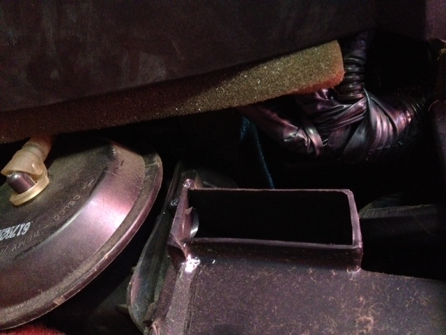

Here are the pictures, in the one, i just took off the fuse cover, the heat is felt even with it on. As for turning it on max and driving, wouldn't the heat produced by the heater be felt? Then i couldn't really tell if the heat from the engine area is coming in. I really don't think it's a problem with my heater, only because when i'm stopped nothing is felt
Attached Thumbnails Insulation?-adsf.jpeg   Insulation?-d.jpeg   Insulation?-image.jpeg

I know this isn't related...but what hold the lower fuse panel piece to the upper piece? Referring the the last picture you posted. I don't have anything that holds it up. What originally was supposed to hold it up?

Originally Posted by 80schild
When set to MAX, the air inside should recirculate, and no outside air should come in. If air still comes through the heater vents with it set on MAX, then you've got some sort of vacuum problem.
As for the temp of the air, with the engine fully warmed, turn on your heater, then slide the temp lever from cold to hot. Do you feel any change? This will tell you if the cable is connected to the door in the heater box.
This is to help eliminate heater problems common to these cars.
This is exactly why you might want to refer to the above and check the heater and ac controls and functions correctly. It sounds like the air is coming into the heater from outside and blowing with the force of your speed though the air ducts. This can and does make for a very hot drive in the summer. If after checking it closely if this isn't it then we will try to figure out something else.
I understand how you feel but it costs nothing to carefully check it out yourself and you would feel foolish saying it can not be and bring it in someplace and they tell you the same. Ask how I know. I did not want to believe some of what I was told and now later I have had to admit I was wrong (eat crow) so I try to listen more and not let my preconcieved thoughts interfere with proper troubleshooting.
