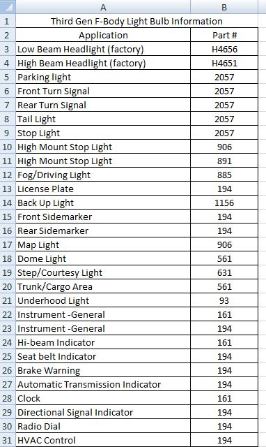

Interior LED lights where to get em??-third-gen-f-bodyThird Gen F-Body Light Bulb Information.pdf
I have bought all of my LEDs off of eBay (approx 80% from China) and have only been disappointed with two sets (which I'll explain in a minute). All of my bulbs with exception to the headlights have been converted over to LED (tail light assemblies have custom made LED arrays in them, not the 'plug & play' style replacements). Check these ones out.

1. Stay away from the led bulb type LEDs for 194/161 replacements [Bad Style 1]. The are not as bright as the "SMD" (surface mount diode) nor do they have a decent spread pattern.
2. Also, I would stay away from the 2057/1157 style LED replacements [Bad Style 2]; I originally ordered these types for the tail lamps (1 set eBay seller from China, 1 set was from SuperBrightLeds.com). Both sets didn't change much (light output wise) when you stepped on the brakes (and yes, both were dual contact LED replacements for brake lights) and the bayonet bases didn't fare too well. The solder on both sets didn't hold up very well when I attempted to install them (due to the push and twist needed for bayonet bases).
Bad Style 1
Bad Style 2
Lets face it, LEDs pretty much beat the crap out of regular incandescents. There is basically no heat (until you start getting into your 1 - 100 watt leds), amperage draw on one of the eBay style 1 type 'bulbs' is only around 60 mA, output light color is awesome and they have a life expectancy of around 40,000 hours (or 4.5 years of constant use). Definitely worth the change; providing you don't get the crappy ones made by a 10 yr old in Bangladesh.
