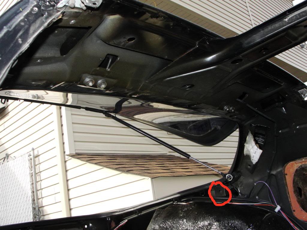

There is a sheetmetal mount in cars equipped with that option. I included a pic of my car for reference. I am not sure it is there in cars without it. If not, you would have to fab something or get those from a parted out car.

Those metal brackets would need to be cut off a doner car and attached to your car. They are spot-welded, I pop-riveted them to mine. I measured the location before removing from the doner car. The tricky part was matching them up with the location of the hole that you'll need to cut in the plastic trim panel. There is a molded indentation on the backside of the plastic panel that you'll trim out. There is also a metal reinforcing piece on the plastic trim panel on the underside of the hatch that the two "T" shaped pieces on the privacy screen hook into. You can either grab the panel from a doner car or convert yours by adding the metal reinforcing piece and cutting out the slots (that is the route I chose).
