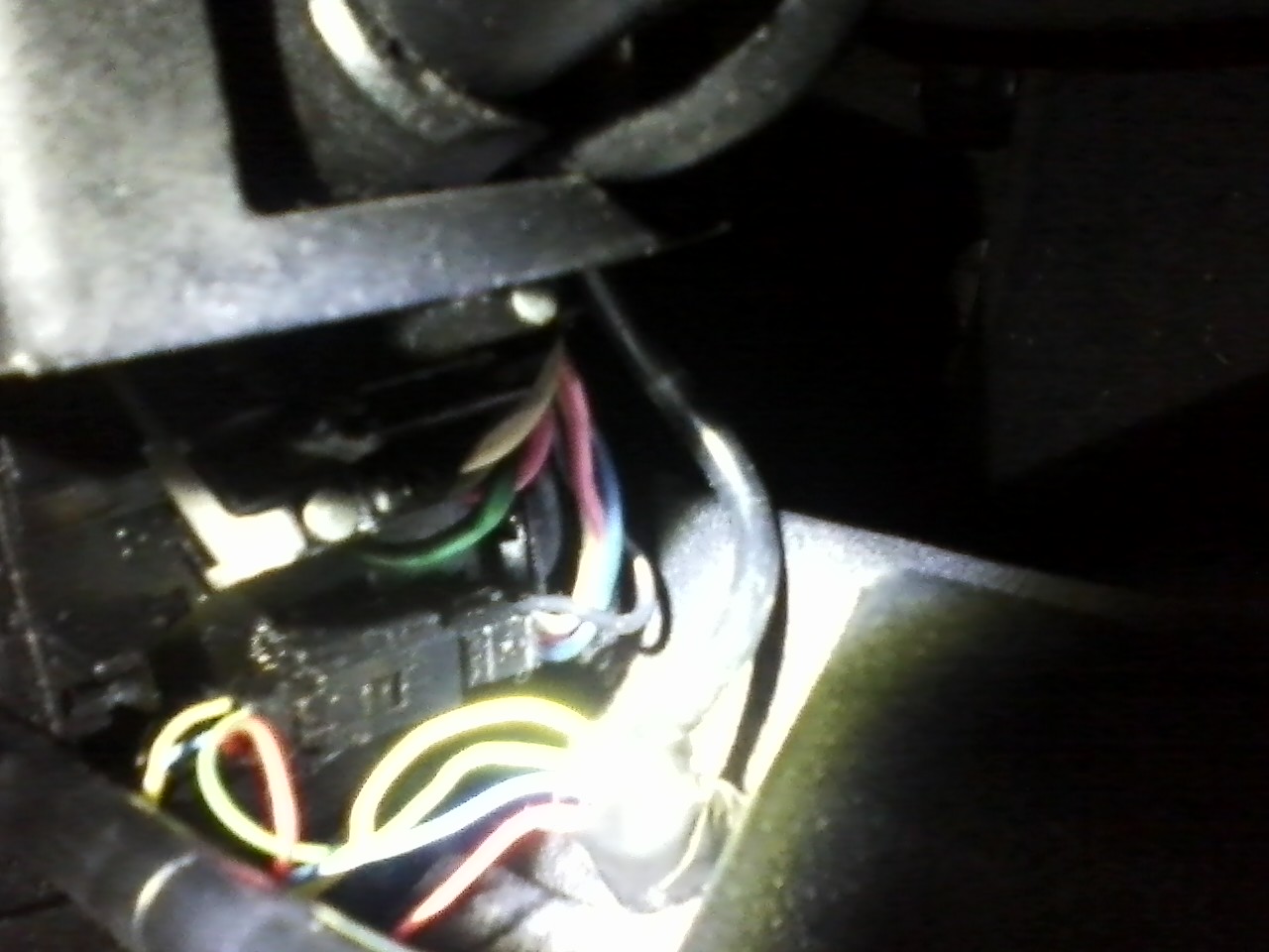

wiper problems, help!-0221142108a.jpgcoming out of the switch or "stalk" there is 4 wires that go to a small connector mounted on the steering column. The wires are yellow, green, blue and red. Does anybody know what each of these wires do? Also out on the firewall going into the washer motor are 6 wires, pink, red, blue, grey, yellow and green. What do each of these wires do? I checked and the switch is over $120 and I don't have it to spend. I need to rig a simple way to get these going until I can come up with the cash to replace it. If I knew what each of these wires did I probably could rig up a simple toggle switch to just get the wipers to come on for now.

Did you pull that connector apart & check if the pins are good? The stalk is the switch, but there is a harness that runs down the column & unplugs under the dash.That looks like it, but its too fuzzy to tell.Id check that connection & work downwards.
