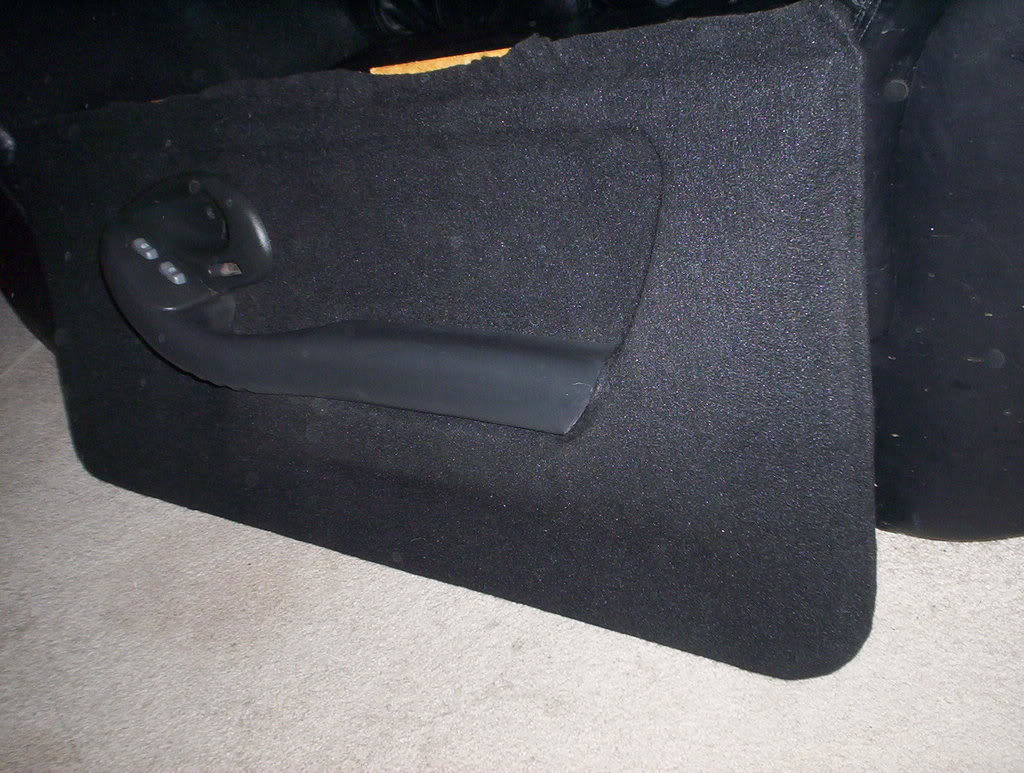

Personally unless you're doing the dash as well, I think the 4th Gen door panels look out of place. But I'm thinking if you really don't want to mold anything then you could prolly make a flat black panel, leave the trim and all off and then put the 4th gen on top of that.
So something like what I made, but leave the plastics off and put the other panel on top of it, anywhere the 4th panel doesn't cover the door completely would still blend in i would think.

I went through a few trials years back
Biggest problem was figuring a way to make a cap for the rear of the 4thgen armrest just with the way the inner frame of the armrest is hollowed out. I ended up selling the car so the project stopped at this, which was very presentable in person but not what I had in mind 100%
