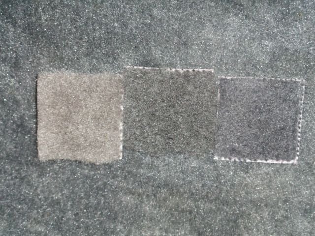

Stock Interiors Ultra-Plush carpet samples. Left= Silver (1053) Mid= Grey (1066) Right= Med. Grey (1068)
I have the stock grey interior in my 91 Firebird and ordered all the grey Ultra-Plush carpet samples from them. None of them were an exact match. The closest one is Grey (1066). I'm not sure about the Med. Grey sample, it just seems way too dark for med. grey. Maybe they had a mix up and sent charcoal instead?? It looks like you have more color choices on the regular pile cut samples. I would order both sets and see what you get.
I know I wish we had a little better on the colors to matching wise. Although even if u compare stock cars to stock cars(low mileage examples) there is a decent variance. Looks like splitting it in the middle is probably best aka med grey/dove grey.
Appreciate the pictures.

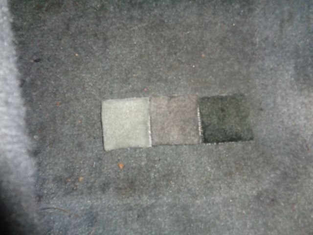

I recieved the grey plush cut pile carpet samples today from Stockinteriors. These are much closer to the original carpet color. I removed the drivers side rear seat to get the best original carpet sample I could. Hopefully this helps someone in the future needing new carpet.
Stockinteriors plush cut pile carpet samples From Left to Right: 8075, 8078, 8019
I took several other pictures at different locations ( floor board, tranny tunnel, etc) and it seems like 8019 is the best overall match.
Good luck on your carpet swap.
